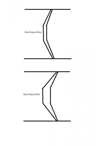

I got thicker wheel centers (high disc) in front for big brake clearance and thin center rear (low disc). That's why the lips are different sizes and the offset/back space/specs are the same. I did this for maximum rear lip and therefore rear wheels doesn't fit in front. Beauty of 3 pc custom wheels! See quick paint drawn visualization: The tires are new for this season;) I have driven on this setup, no rubbing issues. I can easily fit my hand between the tire and fender when the car is parked. The geometry of the Z's suspension makes the camber even more negative when loaded making room for suspension travel. My complete setup: 77 280z w/ 240z styling CCW Classic 16x9.5 et -10 225/45-16 (stretched) Bolt-in camber plates (biscuit type), maxed out negative at all 4 corners. Don't fear the camber! Arizona Z Car coilovers Arizona Z Car rear LCA's Rolled fender lips (SIlver Mine Motors BBK f/r) Flush up front, a little poke in the rear (3mm). It takes some work to have it fit, altough nothing impossible. This isn't a performance setup, more show than go, although it's still usable on good roads.
