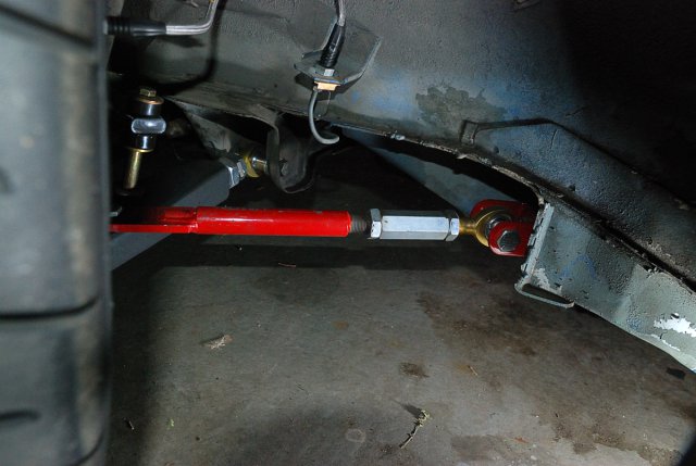

It looks like I have about 15 threads exposed. The Tc rods control the amount of caster wich controls the ability to return to center and initial turn in. I have mine set at 3.3 degrees. Any more and I would contact the lower front body panel. If you are able to get more do so. John C has a recomendation on suspension settings sticky. Don't just adjust it on your own...take it to a shop that can do accurately. If you change them it will change everything else like toe, camber, etc. Also they should be exactly the sames settings. It made a huge improvement in front end bite for me.
