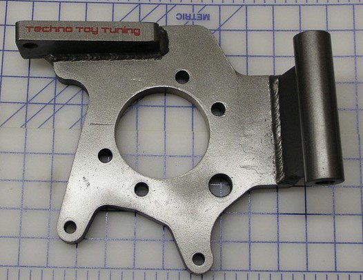

  9. Yeah for the e-brake set up you use the stock Z32 backing plate, but to mount the hubs and evrything elce you need the T3 "backing plate" so this set up can mount to the stock LCA. you cant just use the T3 backing plate alone.

  11. If you use the T3 backing plate you will also need to use there strut tube as well, what axles do you plan on useing?

  21. http://technotoytuning.com/productdetail.php?p=863 (Backing Plates $550) Sorry typo, Ebrake set up is off a N/A Z32
