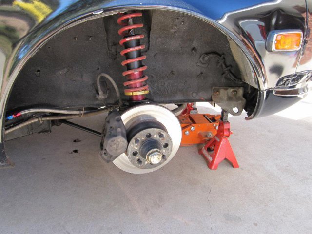

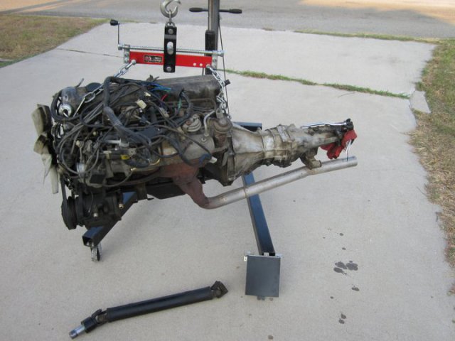

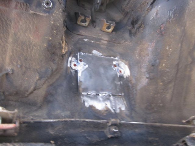

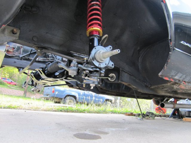

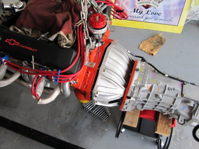

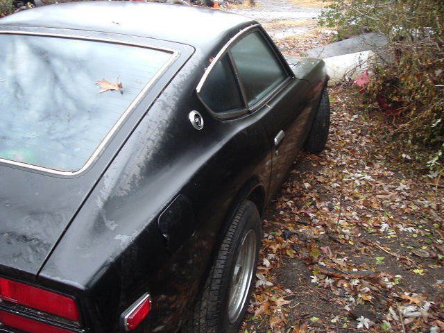

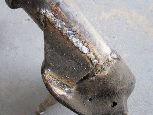

Ok so here it goes this is my build thread and questions dont hesitate to ask. The Ebay pics keep in mind add said "totaly rust free" Towing her home First thing was getting the Old L6 running did some interior work and got a cusom batt tray desined buy yours truely Installed MSD on the L6 worked great mmmmmmmmm Starting the transplant first off out with the old Sold this lot for 300 bucks on CL Time to tacle the front suspention Adding braceing to the strut tubes sweet welds i know Parts back from powder coat Front Suspention all together Time to put together the SBC And marry tranny Test fit 1 Whent to drill holes for the tranny mount and drill whent throught floor so much for "rust free" Time for new floor pan Couldent help it Side by side Fabing tranny mount What happens when your in a hurry Clutterd gradge back in for real this time Got driveshaft in 300 bucks what a joke Welding in frame rail support 1'' square tubeing Getting ready to plum fuel system and exhaust Time for rear end upgrade Getting the P-brake to work Rear end done Now moving to the front MM front cobra hubs with M2300X brembo kit off 00 Cobra R Car to date Bought new motor on racing junk will have to wait till i get back.
