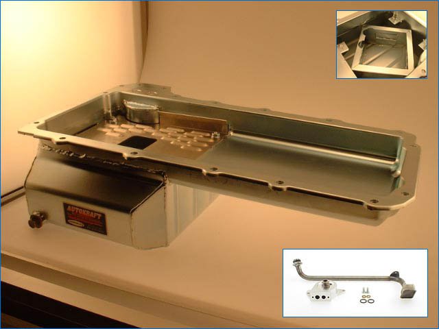

  4. Yep, no point in having a good motor if it won't hold together. Presently thinking is a crate L76 with a Comp or Camtech cam, springs, etc and MoTec management should be the go. Just realised that those fabricated sumps like the Autokraft above do not bolt to the transmission so reducing the overall strength of the engine and transmission as a unit

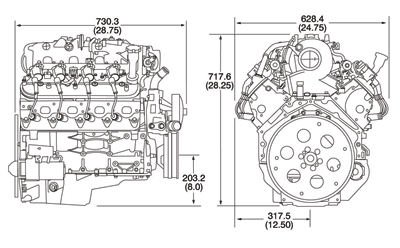

  7. For anyone else wondering about this, here are some dimensions of a LS truck engine which incidentially is only ~10mm deeper from crank center line to bottom of the sump/oil pan than my VG engine fitted with a VG30DETT sump/oil pan is.

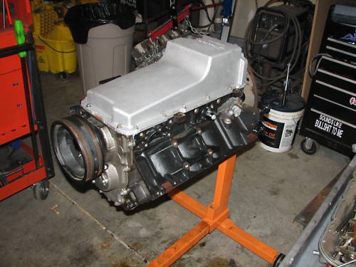

  8. I would not trust a stock sump/pan for circuit racing/road course use, will hook up an Accusump as well to make extra sure. Yeh I could make a windage tray, have done that before.
  9. Thanks B from O, that is helpful and makes me wonder if that OE windage tray will fit in the Autokraft sump/pan.

  11. Yes those are the pics I have referred to, very useful. Need to get the total engine height down from 27.5" to ~26" max, preferably a bit less, so perhaps a well baffled steel aftermarket pan. Something like a Autokraft.
  12. Looking at putting a crate LS2 with a modified 4L60E auto trans into a RHD S130. From available measurements the LS is about the same length as the present VG30DET and a touch narrower. Crank centerline height measurements are a bit harder to find, they are important because they dictate how low the LS can be mounted while still clearing the Xmember and steering rack at the front. Does anyone know how far the LS block extends down past the crank centerline? This together with oil pan measurements will help me work out the engine mounting height. Also relevant is whats available in the way of low profile oil pans baffled for road course racing use, remote mounting of the oil filter is OK. I have done some research but advice based on personal experience is always useful.
