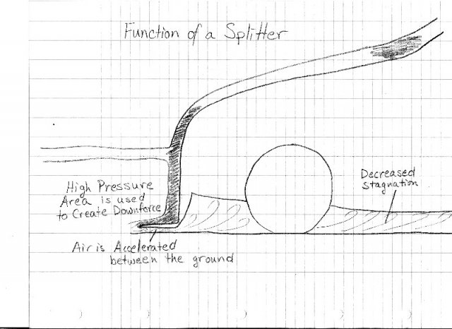

I understand how a diffuser works, the final drawing concerns the rear of a car where air flows out the back. If it couldn't the diffuser would not work. With a diffuser under the front of and in the middle of the car the air has no clear exit path like it does at the back, which is why I'm wondering how your undertray section works, the splitter part looks fine. Can't find any VR SC info on the www, did you personally see one and copy it to make yours? I'm just trying to square aero principles with your design to satisfy myself that it should do whats required if I use the concept to make one for my Z.
23zed, the sketch below, taken from the link I posted, appears to recommend a high front, low rear floor. It may be just the way he has done the sketch but I think he is illustrating a narrowing volume for the air as it moves rearwards. Which would speed up the air and lower its pressure. If that is right yours would still work but the effect would be limited to the area where the air comes under the splitter in a high speed/low pressure state.
Good to see some more posts on this topic, my car has developed a high speed understeer problem so I've been looking for some aero answers. Perhaps some dive plates on the front but they do not look like they would do much. This linked site has some basic aero info http://www.superhachi.com/theory/downforce/ For those who trailer their race cars and are worried about low front clearance, I have seen removeable splitters/air dams used. They can eg slide on to a couple of solid pin mounts and be retained with a few Dzus fasteners. 23zed, whats the theory behind your recessed undertray design? I'm thinking of doing something like that but with the recess immediately behind the splitter. Am not sure which way the floor should slope though. I was thinking from high at the front to low at the back but yours is the other way around.

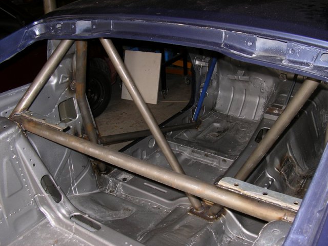

Here is a S130 half cage, designed to be suitable for street use, no head high bars to beat your brains out in a crash. The only parts forward of the hoop are the two low side bars that angle down to the bottom of the floor just behind the A pillar. Car has been in use for a while now, no problems.
