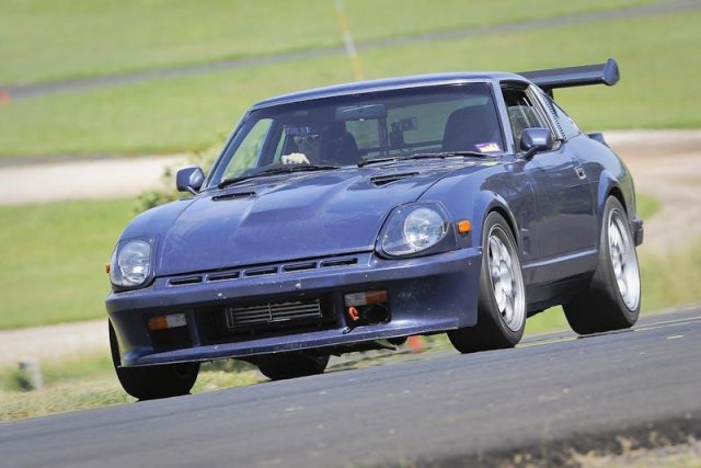

One of the blokes who is pretty quick around the circuit has said if it handles at that particular corner it won't handle anywhere else Yeh Frank I think I know what you mean by 'planting' and thats probably the answer. Anyway pics may help, its a 180 degree right turn, in the pic below the car has reached about 100 degrees @ 90 KPH. In the linked video the corner entry commences at 0:51 The suspension is set up a little different in the video so ignore that. -

Situation is the hybrid Z tends towards understeer, particularly when there is insufficient weight transfer to the front, mostly but not always when turning in. The low speed bump has been adjusted a few times, its very sensitive, too much and the tyres just lose grip completely and slide front and/or back. Take it off a few clicks and the car moves around a lot through high speed sweepers and tends to understeer badly in certain low/mid speed corners although rear end grip is then great. This is OK in some corners where the car can be driven in to the apex and the good rear grip can be used to power out of the corner. But in other corners this can't be done due to their configuration, in those corners the only way is to basically steer the car around the corner. Go too fast and the car pushes out and can only be retrieved by backing right off and even then it comes back reluctantly. The recommended settings for normal bump and rebound have not been altered at all, basically because I'm not sure which way to go with them and the car feels good otherwise. So, any suggestions?
