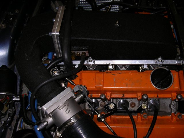

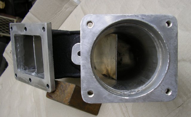

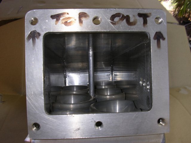

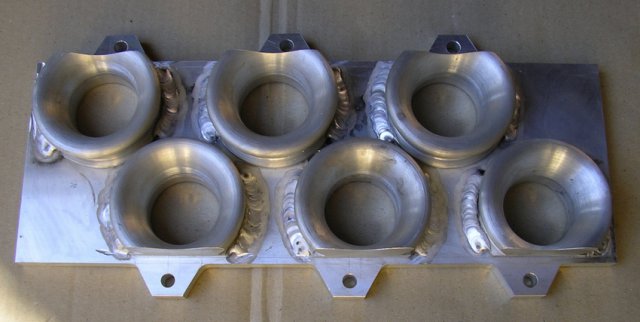

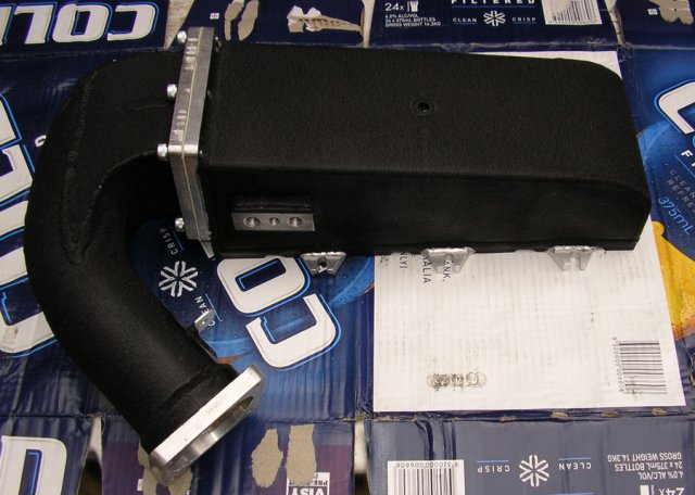

  12. Designed this with some help to overcome uneven air distribution with the previous side entry plenum. A rear entry design was chosen because it gave the most height at the entry point, important because the incoming air has to turn down to fill the cylinder intakes, the nearer the intake to the entry/the lower the plenum roof, the sharper the turn. The extra complication of using bellmouth intakes was decided on to improve flow significantly and assist even distribution, they are 30mm high off the plenum floor and have a specific shape to maximumise their efficiency. The entry into the plenum is 76 x 100mm wide and it incorporates a central turning vane for the purpose of spreading the air as it enters. Otherwise it would tend to concentrate at the outside of the intake turn and so tend to enter the plenum favouring the left side. The plenum has been fitted and the engine run up on the dyno. A plug reading indicates that each cylinder is breathing equally, the plugs read identically. Pics should be self explanatory. EDIT this was supposed to go in the V6 engine forum, somehow...........
