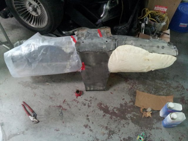

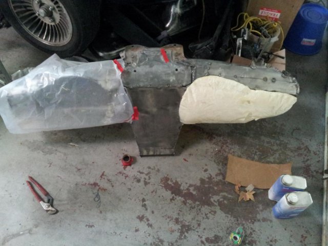

So what I finished doing was the right side of the instrument cluster and the center dash. I really don't like how the right side of the cluster turned out because it looks like a dent, so I am going to go ahead and foam in that area and level it off close to the center dash curve. The dash is now out of the car, as you will see in later pics. It came right out with no problems, even after all that welding. I already mentioned that I bought in preparation for foaming and fiberglassing the mold: Two part urethane foam Release wax PVA 1.5 and 2 oz fiberglass Fiberglass roller 2" ABS for gauges Polyester resin Hardener And here are the pics of what's been done. Center panel installed for a test run of what it will look like and maybe what the general curve will be. Ugg, that dent I "made" on the right side of the cluser looks bad. Definitely going to be using a lot of foam to level it out with the left side of the center dash. Might be able to actually fit this center console in here, maybe.... Testing a rough S shape for the center dash. Decided I didn't like it as much as a concave curve many of the newer and modern dashes have. An S shape would be amazing, but would have require more thought into how the shifter it placed and a harsher initial curve right off the dash. This stuff is amazing. I filled each little cup with about 2 mm of the liquid, then combined them. It is "cold" here in SoCal, so it only expanded about 20x, but still was very impressive. Hardens to workable in about 30 minutes. This was basically a test to see if the foam actually sticks to metal. Strangely, it broke away from the cardboard pretty easily. Just a few good tugs. But getting that metal piece off, even after trimming the foam wrapped around the edge, was nearly impossible. I believe I can pour it right on the dash. Tranny tunnel trim tacked up and center console fit over it. I do believe that with some trimming, the center console will work with this design. For myself, I intend to redesign the center console with cup holders. Without the console in place. Looks pretty rough with the box edges, but nothing a little foam won't take care of! Yup, out of the car again already! Stands up nicely and came right out without any problems. Mounting points were well preserved. Used a wire wheel over the entire dash to clear out welding slag and roughen up the metal further for foam placement tomorrow. Looking pretty good. I like the brushed look. And some youtube vids: And part "2":
Thank you. Heading back out right now. Picked up two part urethane foam, release wax, PVA, 1.5 and 2 oz fiberglass, fiberglass roller, 2" ABS for gauges, and polyester resin and hardener tonight. $175 bucks. Wow... But I got a gallon of PVA, enough urethane liquid foam to do some other interior parts, too, and a gallon of poly resin. 4 yards of 1.5 oz and 2 of 2 oz fiber. Should be good to go for a first run. Might need some gelcoat... :-/ We'll see. Either way I can replicate other car parts now, too. Kinda thinking of doing a center dash and fiberglass trim parts. Maybe....
