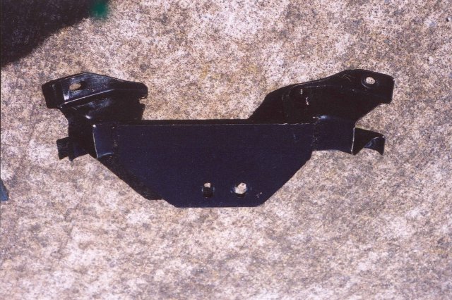

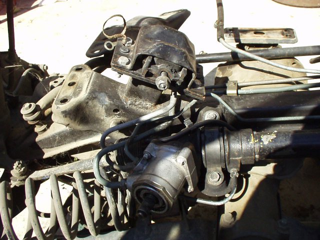

Maybe these will be of some help. These are what I did before I lost my mind. I hope this helps. Good luck. Joe -

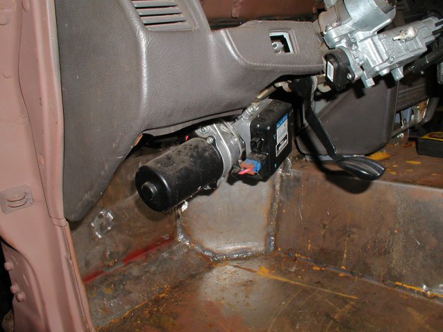

After the local Nissan dealer told me the price for the high pressure hose for my stock PS, I decided to go the electric route. I'm using the system from a Cobalt. The power assist motor is on the steering column under the dash and doesn't interfere with the legroom. It is connected to a Jaguar power rack, and the first trial (sitting in the garage) it seems to work well. Of course my car is a Z31, so it probably doesn't matter.

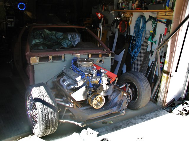

Lets see your V8 in your Z.
Chaparral2f replied to CJBrian's topic in Gen I & II Chevy V8 Tech Board
What, No Z31s??? First, when the engine was in the stock engine compartment. Second same car after a few minor modifications that are still in progress. -

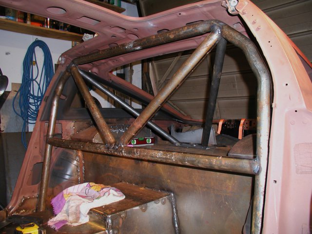

Thanks, I hope I'll only have to make one part. I dout anybody else would want a one piece front end for a Z31.
I can't believe its been a year since I updated this thread, but I've been restoring a Porsche that followed me home. I've got the firewall in, and fabbed up the engine plates (aluminum front, stainless steel rear). The electric power steering unit is in place, and the steering shaft has been installed. The roll cage is mostly done, and the floor is welded in. All we need is a much bigger shop, or a few less projects.
