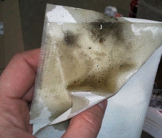

On a side note regarding rebuild residues, I strongly advice you to drop the pan. I know it is a pain but I had many chips that remained in my pan after the first oil change. I only run the engine with fresh oil after rebuild for 10 minutes. I expected to do the same with the next oil change that should occur in 200-300 miles. Here's what remained after I wiped the pan once with a paper towel
