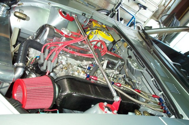

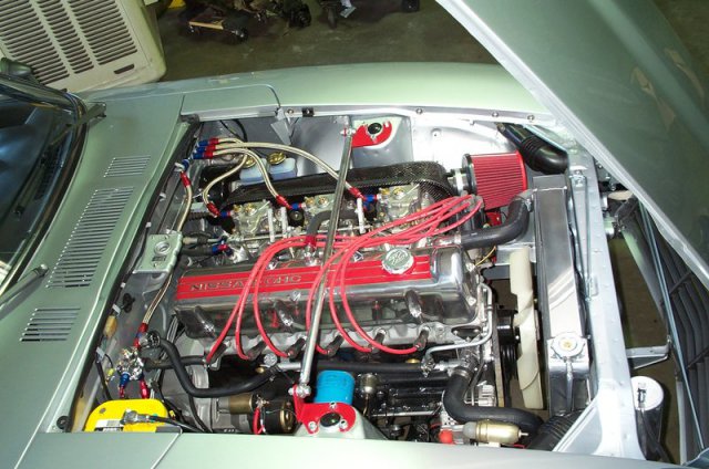

I realized that I never got back here to post pictures of my completed engine bay. So here it is L-6, N42 bored and stroked to 3100cc, E88 with lots of work, TWM intake with Weber 45 and a custom made carbon fiber air box from Keith @ www.customworksproducts.com

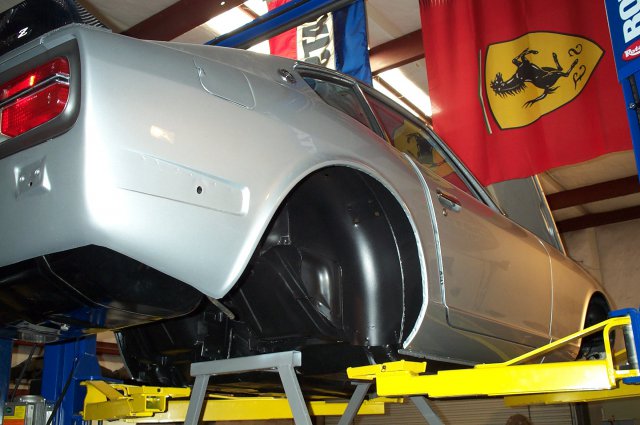

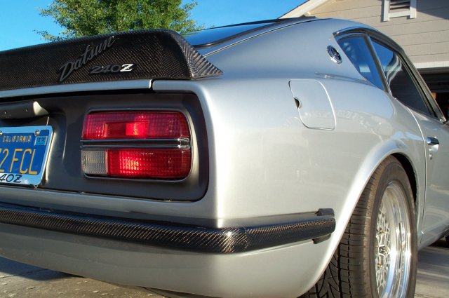

I found these photos and if you look closely at the lip area you can see the clearance work done. If you click on the photo it will enlarge so the clearance work is visible.
The pads were purchased directly from http://www.porterfield-brakes.com/ The front lips are rolled and with a BRE spoiler the 225-50-15 would fit in the front. With the 225-50-16 the tires would hit when turning at the lower front valence so I switched to the current air dam. To fit the BBS wheels over the brake calipers I had to grind off a lot of caliper material and add a 3/8 inch spacer. There is no front lip issue. The rear fender wells were massaged very slightly. I thought I had pictures on here but I could not find them, but this is what I did, because attempting to roll the rear lips will deform the finders. I used a hand grinder and ground in a smooth arch removing the material just up to the spot welds at the top of the finder arch. This is approximatly 1/4 inch. There is 1/4 inch of clearance at the lip and at the spring perch on the inside of the wheel. With these modifications I have absolutely no tire rub.

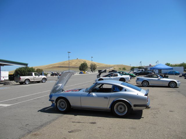

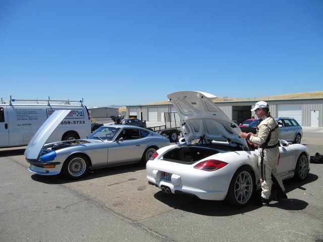

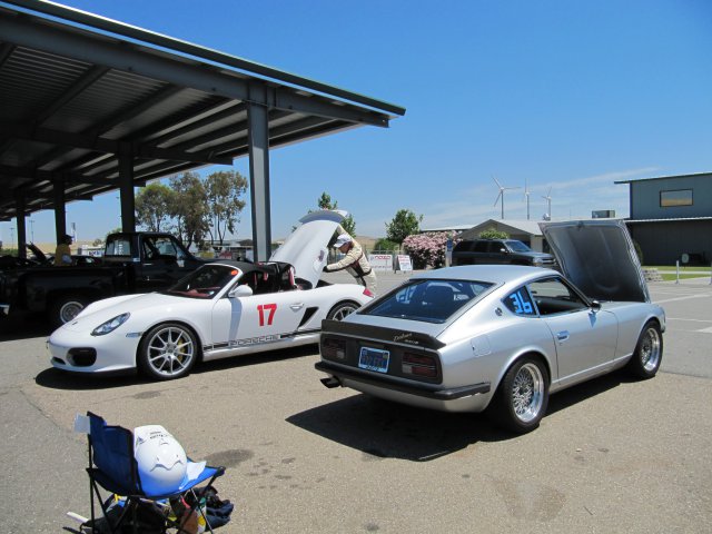

I got to take the Z to the track in spring 2010. Drove the car to Thunder Hill as a last minute deal (got the OK from my wife the night before). So I just got in the car in the morning and drove. I did not get a chance to put on sticky rubber or anything. The Z was amazing. It handled perfectly. I drove the car as is, I did not remove weight (amplifiers, sub woofers, passenger seat) the tires were Bridgestone G009 a high performance A/S tire. It handled almost flawlessly. When driven at 80% there were no issues. When pushed to 100% I found a limitation with the brakes. At the end of three laps at 100% on the back straight I was out accelerating a Corvette Z06 405 hp version and my brakes faded. No issue occurred but I found out something about the car. When I purchased the brakes from MSA I asked if the brake pads were a performance pad and I was told yes they are. After this event I called MSA and asked again if the pads are a performance pad (so I would have an idea of what to purchase as an up grade), and I was told no. They are a standard Toyota pad. So I will be up grading the pads. It was great to see how an old Z compared to the modern cars. I was there by myself so I did not get any action shots but here are some in the paddock.
