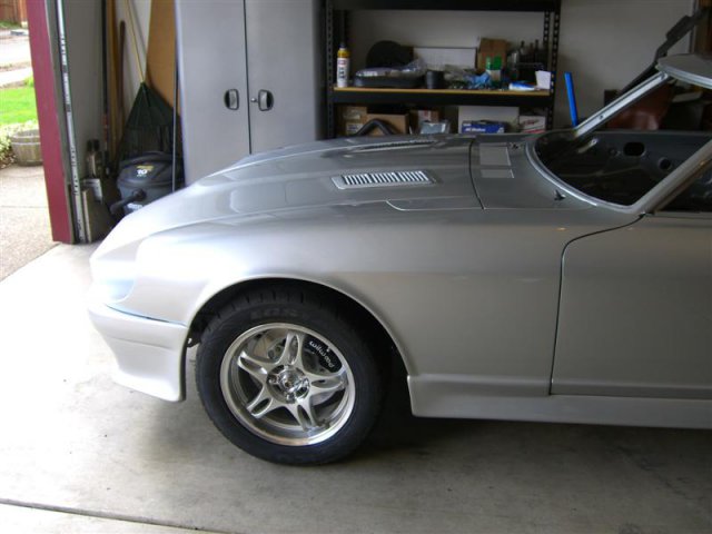

  3. I would have to agree! It's taken me a while to get used to the 16x7s (with 225s) I have on my car and once it's back together and sits another 1 1/2" lower, it should look pretty good. I was looking and not using them and going with 17s and might still do it, but I'm sure the ride quality is better with the 16s.

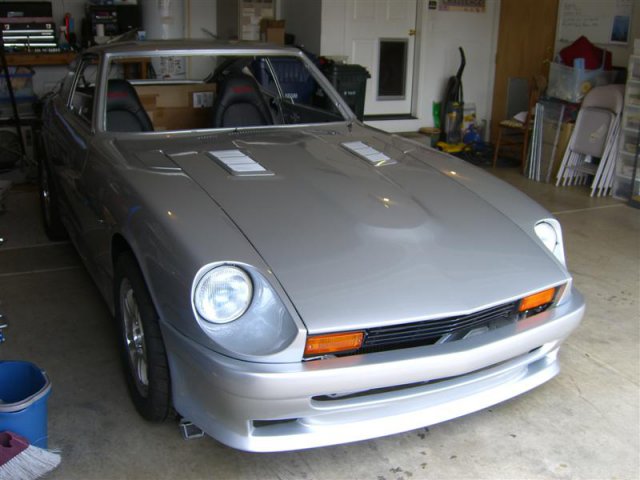

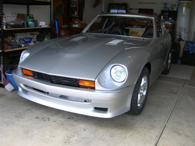

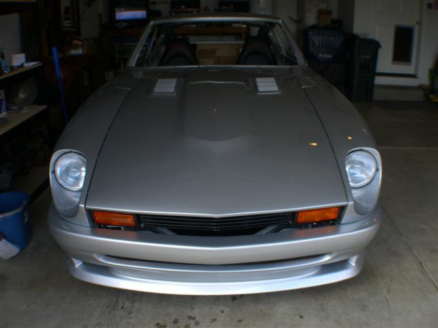

  4. Very cool. I still think the hood should be a bit wider and fenders narrower (on the top). Is it just me, but in the pic with the straight on shot of the car from the rear, do those rear tires look a bit narrow? It'll need some meats on it, if it has real power. (it better!)

  14. Well, I installed the wiper assembly & cowl, then had my buddy come over and we put on the hood, inspection lids and aligned everything. I'm still waiting for the rear wing from the body shop, as the painter dropped it when we were loading everything up and had chipped the corner of it. Once the wing is on and the glass is installed, at least it will look a bit more complete.
