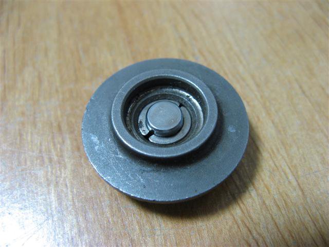

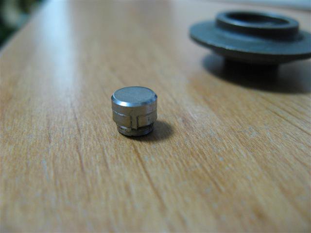

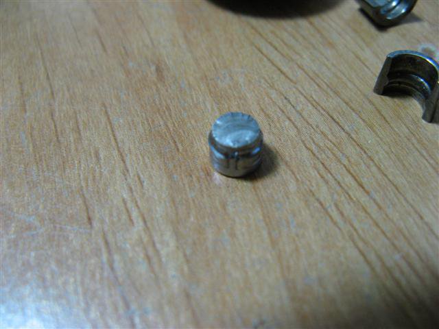

That much spring and cam lift with the stock valves and you're going to find out the meaning of expensive pain. Stock intake valves love to pop the head off in engines revving 9,500+ with 10+ lift, high pressure springs and heavy retainers. The attached pictures are of valve drop #3 in one of my engines about 10 years ago. The first two times I thought it was a fluke... You can see how soft the stock valves are by how badly the keepers have imprinted the tip. One question I always ask people is if you can make 800hp with the stock valve train (including stock springs) and 272 cams with under 10mm of lift, why all the exotic stuff? You're significantly increasing the wear and tear on the engine for no real gains in the "under 750 club". "Berry-ring" is Tomei speak for beryllium seats. Transfers the heat out of the valve better than the stock seats. It's mainly used with titanium valves to keep them from wearing out so fast. Every time the valve slams closed, there's some "micro welding" that happens and erodes the seat and valve. Titanium doesn't wear near as fast on a beryllium seat as it does on a standard seat. It's the difference between a 1,000hp RB26 and a 1,100hp RB26. To each his own, but if you're planning on under 750hp, you need pistons, rods, cams, "A" springs are a good idea, aftermarket head bolts or studs. That's it. Never even lost a stock head gasket at this level. Keep the revs under 8,500 and it'll run forever. The RB26 has other limiting factors that set the power limit before you get to the level where some of these mods are needed. Case in point: All this new hi-tech stuff coming on the market as of late, but the engine hasn't made any substantial power gains in the last 10 years. Like I said, buy it if you want it, but remember that dual valve springs do not add reliability to the engine
