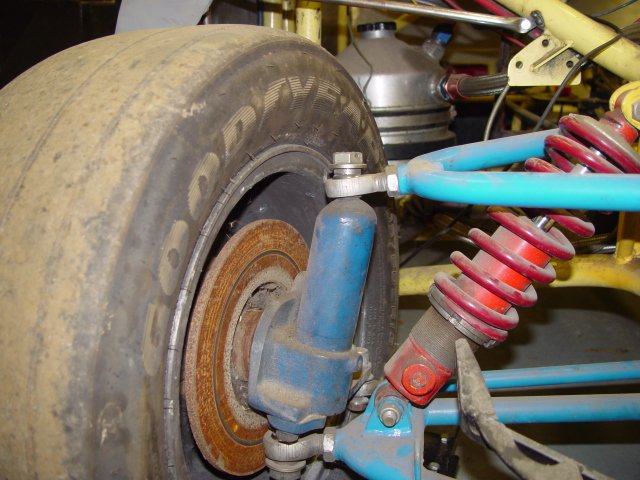

Hi Ron, A swaybar will definitely add a radial load to the bearing. But it's common to see lots of cars running bearings with shock/rocker loads going into them with no problems. The only ones I know about that change the orientaton of the bearing are cars that make tons of downforce (as in 3000 lbs+) and then you limit the max amount of steering lock you can run. I've been looking closely at either using a captured spherical or the low friction CT balljoints. Given the cost of the latter I'm leaning that way with simple Afco control arms. It almost doesn't pay to make this stuff anymore as cheap as you can buy it from them. Cary -
Replacing Ball Joint with Rod End?
tube80z replied to JustinOlson's topic in Brakes, Wheels, Suspension and Chassis
Here's something similar using a strut turned into a double a-arm. I'd personally use a captured spherical bearing for this application but a good quality 3/4 rod end should suffice (that's what was used in the attached pics). -
Not to pick on you but the RC position does matter in these cars. I'm sure it's related to other factors but this was an area of experimentation last last year with a friends LS-2 powered car running FA rear tires setup for autox/hillclimbs. If we raised the RC to get the car to turn in better it lost bit coming out of corners and was much quicker to overheat the rear tires and cause the handling balance to shift towards oversteer. If we lowered the rear RC the car put down power much better and didn't overheat the rear tires but wouldn't turn in that well. We played with spring changes and moving the front RC to try and solve this but there appeared to be a sweet spot for this car with the rear RC. We ran out of time before trying to add a rear ARB to see if that would help to get the car to turn better. Unfortunately we didn't have a complete model of this car to understand what else we were changing. Cary
