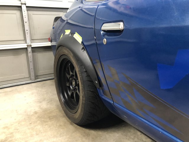

So for the 9.8 and 9.9 passes they were on a 26x8 Hoosier bias ply. The fenders are trimmed they cleared there no problem but were a bit tight to the factory spring perch.

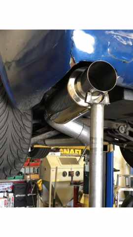

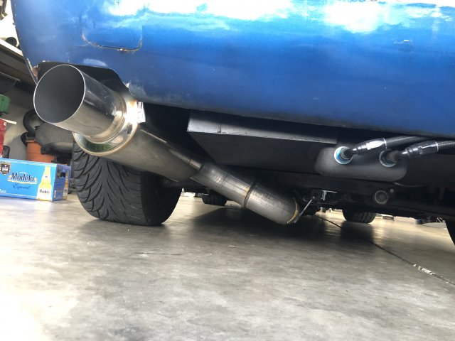

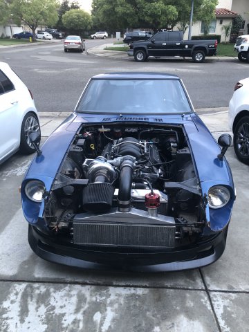

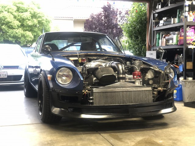

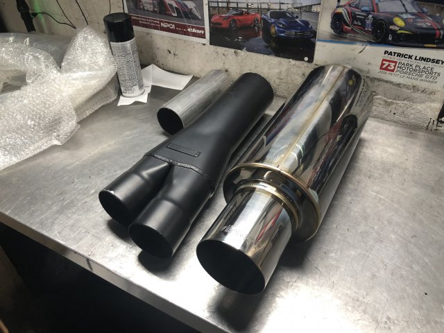

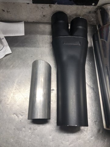

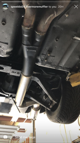

I didnt have enough time to address the exhaust before the tune as the blower was still in a different state the day before. So I brought it in open xpipe and it had a y to a single 3” and that just wasnt going to flow enough. Off to the exhaust shop for a 3” y to single 4” and straight through vibrant 4” muffler.

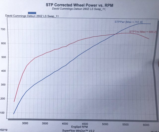

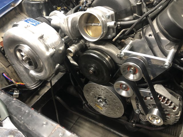

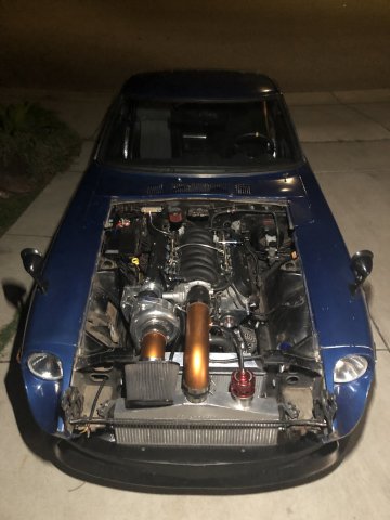

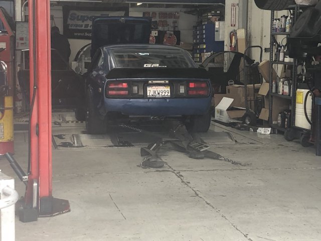

I fought belt alignment issues for a good month or so and after destroying a couple belts I think it was finally straightened out. So it was dyno time. Still only had 245s on the car so it wouldnt hold after 5800rpm. But at 5800rpm on 12psi it made 751whp/685wtq. So with another almost 1000rpm on tap I dont doubt its making over 800whp now.

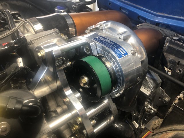

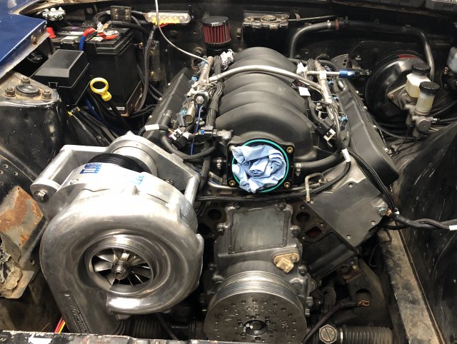

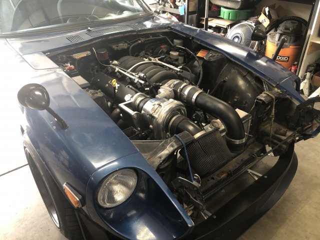

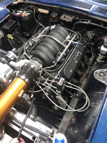

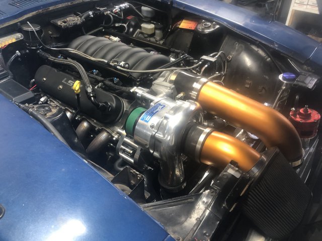

Got a killer deal on a c6 corvette procharger kit. D1SC, 10% lower, boost cam, meth going on. After the radiator support was cut out the whole kit dang near fell together.

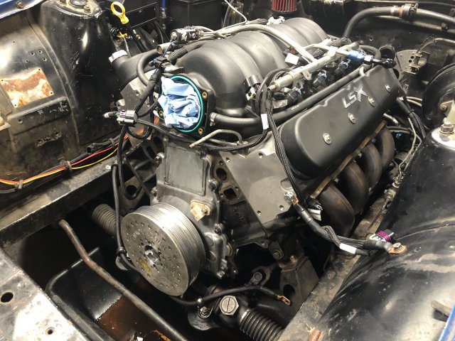

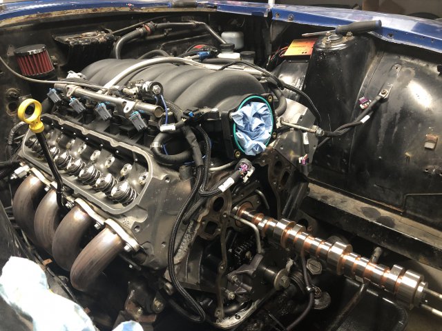

The goals have been met. That means its time for more power. From here I started brain storming. Turbo? Twin turbo? Badass na ls7? Supercharger?

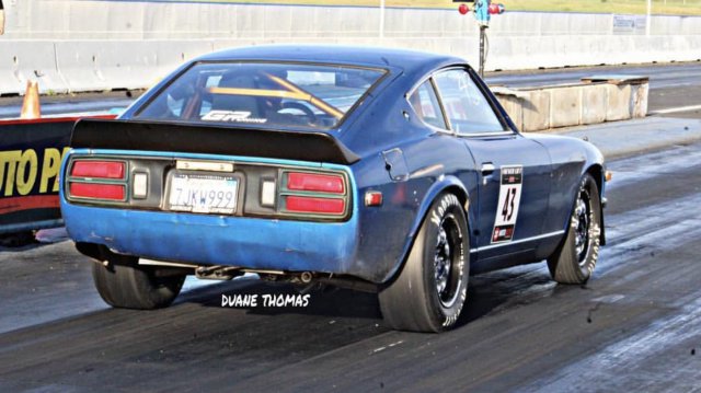

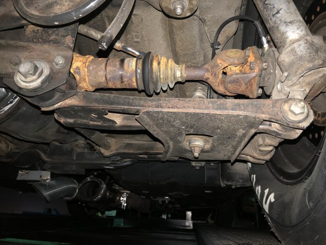

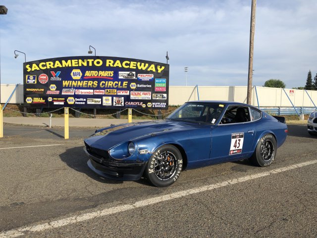

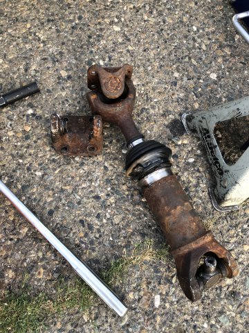

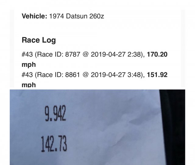

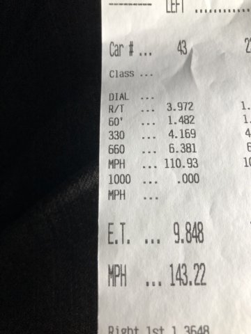

So this met one of my goals for the car. 170mph in the 1/2 now all I needed was a 9 second pass at over 140mph. And just my luck there was a track rental the same day. So I loaded the car up. And headed north about 4 hours to sac raceway. First pass. Grenaded a half shaft. Not a great start. So i ditched the 2 step as it was just too much for the stock half shafts and I just couldnt work the pedal right. Made some more passes after that to a best of 9.8@143. 2 goals met in the same day. Decided to make one more pass on motor as I still havent made one with the slicks on. And well........ I found a second neutral in the t56 where 3rd gear was. No grind. No gear nothing. After a swift yank it popped out and like magic all the gears were still there. And heres a pic of one of the axles that made the 9 second pass.
