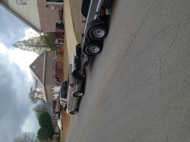

Picked up trailer and now my brake controller is not getting power. Probably another wiring issue from the engine swap in the truck. Glad it's not the night before the race! Downloaded a wiring schematic for the controller and I will do the voltmeter voodoo dance around the truck after work and try to fix it. To get the car to the race I have to keep 3 vehicles fixed: tow truck, trailer, and of course the Z. One step forward-two steps back. And it is prom weekend for my younger daughter. Don't know that Im gonna get started on the bellhousing this weekend. I'm gonna make it! -

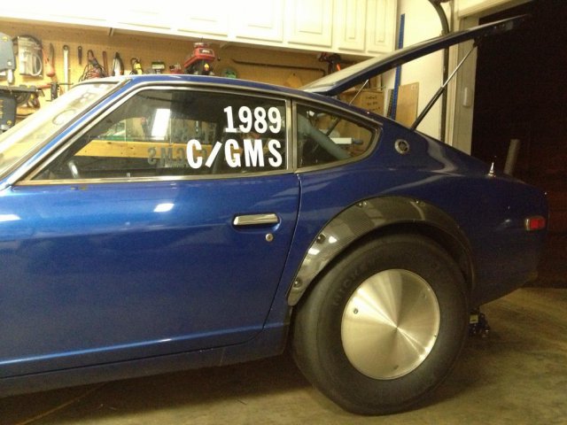

Tried to start car tonight and had a dead battery. Trickle charger on it overnight. Got the numbers on the windows. -

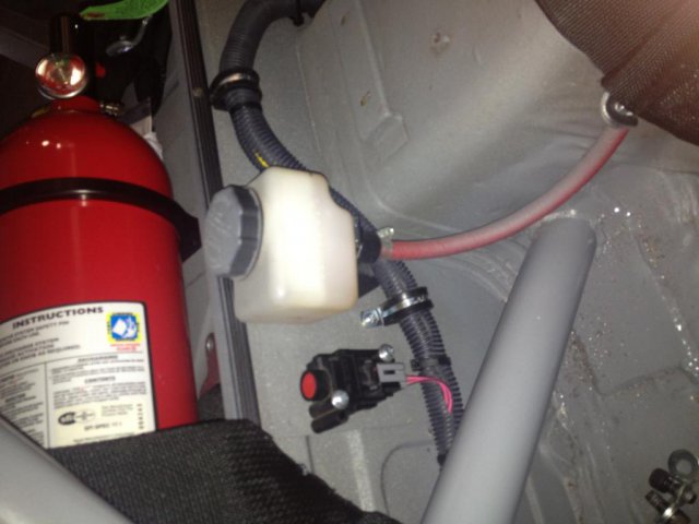

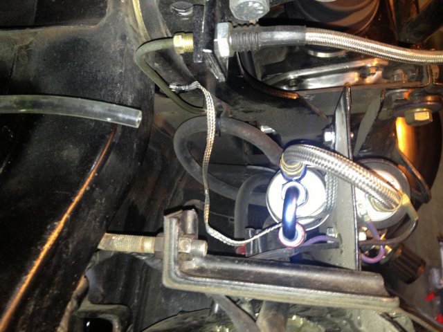

Show you some of the weird landspeed things. Battery power cables to go from the positive post thru a rear NHRA switch near the license plate to another switch beside the driver to the firewall with a bulkhead connector. Got these made up at the local heavy truck supply shop. Inertia switch with a (probably incomparable video file) that shows how it works. Then a weather pack-connected wire for the fuel pump. The inertia switch is in-line with the fuel pump signal wire from the ECU to the fuel pump relay. Got the fuel tank grounding strap done and the wheel mounted. Glad to be done with that evil fuel tank. Gonna put some gas in it tonight and see if it will run, then test this crazy electrical system out. trim.ZB92hW.MOV -

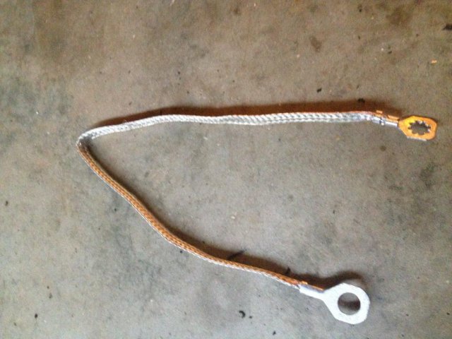

Man, Im pooped! Electrical mods are finished. The cutoff switches work. I need to pick up a grounding strap for the fuel tank and I can put the rear tires on and set her on the ground, get some fuel in the tank and make sure it still runs. Then I gotta make the sprinkler lines and get the seats in. I should be ready for next weekend and the bellhousing swap. That stock fuel tank is a bitch to install-why oh why did I not install a cell? My filler tube attachment to the tank always seems so borderline-but it has never leaked. Hope this time follows that record.
