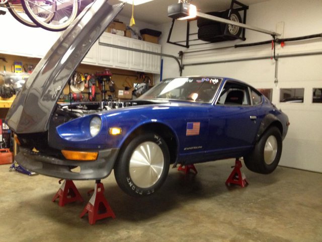

  4. And here's where I leave her for the night (1:30am).

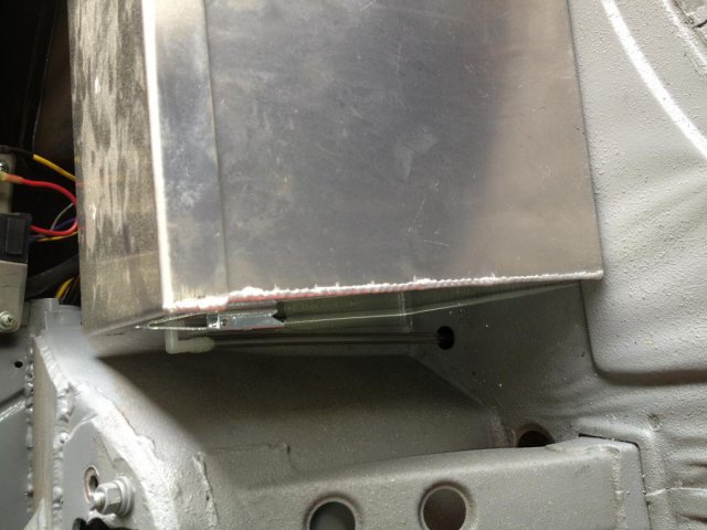

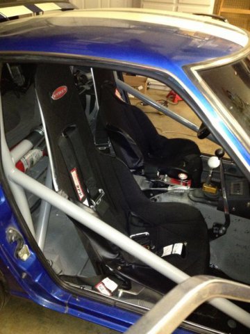

  5. Truck is under control so I spent the second part of today on the Z. Cleaned and applied first coat of silicone to the delinquent 2-piece wheel that wont hold air. Gonna let it cure for a couple of days before applying a second coat. that silicone was a bitch to get off. Finished the electrical safety switches; it starts and stops like it is supposed to now. You can kill it from the key, a master kill switch by the driver, a master switch at the rear bumper (if I had a bumper), and an inertia kill switch kills the fuel pump. Battery relocation is all NHRA legit now. Driver footwell fire system is completed, pics tomorrow in the daylight. I'm afraid to pull the safety cotter pin-it seems like it is under tension, but the big cable is installed and adjusted properly, so I'm probably just chicken. I just don't need any more problems. I will get the safety steward to pull it on race day, then it is his fault if I fill my car with foam. Plus he probably knows what the pin is supposed to feel like. Garage is clean and car is vacuumed. Going to install seats. Stopping point tonight is to have it on jackstands ready to pull tranny tomorrow. Wife is letting me have both sides of garage this week.

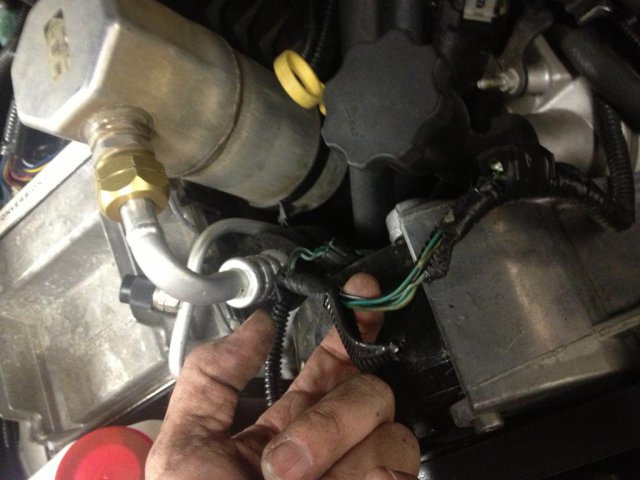

  10. While fixing the battery relocation installation on the truck and replacing the battery, I noticed a big puddle of antifreeze on the ground. Not the hoses this time. But rather the cheap radiator overflow tank has cracked AGAIN! #%}{€*+#<!!!!!! Gonna swap that cheap POS with an identical cheap POS to get thru the race weekend then it is time for an aluminum overflow tank so I don't have to fix it a third time. Will try to find pre-formed hose to take tension off the milk-jug plastic tank nipple ( where it keeps cracking). The work around the Radiator overflow let me find the problem with my AC-melted wiring. I guess that crap is too close to the header. Big money for a pro swap and now I have a cooked section in the harness within a couple months. #%%^*+#}{}#><>!!!!!! Gonna reroute that to prevent further damage and try to get to work on the Z.

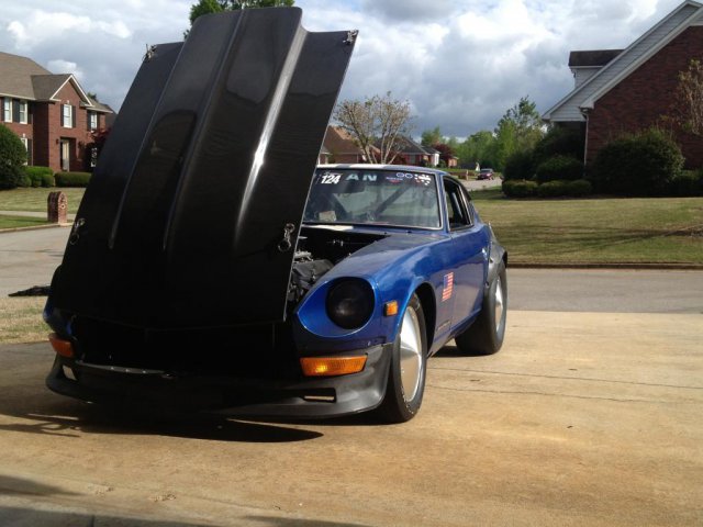

  15. You win the lottery? I remember the plastic tent you did your last build in. I don't remember a fancy driveway and good grass (in the yard).
