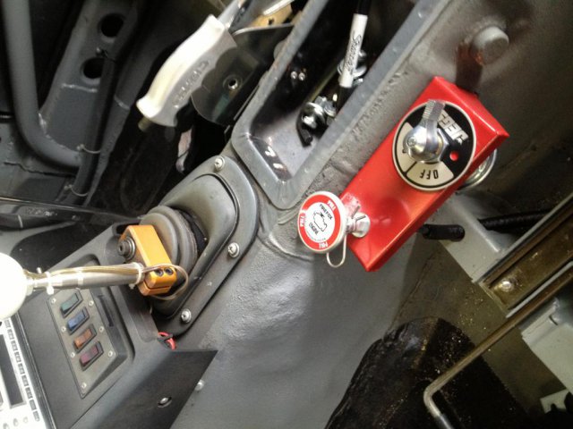

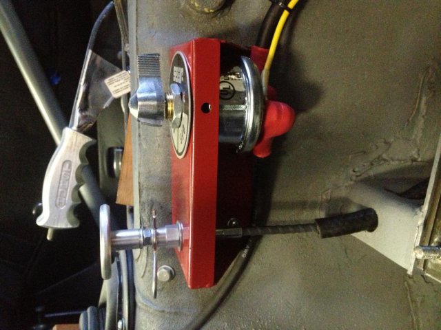

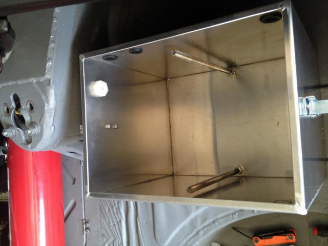

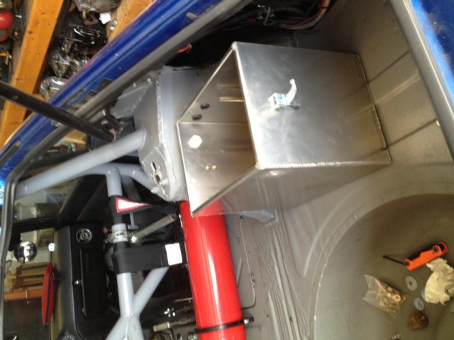

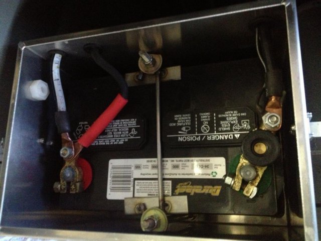

Battery box in. Driver's emergency panel in with cable and switch mounted. Hoping to get cables made up on Thursday. Hoping to be done with the shiny side a week from today. Sorry photos are sideways. -
