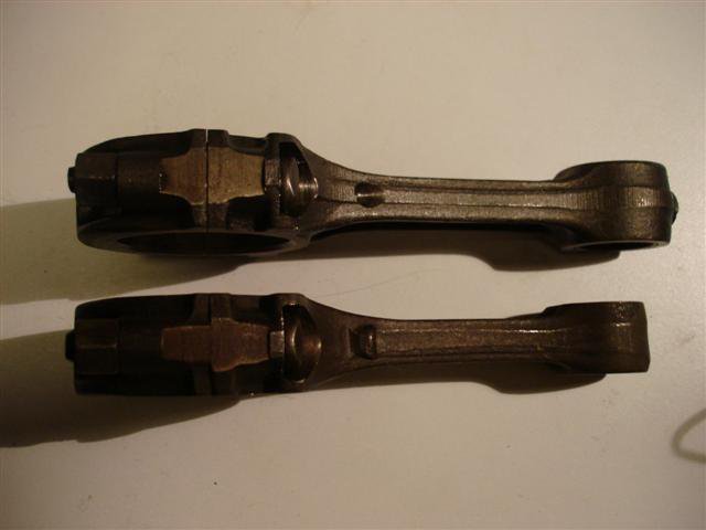

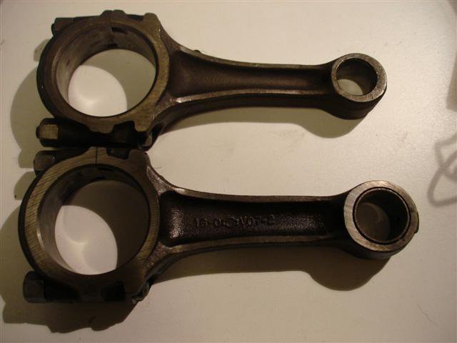

I'm backkkk... I am acquiring L20B rods bit by bit. Yesterday I bought a L20B from a mid 70's truck headed for the crusher! It was a total rust bucket and had actually collapsed upon itself. I could see the oil pan and stopped the frontloader operator just in time. The engine was pulled down last night. The whole engine was in great shape just worn out. I pressed out a wrist pin today to allow comparsion of all three rod types. The L20B rod look just like the 240Z rod only 12.9mm longer. I'll post pictures of the three rods side by side tonight. I hope to get two complete sets so someone else can opt in for building one of these. There is already a spare timing cover from this engine. A fellow in AZ(?) is going to ship me another set of four this coming week. Some folks over on the Datsun 510 and 1200 sites are trying to help me get the extra rods. Now to look into custom forged pistons.
Even with the 227.45 deck height of the LD28 block and a L28 crank's 79mm you're left with only 21mm of compression height using a 167mm rod. That's only 10mm (<.5") of usable space if you keep the wrist pin out of the oil control ring land. I don't see how it could possibly be done and last anytime.
I took a 240Z rod (9mm bolt) and a LD28 rod into the quality control/calibration labs at work this morning. Using a digital scale I came up with the following overall and small end weights. 240Z 710gm 200gm LD28 784gm 260gm The small end was weighed placing a pencil through the big end and trying to keep it level while the small end rested on the scale. It wasn't scientific but should be reasonably close for comparison purposes. There is only a difference of 74 grams in overall weight and 60 grams difference between small ends. Considering everything that is not a lot to be concerned with in my humble opinion. I have a set of L20B rods coming and hopefully a set of Z22E rods too (both have a length of 145.9mm) that I can also compare. My decision will rest on those parts. Right now I'm heavily leaing towards the LD28 block/crank, the L20B/Z22E rods and custom pistons (40.05mm compression height). If I use a 21mm pressed pin then I have 29.55mm for the rings/lands. If I have custom rods made then I'll go to a bigger full floating pin which will reduce the room for rings and decent lands but should still be doable. I'm heading over to Abacus Racing to talk to the owner as he has raced Datsuns/Nissans for a number of years and should be able to provide viable input to my idea.
The rods are virtually identical at the big end. The small end is obviously larger by all dimensions to accomodate the big floating pin. The diesel rod shanks are identical from the side and slightly larger across the girth. I'll have to find a means to weigh them as my triple-beam only goes up to 2610 grams. I'm guessing the small end could be narrowed and bushed for a smaller pin if desired. With a set of custom pistons a larger pin bore could be used. The full floating feature is very nice for durability and performance too. I would definiately install ARP 8mm rod bolts if I used these. Now as for the block height, the LD28 is approximately 20mm taller than the L28 block when a petrol head is installed. I took a quick look around the engine bay of my 240Z. Using a plug of modeling clay I checked for hood clearances at the valve cover, front SU dashpot and the air cleaner vane lever. In all cases a minimum of 1" was available. The block could be lowered about 8mm before the the oil pan lip interfered with the upper saddle of the passenger side steering rack. That saddle could be slightly modded to allow 10mm to 12mm of total drop. The next problem would be the front anti-sway bar to oil pump bolt. That bar could be lowered using .25" shims on both bar brackets. Lowering the block even 8mm still provides 13mm or .5" clearance from the hood using the diesel block. While that is tight it isn't a critical issue. I'm going to talk with Aguyandaredhead about those L20B rods. I'd also like to get hold of a set of L13 rods to make comparison between all. If anyone knows a source for the L13's please let me know. Also, if anyone knows of another make of vehicle that uses a rod of like dimensions I'm very interested. There has to be something out there that is still in production that could be used with little or no machining.
