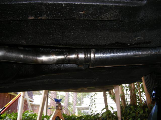

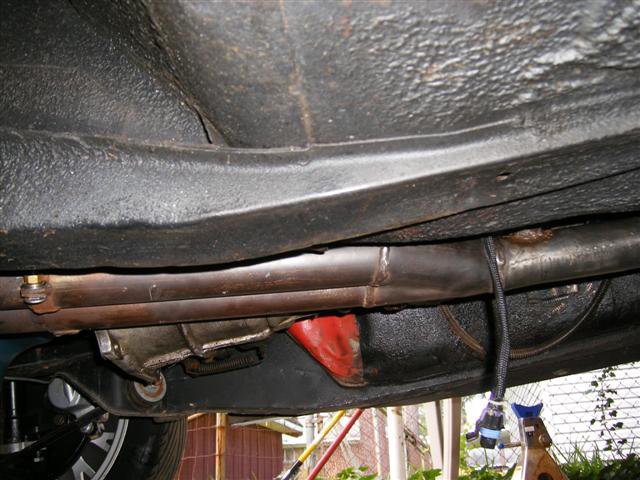

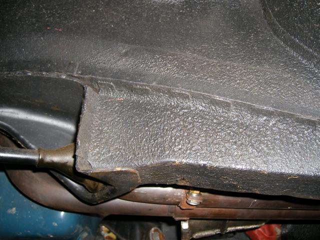

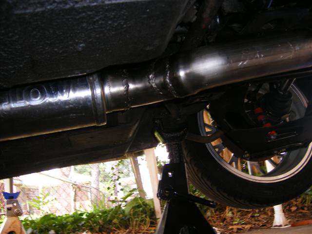

I ended up building a SS system using a 16" x 4" round Magnaflow (resonator) and 14" oval Magnaflow in the rear. The header is an old school SS JanSpeed (from the UK). There is an O2 bung located in the collector where the twin pipes merge into one for tuning. The piping is 2" up to the resonator and then it opens to 2.5" out to the tip. The cost is way up there but it should outlast me being SS throughtout. I haven't finished the vent hose replacements yet so I haven't fired the engine up yet. The hope that the resonator will make the car livable for more than weekend runs.

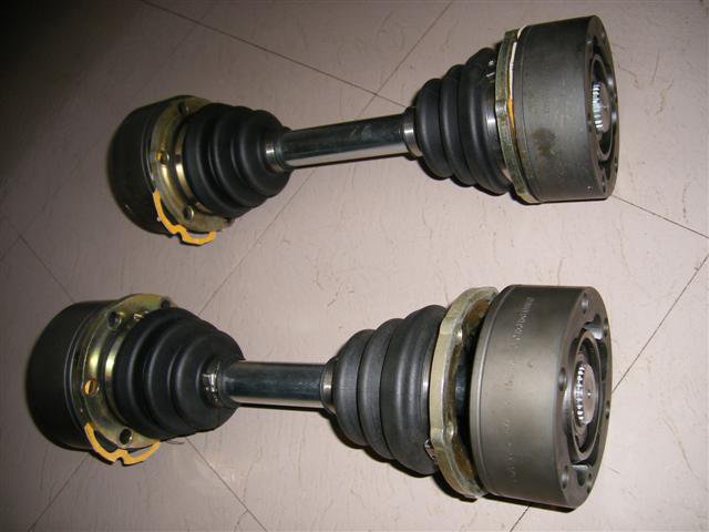

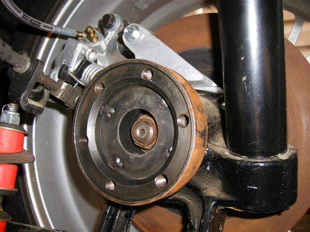

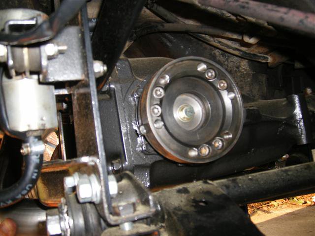

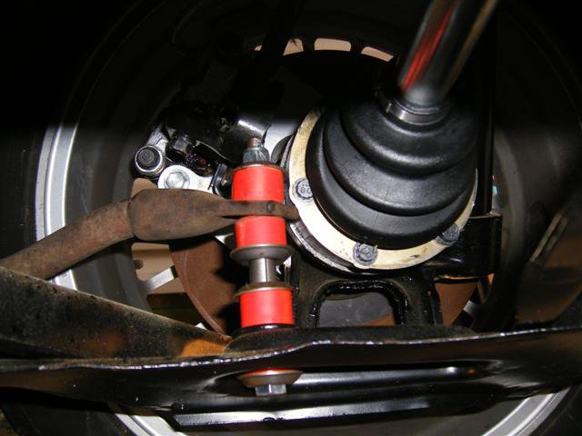

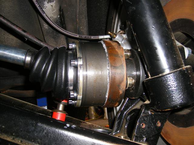

I'll get some info together. BlueOvalZ should also be a contributor. He was my inspiration to build mine. There are many variables to choose from when building a set of CV axles. I'm adding some more pictures of the axles being installed. Ignore the surface rust on the adapters. That will be treated and painted a bit later. In order to use the forward mount anti sway bar I had to shorten the links and modify the chassis brackets to move the bar forward about .5". It is as close as it will get in these pictures with the car on jack stands and the suspension in full droop.

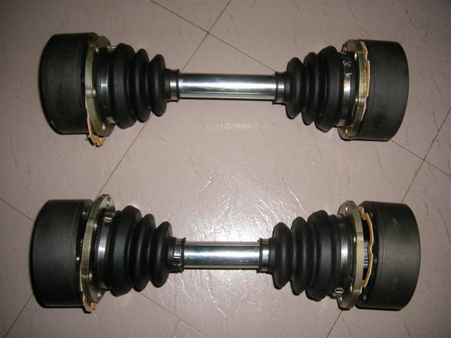

WooHoo! I finally got everything together and assemblied the CV axles! It took ages to get the proper CV flanges and boots. The adapters are bolted to the stub axle and diff flanges. A test fit prior to assembly went too smoothly to believe. These axles can be installed and removed without having to disassemble any parts. One step closer to putting the Z back on the road!

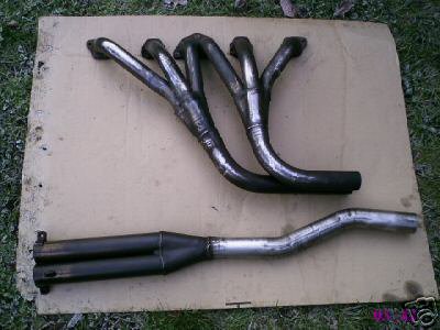

The biggest headache of headers is how so many hang down below the bellypan. Damage like we see here is commonplace especially on lowered cars. In most situations I'm guessing it is a compromise to gain better flow. I'll post pictures of my Janspeed 3-2-1 header installed when I shoot some tonight. It is tucked up well and sits higher than the bottom of the oilpan, follows the curve of the frame rails and ends centered in the tunnel level with the floor pans. You've got to love well thoughout and executed header desigh.

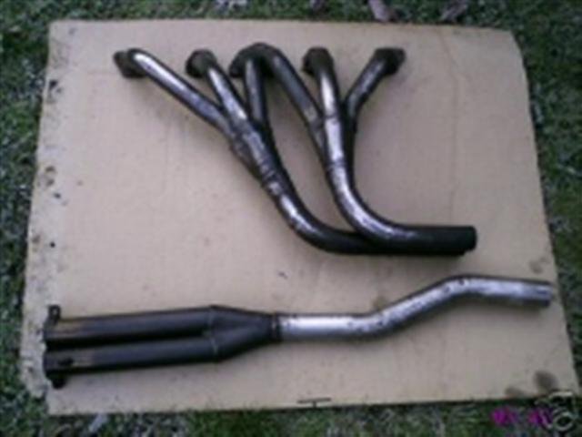

Here's the Janspeed. It is used so don't get worked up over the darkened finish. I just installed it this past Monday. It fit perfect and actually allowed for easy access to the inner stud nuts on cylinder #1 and #6. The long tube collector fits perfect as well. It passes the tranny and dumps dead center in the tunnel and flush with the floor pans. There's even a bracket to attach an additional hanger off the bellhousing for more support. When compared to the MSA 3-2-1 header I puller off it is hands down better. As for the Tanabe it is anything but cheap in quality or cost. I've seen the Magnaflow and heard one after the packing burnt out. They sound great if a bit loud and resonant heavily in an uninsulated Z (stock jute and carpet). They certainly have their application and I've used similar straight thru designs in the past. I've been there with two custom Chevy trucks (V8 and L6), four Camaros from 67 to 73 (SB and BB), 71 442, 71 Land Rover (96 Vortec V6) and several other street machines of various engine displacements. I've run reversed cherry bombs to Flowmasters and heard many more so I know very well what sounds good and what grates on the nerves over time, at least to me. Again, exhaust tones and tolerance are very subjective. To each his own. I simply was asking if anyone had heard one in a S30. I haven't made any choice except it needs to be stainless. Rebuilding a custom exhaust rotted due to mild steel construction sucks. I do build my own exhaust because quality counts and there are no mandrel benders in my area. I'll be looking into the other lines as well. Thanks for the input.
