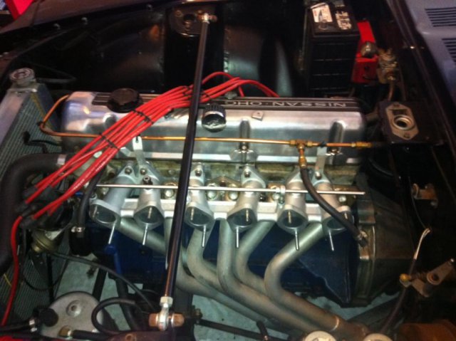

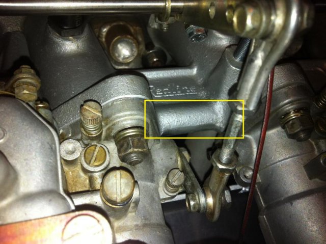

Leon Posted May 22, 2013 Author Share Posted May 22, 2013 Thank you Leon, follow on question: on my redline manifold, there is "webbing" if you will connecting all the runners for support/strength. On runner 1 and 2, the runners are connected via a 1/4" hole drilled through this support, essentially allowing runner 1&2 to balance each other on the front carb. The reason I assume this was done was because of the port drilled into the manifold of runner 2 for the brake booster. Now for the question, I noticed during measurement w the synchrometer that the front carb flowed higher than the center and rear carb (front carb: 7, center: 6, rear: 5.5). Could the larger discrepancy be part of the "cross-talk" you mentioned above because cylinder 1&2 are drawing from each other, causing a slightly larger vacuum on the gauge? And would it make sense to take that into consideration when balancing? I had to turn the mixture screws for barrels 1&2 in quite a bit to bring it down to the lowest flowing carb. Interesting, got some pics of the manifold? Since 1 and 2 aren't right next to each other in the firing order, cross-talk isn't as prevalent when compared to adjacent cylinders (in firing order). As for the discrepancy, that can be due to many different factors. Minute adjustments of the idle speed screw should make up the difference seen on the flow meter. Just make sure that your 1st progression holes are covered. If you have newer carbs (151 series), then they'll have air bleeds which you can use instead and match all carbs to the highest flowing one. I'd play with mixture screws after you get the flow balanced. It's an iterative process, so you'll go back-and-forth a few times. You have a wideband, yes? Makes getting the mixture right much easier. Quote Link to comment Share on other sites More sharing options...
T-Bone028 Posted May 27, 2013 Share Posted May 27, 2013 Interesting, got some pics of the manifold? Here's a picture of what I'm talking about in regards to the runners being "connected" via a 1/4" hole/balance tube between runners 1 & 2. The balance tube is highlighted in yellow, and runs across the entire manifold. Only runners 1 & 2 are connected via the hole drilled through the balance tube, runners 2, 3 - 6 are not drilled/connected. And here's a picture of the entire manifold Also, I noticed you listed a "zero" bleed for the pump jet exhaust valve...what was the biggest change you noticed with going to a zero vs something like a 50 or 55 (or whatever is normally fitted)? I've been trying to read up on side draft central...so much info to absorb! Lastly, I dont know what I would do if I had TWO Z's at the same time...one Z already consumes all of my available time! Keep us posted on your L28 build! Quote Link to comment Share on other sites More sharing options...
Leon Posted May 28, 2013 Author Share Posted May 28, 2013 Here's a picture of what I'm talking about in regards to the runners being "connected" via a 1/4" hole/balance tube between runners 1 & 2. The balance tube is highlighted in yellow, and runs across the entire manifold. Only runners 1 & 2 are connected via the hole drilled through the balance tube, runners 2, 3 - 6 are not drilled/connected. And here's a picture of the entire manifold Sweet, thanks! I had no idea the Redline mani had a (partial) balance tube. I should check my TWM... Also, I noticed you listed a "zero" bleed for the pump jet exhaust valve...what was the biggest change you noticed with going to a zero vs something like a 50 or 55 (or whatever is normally fitted)? I've been trying to read up on side draft central...so much info to absorb! The zero bleeds were part of the final stage of tuning: accel enrichment. I wasn't getting enough of a pump shot so I increased the volume by not letting any fuel bleed back into the float bowls. This was part of what cured my low-RPM pedal-stomp stumble. Lastly, I dont know what I would do if I had TWO Z's at the same time...one Z already consumes all of my available time! Keep us posted on your L28 build!Tell me about it! I'll keep you posted. Quote Link to comment Share on other sites More sharing options...
