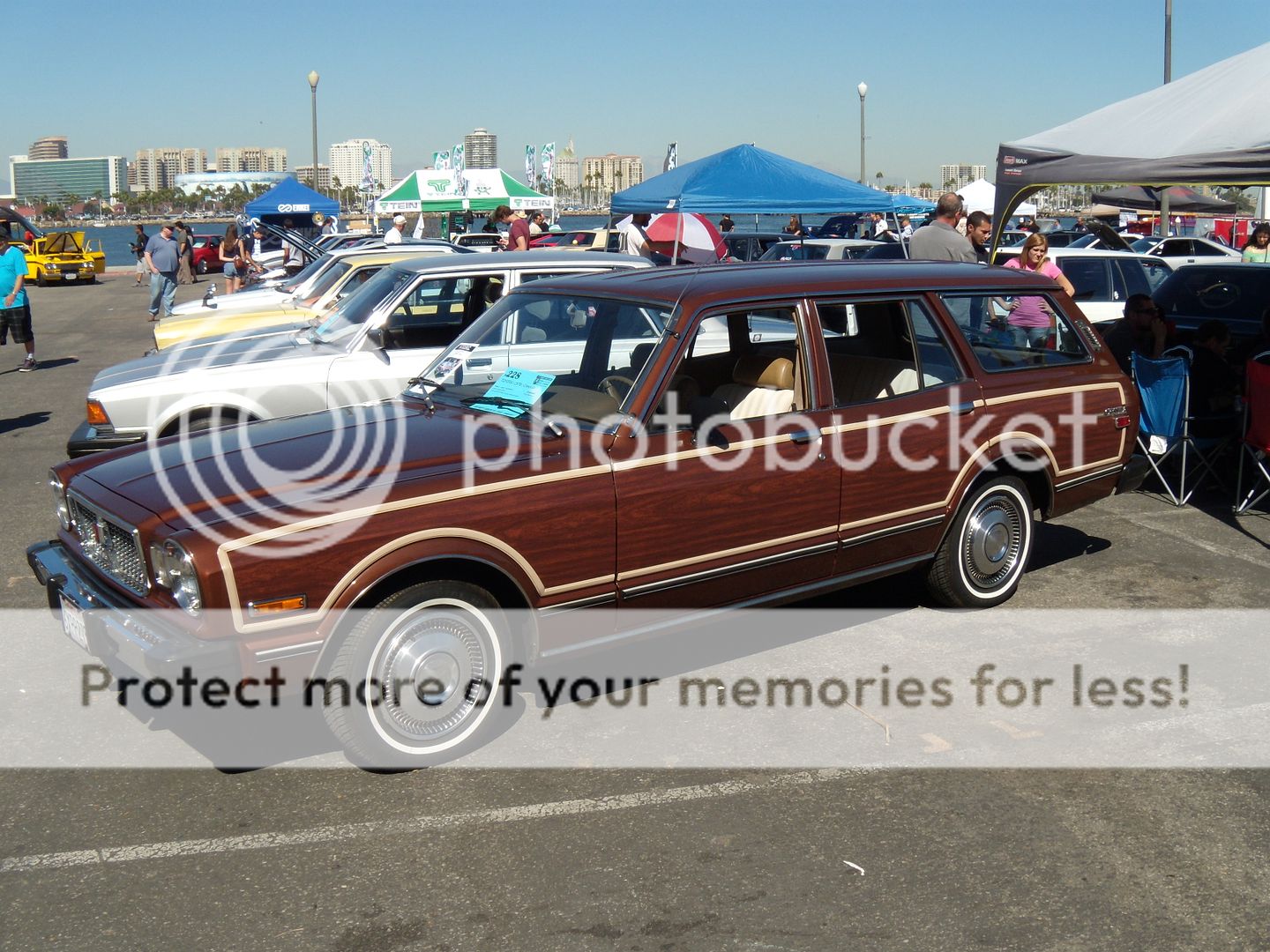

Woody Cressida!

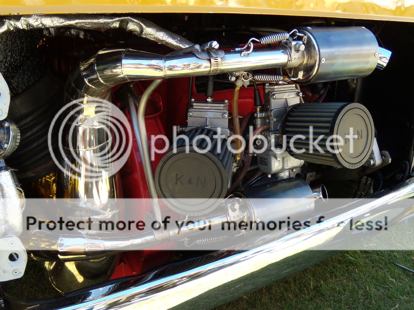

And a very nicely done engine compartment...

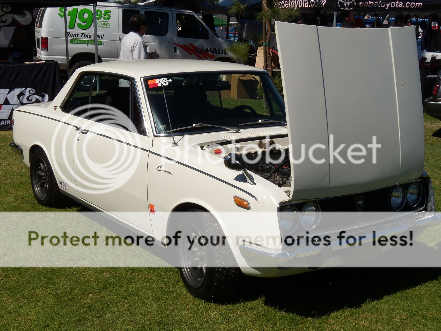

Toyota Corona Coupe

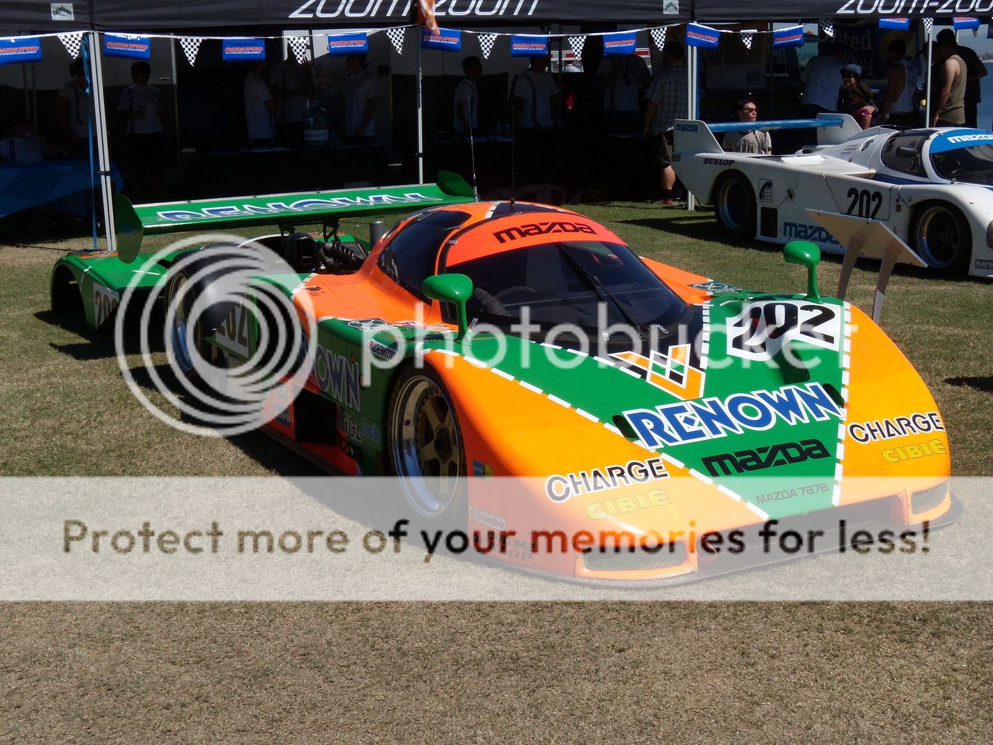

The Lemans-winning Mazda 787B

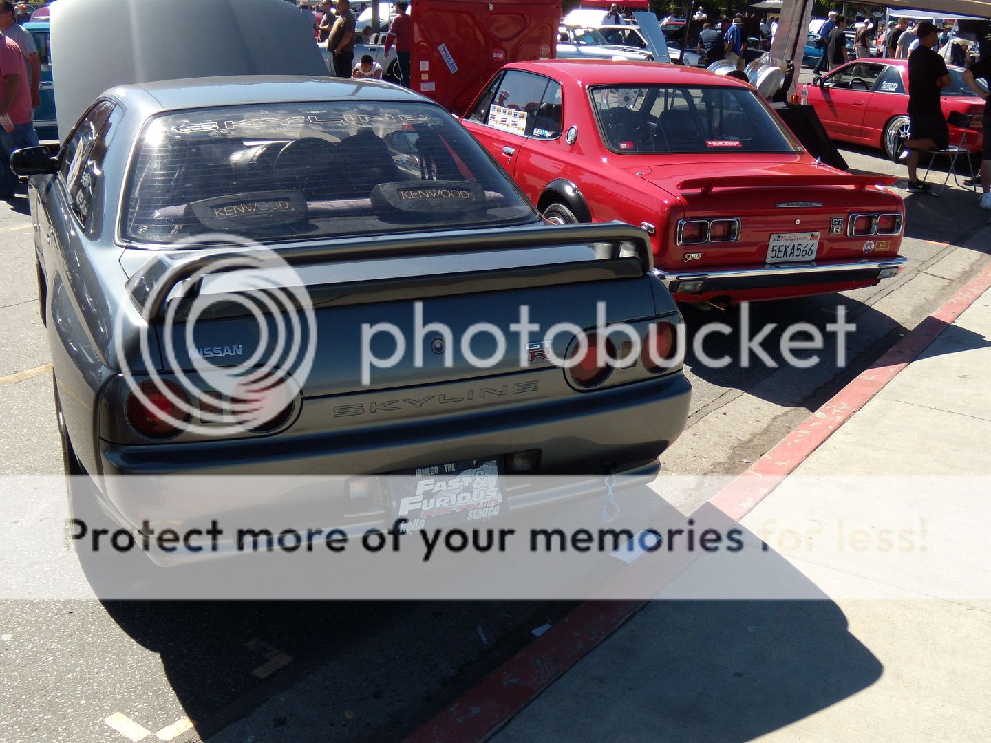

R32 and KGC10

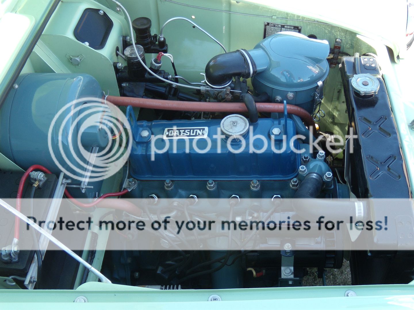

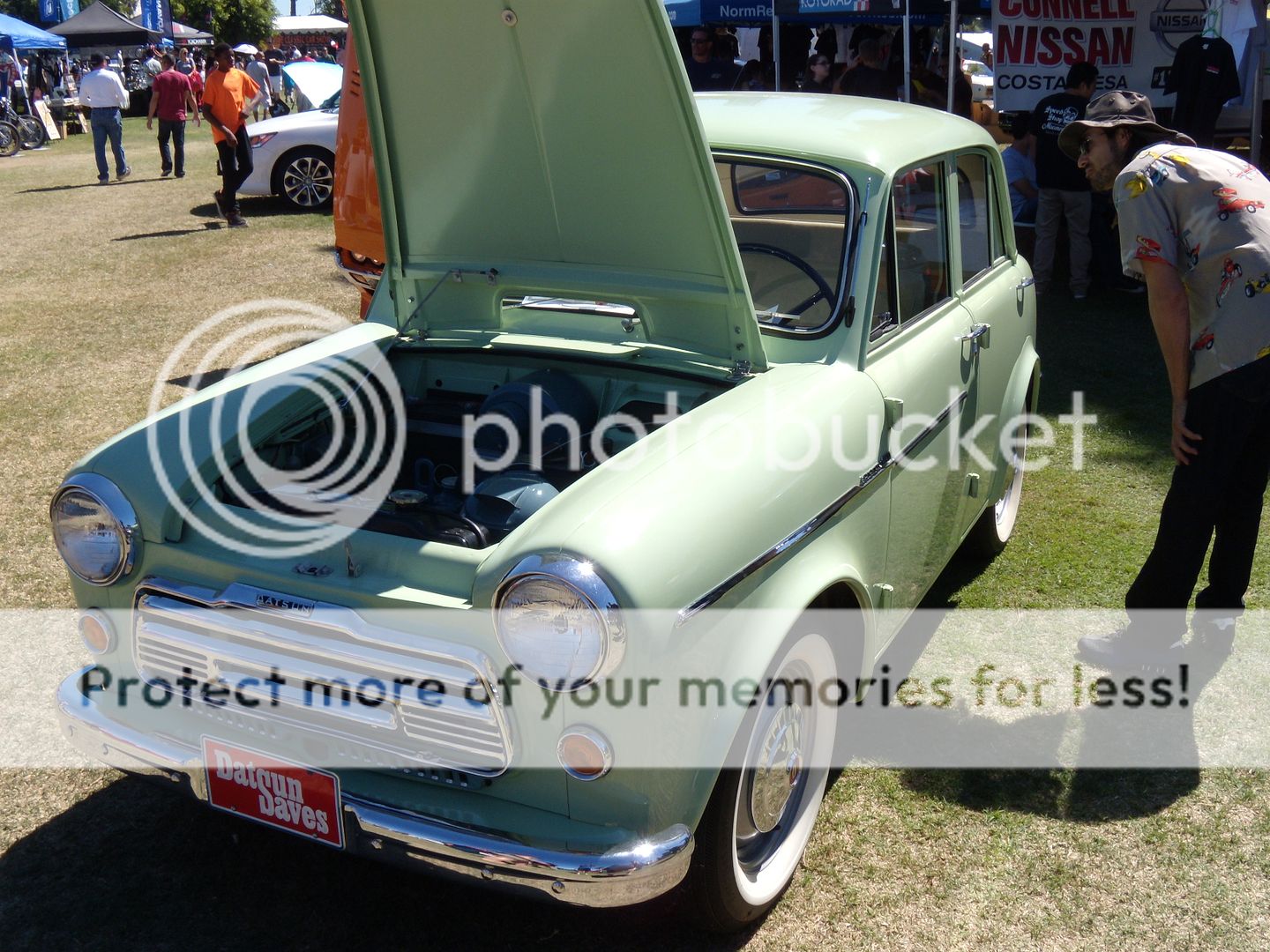

Restored Datsun 1000

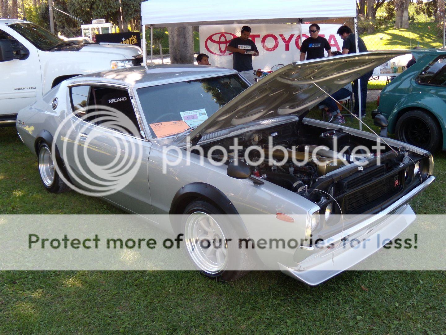

C110 Skyline with L28
C110 Skyline with RB26

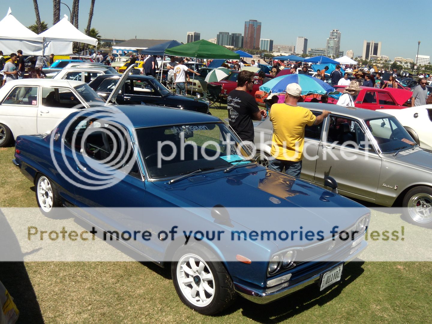

Beautiful Skyline Coupe with intact surf-line!

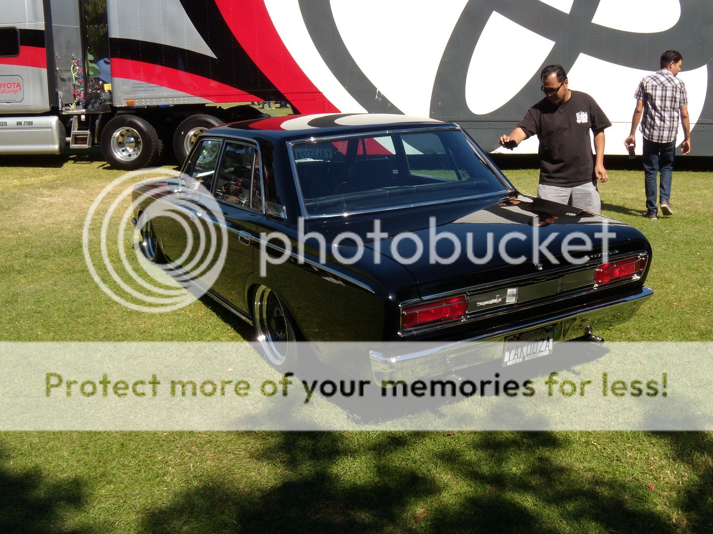

Very mean-looking Toyota Crown

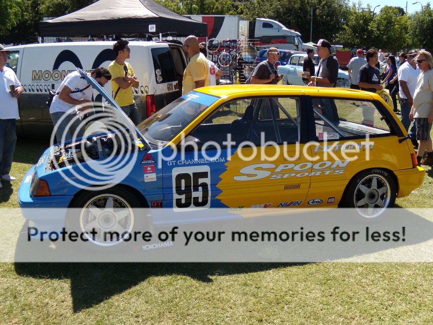

Spoon Civic
