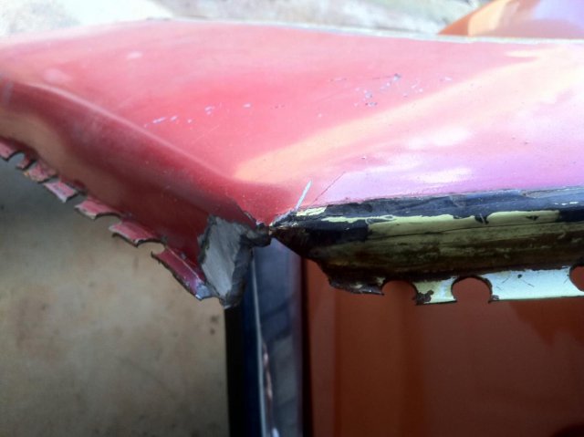

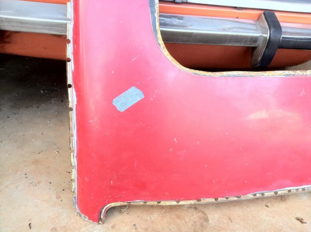

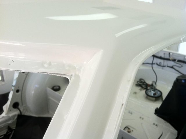

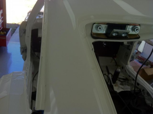

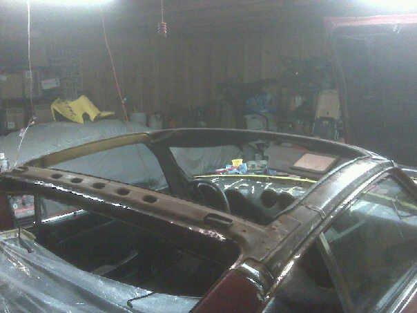

two pics of roof skin removed.... Do it the right way and cut out spot welds on both roofs. Take a torch and heat up the rear pillars and melt away the body lead that is in this area.  Eastwood sells a Body lead kit for the new seams once new skin is on.   Do it this way and you will be very happy with the out come.
Share this post
Yes, that's the right way to do it. I had the same problem, and solved it the WRONG way. DO NOT cut the A-pillars; in some states that isn't legal and in some others it automatically gets you a salvage title. I cut the roof along the rear of the hatch, about an inch up from the hatch opening and about an inch up from the sides, instead of cutting the spot welds...now I have a roof that is slightly lopsided.
Cut the factory spot welds free and carefully work the edges of the panel up from under the lead...that's how it was installed to start with and it's the best way to put it back on.

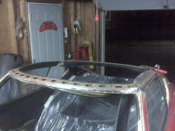

The lead is over the seams which will need to be cut out near windshield and rear hatch, just heat with torch and lead will melt away.
On the spot welds, the  way I did it was to drill small pilot holes for the spot welds, them I removed the spotwelds from the top on my car. On the donor car, I had the junk yard cut the roof off the car a few inches past what I needed. On the donor roof I drilled the spot welds out from under the roof so the donor roof was complete with only small pilot holes and I used these to reweld roof on and used 3M seam sealer along the rails.

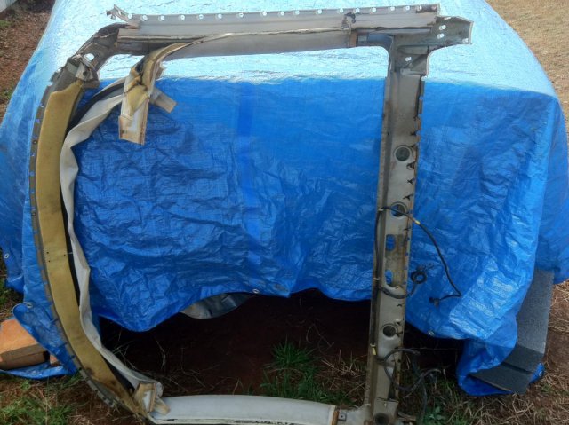

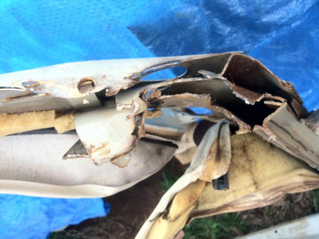

This is why you dont just cut roof off at pillars and weld on...multi layers. that would be 4 including roof..
original roof spot welds cut out from top.
lead can be seen in this pic.
spot welds cut out from underside of donor roof, will have to trim some areas to get to backside of spot welds as shown here.

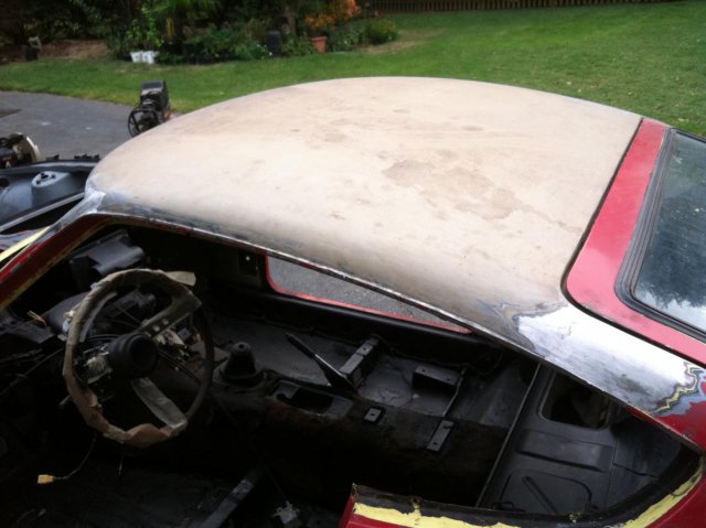

End result of a correct roof replacement.

I don't know what that picture is of, but I just cut a roof off and took it to a Z shop when it didn't sell because it was in such good condition that I couldn't let it go to scrap. If you cut say 4" down on the A pillar, there are no layers inside. I don't remember a lot of layering in the rear pillars either.  I cut them below the lead in the rear.

When I bought the A-pillars for my Z from John at Betamotorsports, they have 4 layers inside them as well. I needed the outer layer just above the door opening, which I was able to laboriously remove after drilling out 22 spot welds...on my 1972 and on the 1975 donor A-pillar, the structure is square-ish with a triangulated brace going from the front of the windshield side to the back outer of the door side, sandwiched in as part of the rain gutter.

Nix has the proper repair procedure.
The pillars are layered, and structural, unlike the roof.
To properly lay beads in the pillars, you need progressively larger sections to access the smaller cuts in further. For the efort, Nix's method isactually faster! i made that mistake ONCE and won't repeat it.
The reason people ageing a car cut the roof is the cage becomes the structure... Most builders actually just cut an access hole in the roof corners to complete the tubing for the cage close to the roof. Or they skin it like Nix documents.
It's not really that big a job to skin a roof or door compared to the A-Pillars. And the caveat on registration in some states is a valid point. There was legislation in response to hack shops that section a roof, weld it back on using only the outermost portions of the pillar, and have tragic results in an accident.

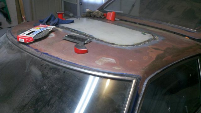

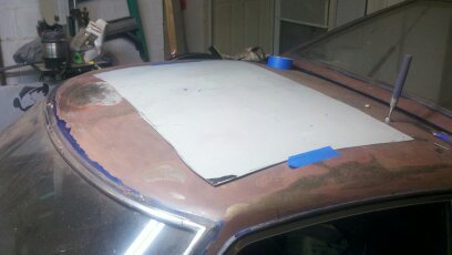

I have to ask, why is it an issue to just patch the hole left by the sunroof? Are you guys worried about not maintaining the arch of the roof or the possibility of 'oil canning' or is there a structural issue?
 I removed the old sunroof, complete with the alien sticker, cleaned up the hole itself and the surrounding metal and then traced a pattern on poster board. I then transferred the pattern to the doner roof in the same position and cut it with a little room to spare. I then carefully trimmed the patch to a consistant 1/32" gap and tacked the piece in. I completed the weld,just tacking and jumping from place to place to minimize heat build up. After completing the weld I sanded most of the weld reinforcement and did some initial hammer and dolly work. It still needs some additional sanding and hammer work but looks like after some minor filling and blocking it should come out fine. I am going with a matte or flat paint, by the way.
