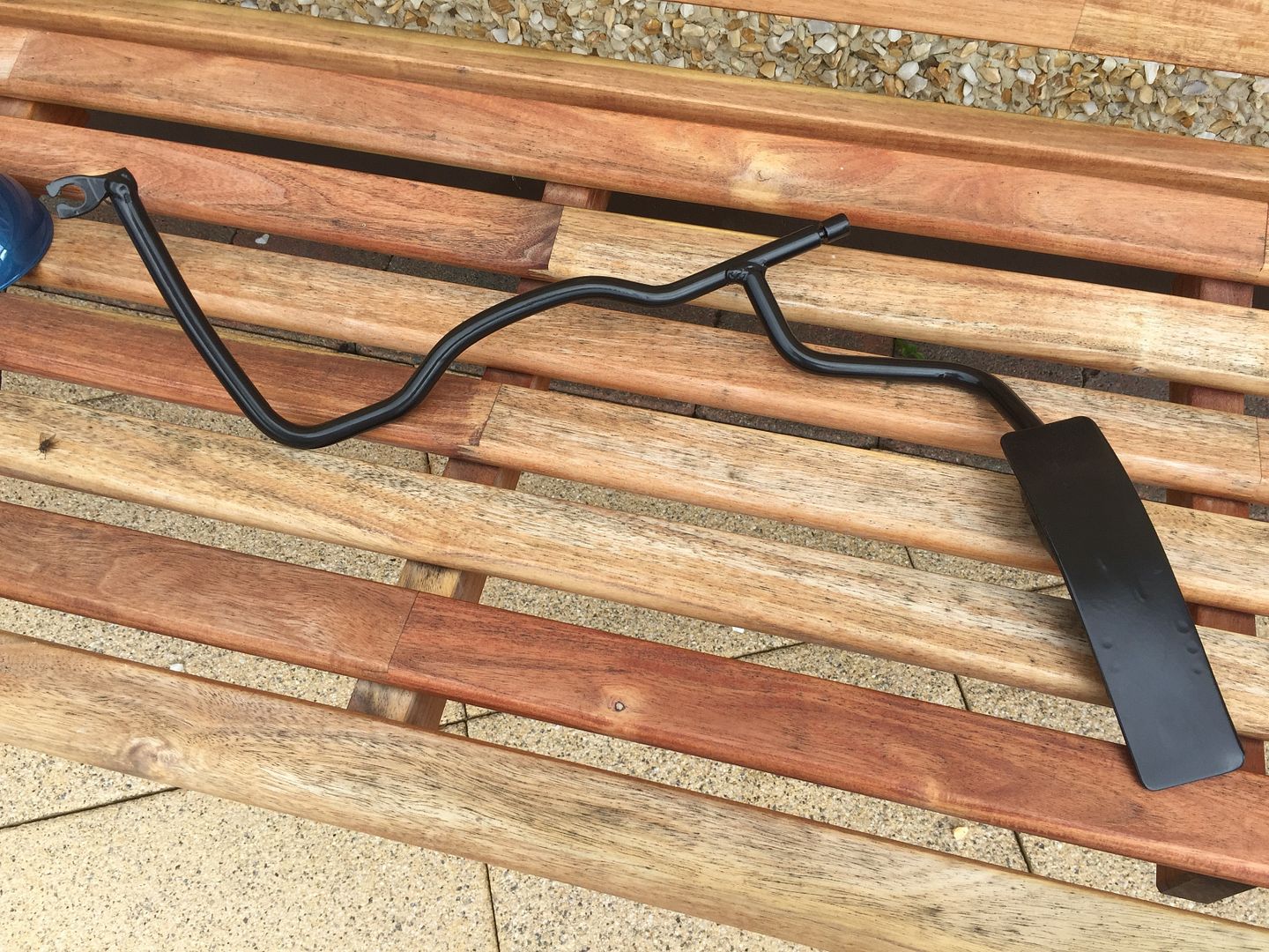

EF Ian Posted August 21, 2019 Author Share Posted August 21, 2019 Apologies for the photo sizing for the next few posts, I have now adjusted it for future posts. So, since I can't help with the body restoration (still waiting to get blasted anyhow) I've been doing what I can with the parts I have with me. Starting with the starter: Then the propshaft, I thought this was going to be an easy job, but there was rust under the paint so I had to take it all back to bare metal: Thottle Pedal. Unlike the other items I decided to have this one powedercoated. Going to be updating to this Honda wiper motor as the original one is a bit lame: I'm not putting something looking like that in my restored car though. Thats better: Some parts only needed a clean: Quote Link to comment Share on other sites More sharing options...

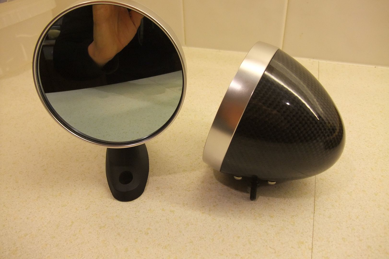

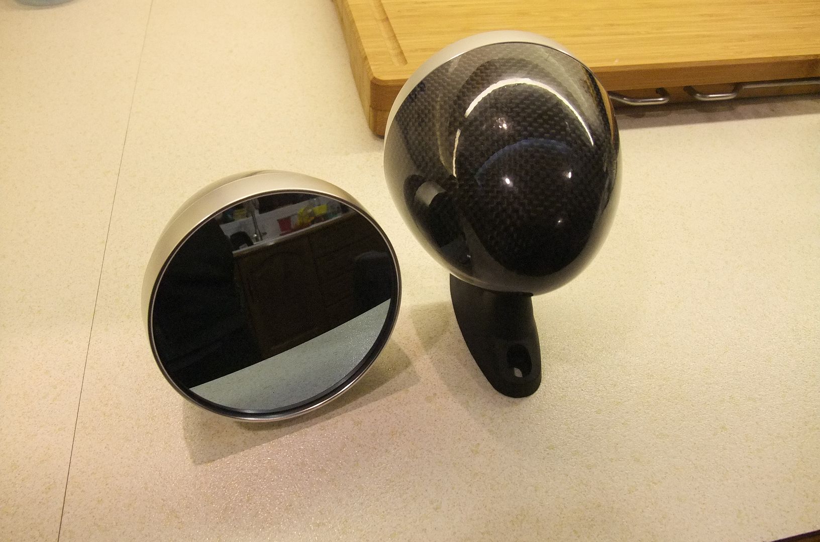

EF Ian Posted April 22, 2020 Author Share Posted April 22, 2020 I decided to change my mirrors, this will take them off the doors and clean up the bodylines more, I'll not be using the bracket that they come with, I will be machining up an alloy bracket to mount them to the window frame. Work has begun Some photo updates: Plenty of hidden rust so I am glad its all being removed properly from all the hidden areas. Quote Link to comment Share on other sites More sharing options...

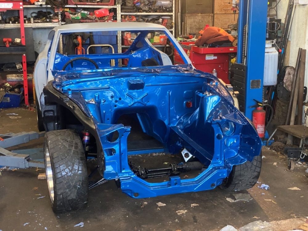

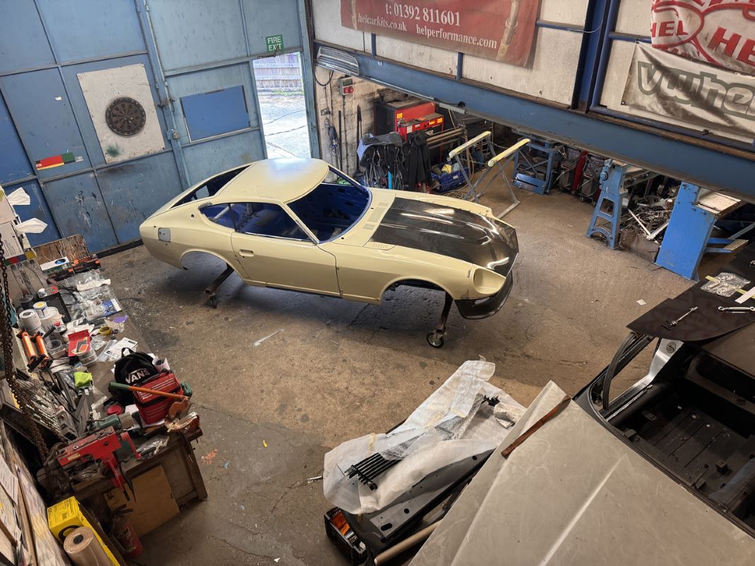

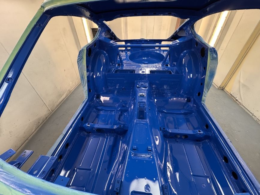

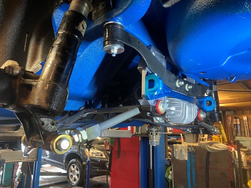

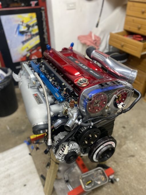

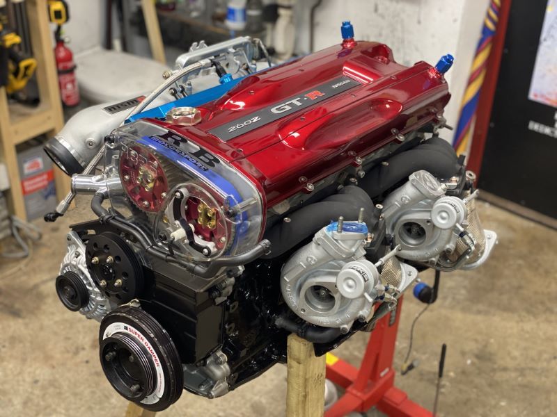

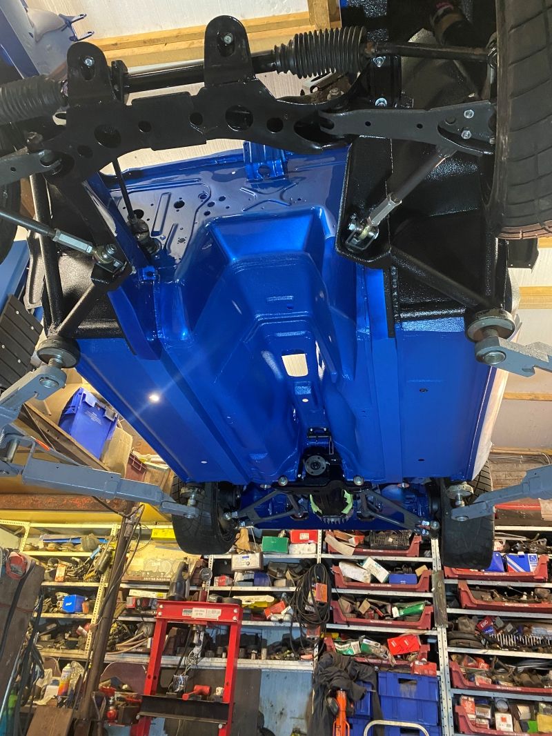

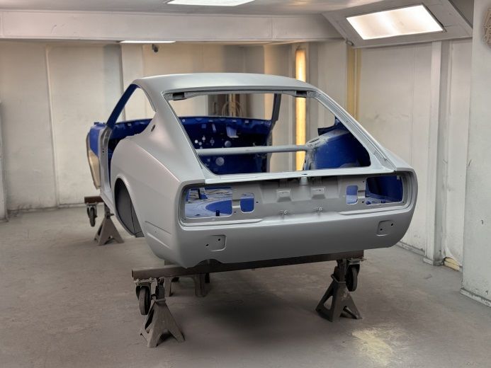

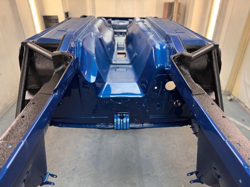

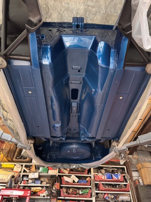

EF Ian Posted March 31 Author Share Posted March 31 Work on this has continued: I went over the whole engine, looks great now: All metal work was finished Most bodywork was finished # Interior Painted Engine Bay Painted Underbody Painted Back on its wheels Full body will soon be in paint. 2 Quote Link to comment Share on other sites More sharing options...
