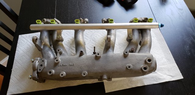

Zetsaz Posted May 1, 2018 Author Share Posted May 1, 2018 For those who didn't see my other thread on porting/cleaning questions I got a non-egr N42 intake! Making it a mini-project while I'm in washington. In other news, I'm always curious about finding japanese examples of S30s, but it's difficult to find anything other than what the major US car magazines put out. I ordered this magazine from Japan to satisfy my curiousity (no overnight parts from Japan here... took a little over a week and I thought that was surprisingly fast). It's interesting to see that US magazines place high emphasis on fancy photos and the writing, at least from my perspective as someone with a college degree who teaches for a living, is generally mediocre. This japanese magazine/book on the other hand has almost the same shots of every car and all of them have the more unique engine mods detailed as well as exact wheel/tire specs for every car. This thing is very nice is close to 200 pages, more than half of them being 1 page features of different S30s printed on thick photo/magazine paper. If you're curious how I'm getting any info out of this... I'm not. Bixby vision on my galaxy phone is helping and anything I see that I'm more curious about with it. It's hit and miss, but it's really neat to see this technology develop! Quote Link to comment Share on other sites More sharing options...

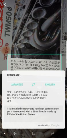

seattlejester Posted May 1, 2018 Share Posted May 1, 2018 Ooh neat, If you want anything translated let me know, the kanji takes a while since I'm not native, but I can struggle through the hiragana and katakana and have the automotive perspective to put things in context. Gotta get your Z out here Quote Link to comment Share on other sites More sharing options...
Zetsaz Posted May 1, 2018 Author Share Posted May 1, 2018 1 hour ago, seattlejester said: Ooh neat, If you want anything translated let me know, the kanji takes a while since I'm not native, but I can struggle through the hiragana and katakana and have the automotive perspective to put things in context. Gotta get your Z out here Oh, definitely would be nice! And the Z is definitely coming up here this summer! Dad has already been meaning to come up and visit, so we came up with a plan for the end of the summer. I'll have to have most of the drivetrain, at least the heavier bits, bolted to the new shell, but the plan is to rent a trailer and pull the car up here with my dad's Tahoe on my way back this summer while my dad comes to visit this part of the country. Need to make sure I get rid of that other shell first otherwise my roommate will hate me haha. Quote Link to comment Share on other sites More sharing options...
