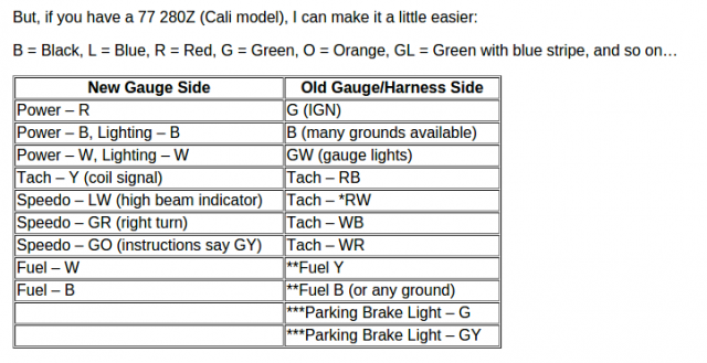

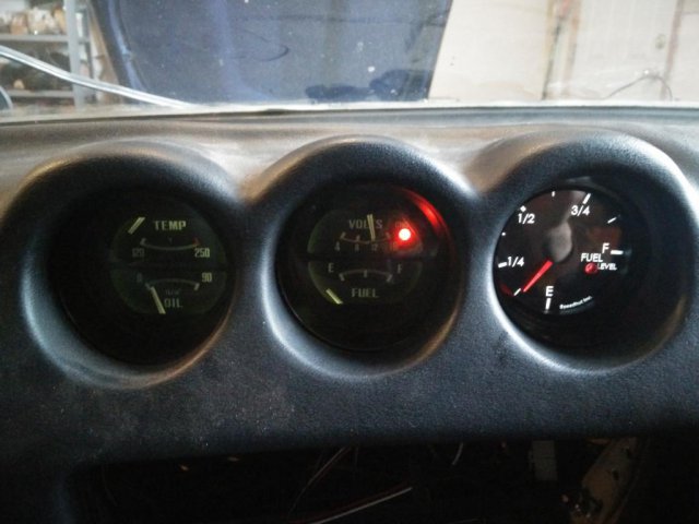

Zetsaz Posted December 21, 2015 Author Share Posted December 21, 2015 (edited) Alright... so I'm trying to wire this Speedhut gauge and it's giving me a serious headache. EDIT: Problems resolved. For those curious I used the write-up by BLOZ UP here: http://www.nearwood.net/280z-speedhut-gauge-conversion/#more-336 The biggest help was this. This is specifically for a '77 but the wiring in my '76 is similar. I haven't soldered the black and white sender cables to the original connector yet, but the rest for lighting is working and soldered. The sender harness is really long, so I might just run it directly back to the sending unit, especially since I have that F-Body tank and sender. Might as well eliminate any extra unnecessary connections from stuff I've removed. Currently figuring out how I'm gonna mount this thing to look mostly stock. Edited December 22, 2015 by Zetsaz Quote Link to comment Share on other sites More sharing options...

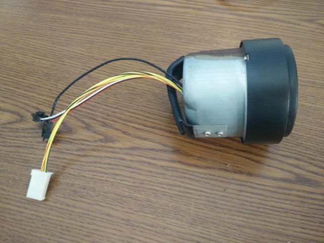

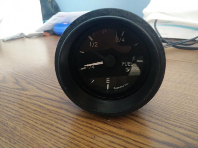

Zetsaz Posted December 23, 2015 Author Share Posted December 23, 2015 Gauge wiring is all done. Burned my pinky on some soldering (still stings). Routed the speedhut harness along the stock harness, will double check length later. It's about ready to go with one exception... the sensor contacts on my gm sending unit were screwed up, tried fixing it and only made things worse. From what I've read, it's not uncommon for the contacts to fail, so I might as well fix that while I'm finishing up the fuel gauge. Will update later with a short video on how I fit the 2-5/8" gauge into the stock pod to look mostly original. Quote Link to comment Share on other sites More sharing options...
Zetsaz Posted December 28, 2015 Author Share Posted December 28, 2015 (edited) I was planning on flipping the original clock bezel, with some slight trimming to get the fit I wanted, but it actually won't slide into the back half of the housing if you flip it. I ended up cutting a ring from the same cardboard the gauge was shipped in and fitting it between the lock ring and the adapter to create a friction fit into the back of the housing and just placing the front half back on. Down the road when I'm replacing other gauges I might make a new ring for the friction fit. This is working well for now, but the friction fit isn't nearly as tight as I'd like because I went overboard and cut the cardboard down a bit too much. The wires on the new gauge are routed through the same hole the original backlight would have been in. I just removed the light then the green dome. Cut into the metal just a bit with some tin snips so the wires wouldn't be bending so much and so the wider connector for the new harness would actually fit through. Extremely easy. Tried to match the original font and coloring as close as I could, so I went with black back, white tics, and a white needle. Needle will light up red however. Just liked it a bit more. Sensor contacts for the sending unit in the fbody tank also arrived and work incredibly well. Much beefier and durable looking than the originals. Part is GM64 Fuel Sensor Contacts for those curious. Edited December 28, 2015 by Zetsaz Quote Link to comment Share on other sites More sharing options...

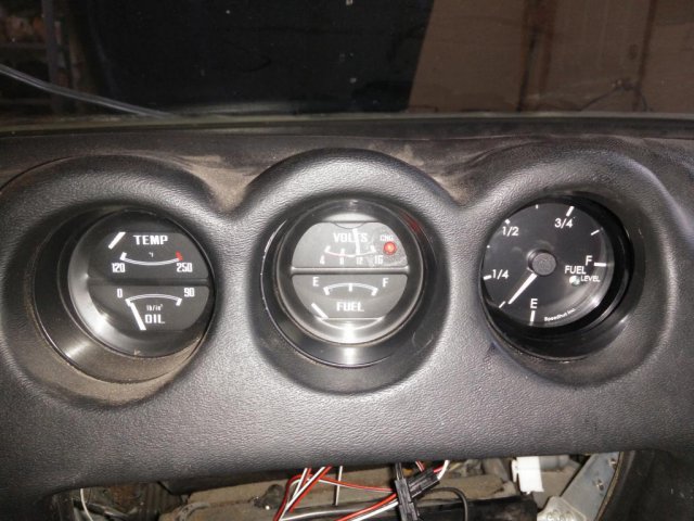

Zetsaz Posted January 10, 2016 Author Share Posted January 10, 2016 Routed the new harness through the body. Not long enough to reach right were the original one is, so I ended up routing it behind the passenger seat then under the console to the gauge pod. Here's a few pics of how I left it before coming back to Washington. After seeing one of Dave's autometer gauges here in town, I'm actually really happy I went with the Speedhut. Quality feels much better I think they look nicer overall. This also got me connected to some 240z style turn signals which is really the look I wanted on the front end of the car. I'm really heavily leaning towards the fiberglass type 1 air dam. I like this front end look. But I'm slightly concerned about damaging the fiberglass since it's not flexible. Might just wait until later to make an air dam decision. Quote Link to comment Share on other sites More sharing options...
