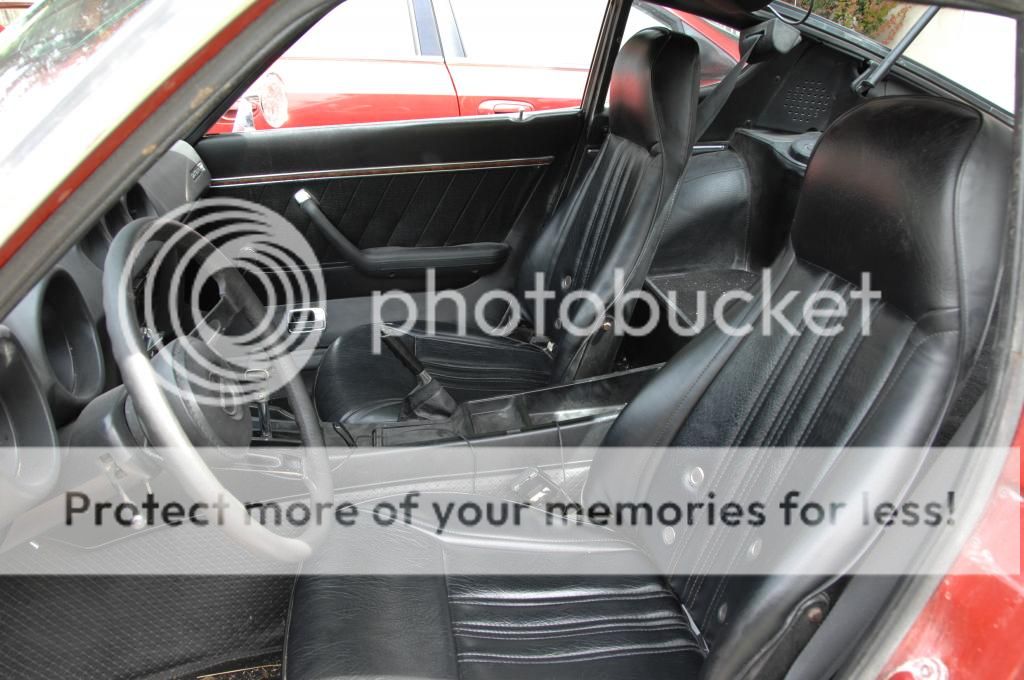

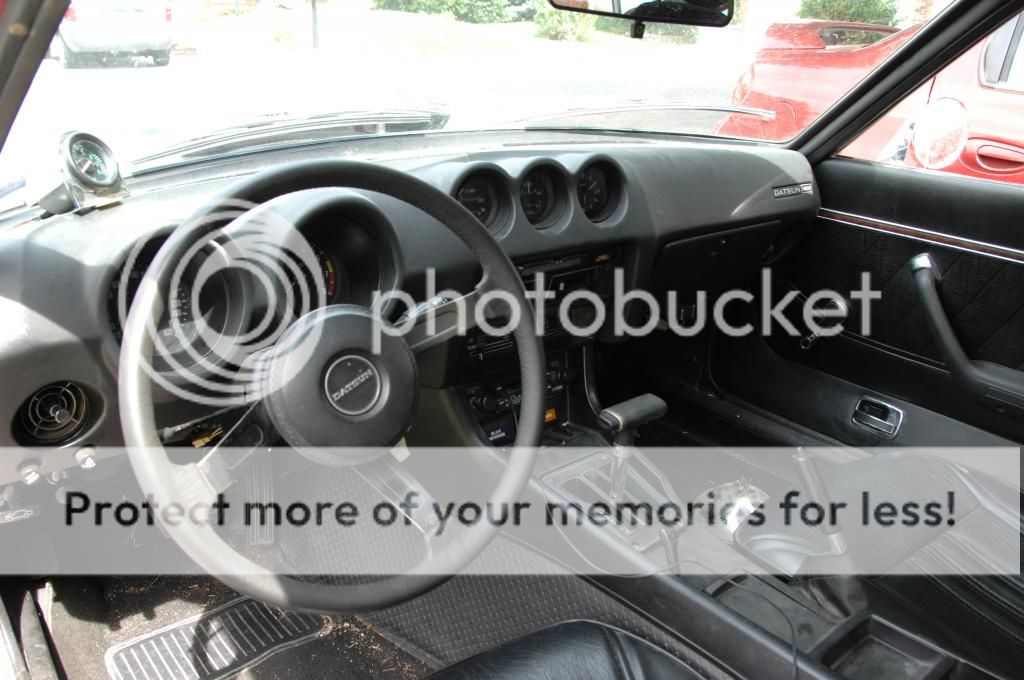

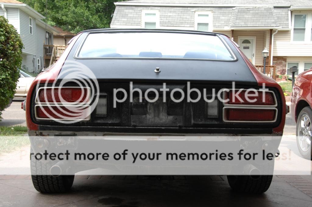

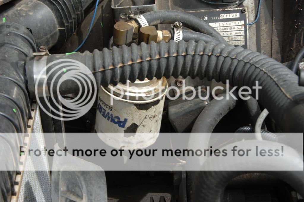

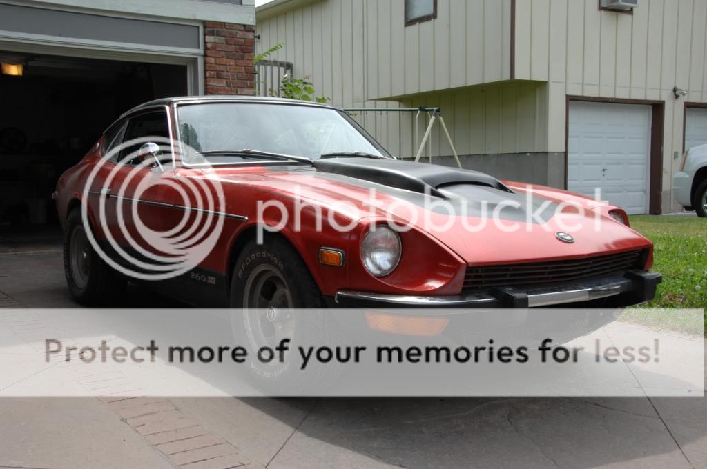

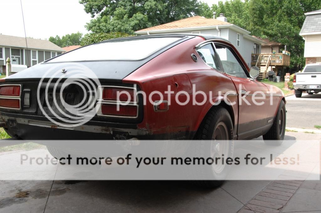

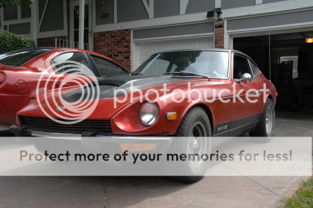

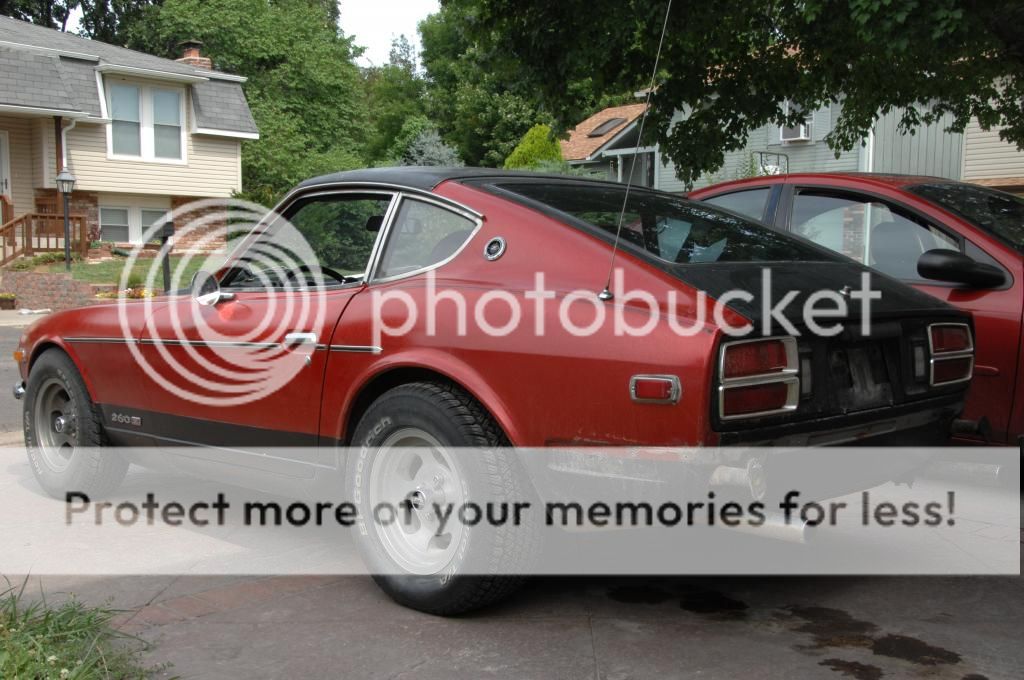

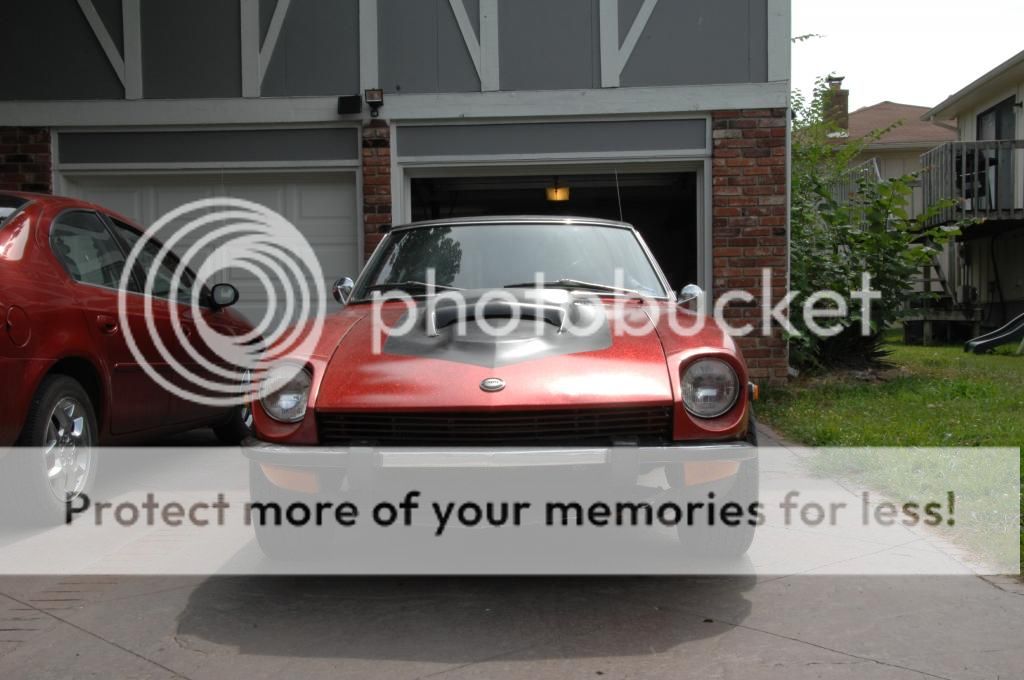

Good news! The car didn't get sold to someone else, they called me back Saturday morning and asked if I still wanted it. I drove out later that day and picked it up. It was a nearly 3 hour drive each way and the car very nearly made it in one piece. I noticed that the engine was running warm, at least over 200 degrees, and stayed there. I filled it up with gas two times on the way back, on the second fill up it started up then died from vapor lock, as the fuel filter was dry as a bone. After I let it sit and cool down it fired right back up, and we were on our way again. After another 10 minutes on the highway, it ended up tossing the water pump and alternator belt. It may have been a bad or gummed up pump that was causing it to run hot, so that will be replaced very soon. I brought a buddy and a truck with me though, so we towed it back to my house the rest of the way and it's now sitting pretty in my garage.
I have some pictures I took this morning of the still dirty car, I haven't had a chance to wash it yet and the previous owner lived on a long gravel road. It used to be a show car in Chicago, and it came with some trophies won by that owner, as well as some shop manuals and a couple of extra headlights. Here's the pictures!

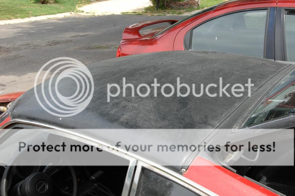

It is a vinyl top 260z, I didn't even know that these were made. I guess you learn something new every day. It's in very good condition all around, almost zero rust anywhere. The bottom and frame rails were undercoated by the owner in Chicago, the guy who used it as a show car. He also painted the car with it's current livery and it appears he used the car's weight in flake. It's a little too "bass boat" and not enough "bad ass" for my taste, but that will change with time.
Edited by BluSkyLightning
"Bass Boat" or "Bass Master Z"? The Compton Z-Posse had a purple metalflake Fairlady Z in it that was similar.
"Bass Boat" hahaha, yeah, that's about the only place you will find flake like that outside of a Sno-Globe these days! LOL
BTW, the Vinyl Top was a port or Dealer Option. I bought a white with Maroon Vinyl Top 73 240Z for parts after an accident.
I can deal with the two-tone on those lines. But the Vinyl....'abomination' comes to mind! LOL If it's in good shape, it's worthy of keeping, but if it's peely.....KILL IT! KILLLLLLLL IT! hahahaha
Is there anything needed to peel it off? I would honestly prefer a single solid color, but I'm not sure what all would be required to remove the vinyl. Is it just glued down?
The top itself is black and appears to be in good shape. I am planning on painting the car in the future though.

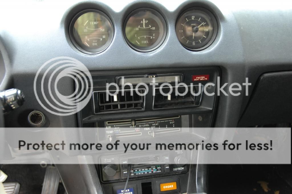

May or may not matter, but most 1976 cars have a voltmeter, you have an ammeter.  Maybe it's an early 76, or it's actually a 75.  Avoid some wiring confusion in the future.

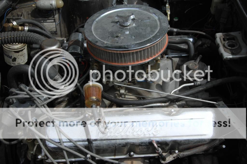

It looks like the Jeep market is really driving your engine options.  They all look pretty tall though.  http://www.tuffdawgengines.com/AMC.htm
