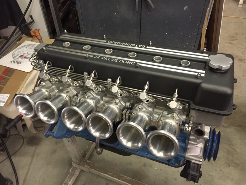

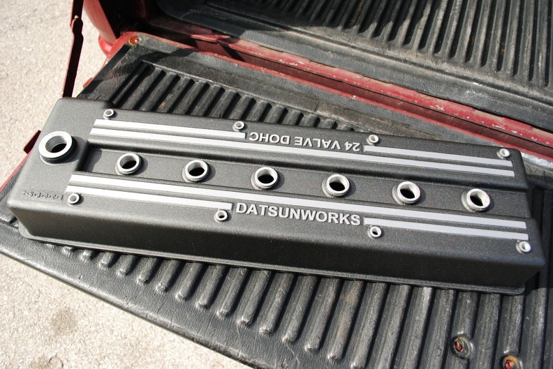

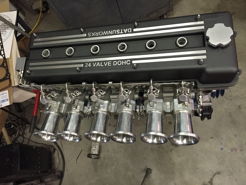

Derek Posted January 19, 2016 Author Share Posted January 19, 2016 (edited) Got some pics from the powder coater. It looks like they did a great job. I used http://www.powder-coated.com in Orlando. I'll post more when I get it back but I'm really happy with the look. I want this in my car right now:) Edited July 7, 2017 by Derek Quote Link to comment Share on other sites More sharing options...
supernova_6969 Posted January 19, 2016 Share Posted January 19, 2016 that looks FANTASTIC. good colour choice. man.. really really nice... that fact that the firing order numbers are dark makes them stick out less, which hides the spacing problem.. good idea. Quote Link to comment Share on other sites More sharing options...
ryant67 Posted January 20, 2016 Share Posted January 20, 2016 Beautiful! Quote Link to comment Share on other sites More sharing options...
Derek Posted January 20, 2016 Author Share Posted January 20, 2016 (edited) Well it looks even better in person! The acorn hold down nuts are a little small. I'm going to have to work on that. I'm really happy with the quality of the powder coating. Ivan at http://www.powder-coated.com/ did an amazing job. Fast turnaround and great communication. Well now that I have it back I can measure up and order the plug wires. Getting down to the nitty gritty at this point. Edited July 7, 2017 by Derek Quote Link to comment Share on other sites More sharing options...

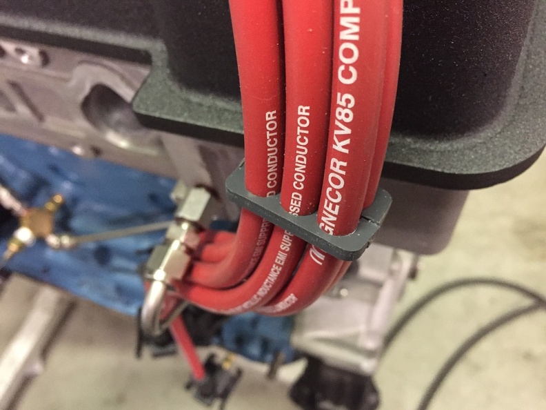

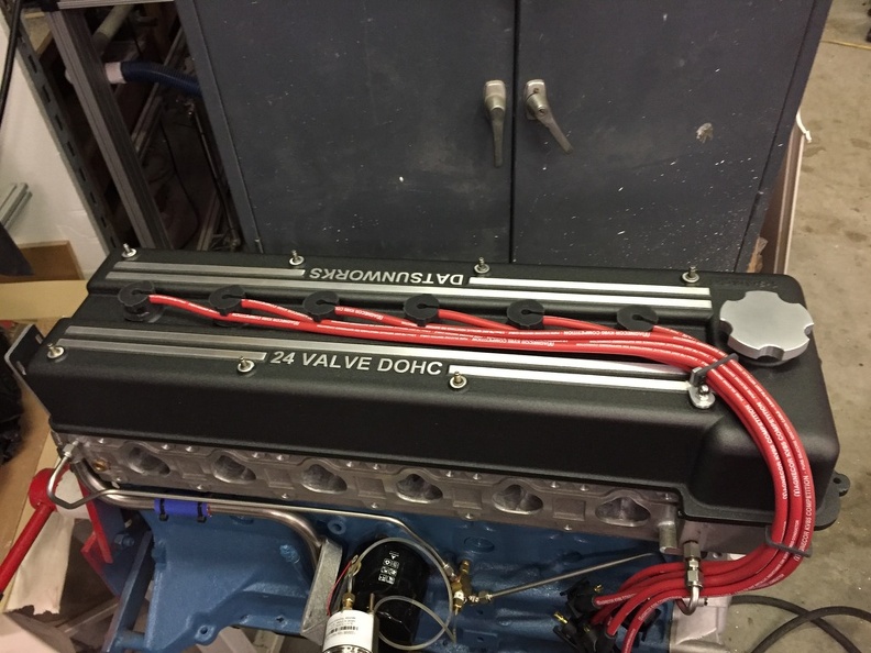

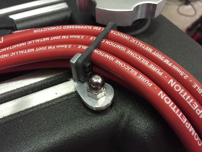

Derek Posted January 28, 2016 Author Share Posted January 28, 2016 (edited) Got my plug wires from Magnecore. Great work as usual. Made some custom looms out of grey type 1 pvc. The EDIS coil mounts up under the front intake manifold so for the most part it should be hidden. Edited July 7, 2017 by Derek Quote Link to comment Share on other sites More sharing options...

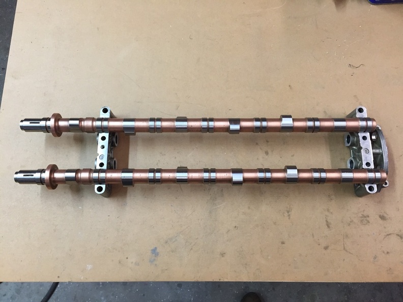

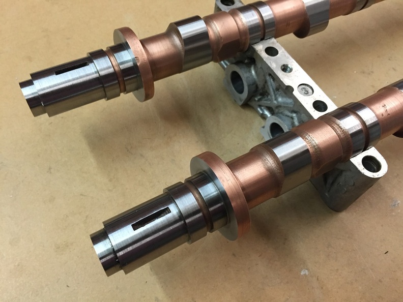

Derek Posted January 28, 2016 Author Share Posted January 28, 2016 (edited) Camshafts are in the house! Or rather the shop. They look great and everything measures out. I stripped the rockers from the towers and mounted the cams up in the head. It was snug but I could turn them. Not by hand but with a wrench on the flats it moved very easily. This was a big concern of mine from the beginning but I think it's going to be ok. Now I can start on the cam gear adapters. Edited July 7, 2017 by Derek Quote Link to comment Share on other sites More sharing options...
