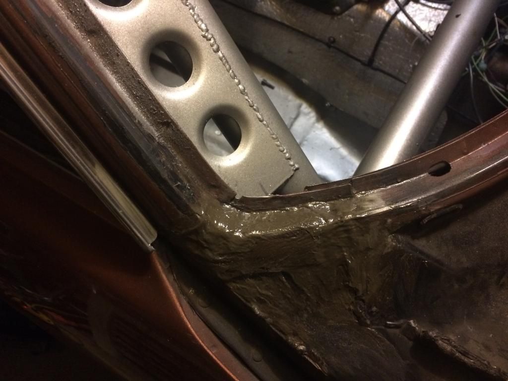

heavy85 Posted January 29, 2015 Share Posted January 29, 2015 (edited) I've had crack in each lower corner of the windshield for years but it 'seemed' to just be the lead and small so never really worried about it. Have windshield out from building the cage and noticed now two cracks in each corner and the newer ones seem to be growing fast. So decided to excavate and found this. Suck. The lead is really deep there which surprised me but now how does one safely and completely remove the lead so the cracks can be weld repaired? Cameron Edited January 29, 2015 by heavy85 Quote Link to comment Share on other sites More sharing options...
JMortensen Posted January 29, 2015 Share Posted January 29, 2015 (edited) I seem to remember removing it with propane torch and wire brush. Might have been MAPP. Been a while. Used to autox with a guy who snapped the A pillar right off at the cowl there. He reinforced, welded it back on and reinstalled the windshield and never had anymore problems. Edited January 29, 2015 by JMortensen Quote Link to comment Share on other sites More sharing options...
Sam280Z Posted January 29, 2015 Share Posted January 29, 2015 As JM said, a propane torch and a wire brush will do it. Sam Quote Link to comment Share on other sites More sharing options...
socorob Posted January 29, 2015 Share Posted January 29, 2015 Also drill a small hole at the end of the crack to relieve it. Quote Link to comment Share on other sites More sharing options...
johnc Posted January 29, 2015 Share Posted January 29, 2015 FYI... that crack probably existed before you put the full roll cage in the car. I don't think it will continue to propagate now that you have the cage. As Jon said, a torch that gets to 800F and a wire brush. Wear a breather and eye protection. Quote Link to comment Share on other sites More sharing options...

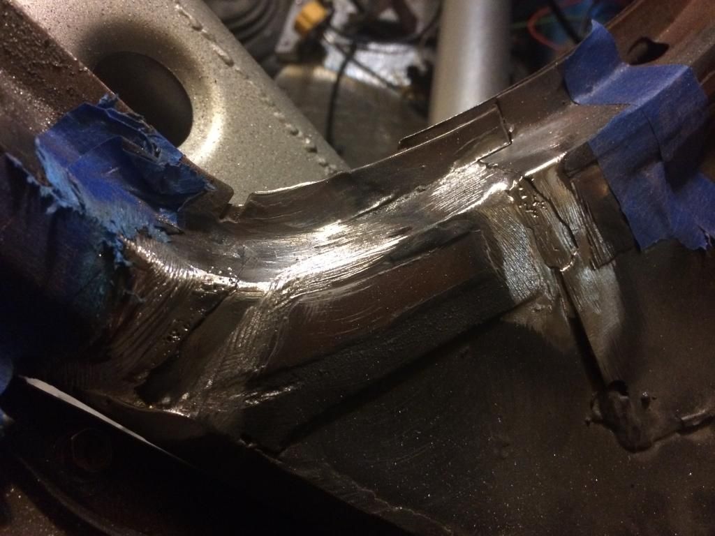

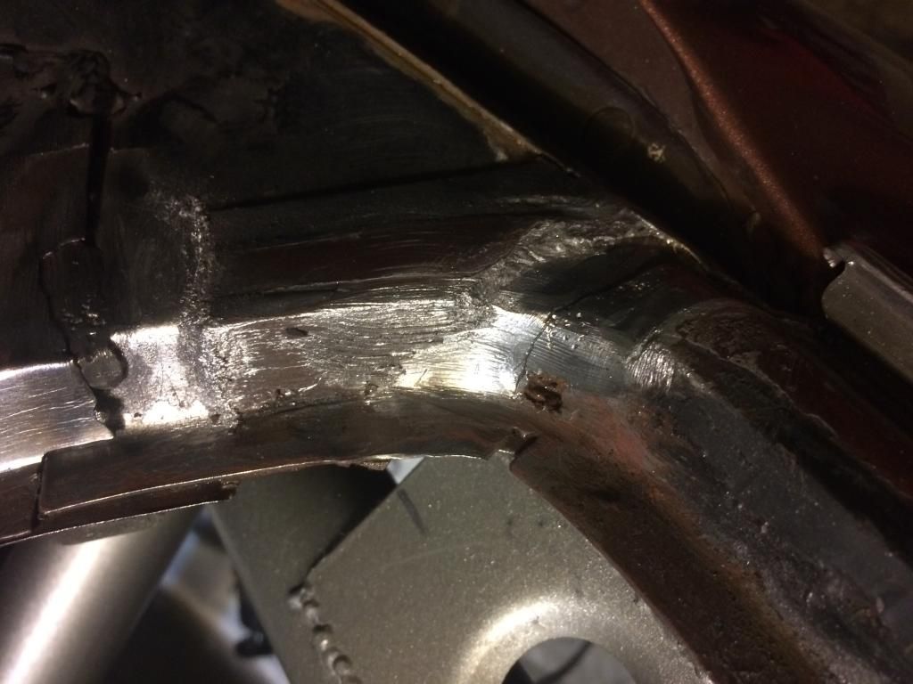

heavy85 Posted January 30, 2015 Author Share Posted January 30, 2015 It was easy to melt out with small propane torch and wire brush. Found two potential root causes. The crack to the left is because of poor panel fit-up - there was from factory ~1/8" gap between the two panels. The crack to the right seemed to be tied to the rust hole. That rust hole was completely hidden by lead so on the surface there was no visible rust. Welded up Kitty hair filler Now just need to sand/bondo/paint then get back to preciously scheduled programming. The left side crack is very small in comparison so I think Ill just leave it alone. Quote Link to comment Share on other sites More sharing options...

LLave Posted February 2, 2015 Share Posted February 2, 2015 Hope your whole cage is not welded like that dimpled panel is. Yikes. Quote Link to comment Share on other sites More sharing options...
heavy85 Posted February 3, 2015 Author Share Posted February 3, 2015 Hope your whole cage is not welded like that dimpled panel is. Yikes. Wierd the picture does make it look kinda sketchy but it is not. Welding 18 gauge to 0.095 is a challenge. Ended up turning up the heat then lots of little short welds just for the gussets. Having done this before then cutting it up later I have no concerns. Quote Link to comment Share on other sites More sharing options...
