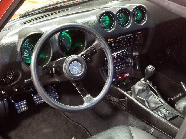

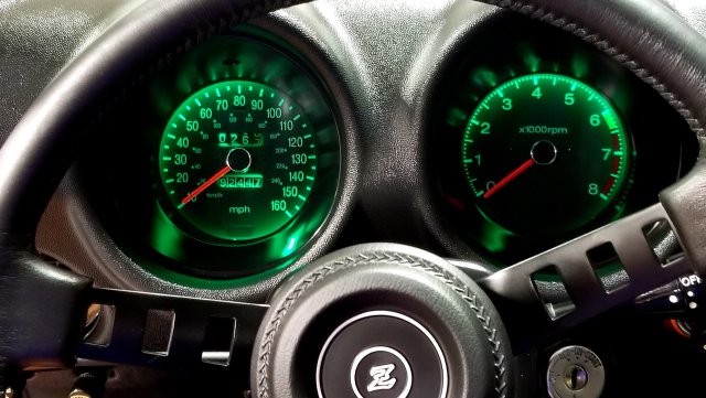

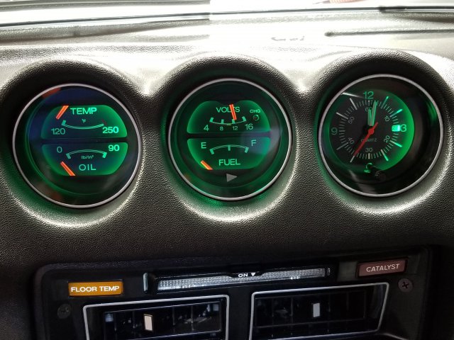

In an effort to dial back the "mod" in "resto mod" in the cabin and bring back a bit more of the vintage look I went back to green illumination on my dials (still LED, of course), and threaded my original shift knob to fit the slightly thicker short-shifter shaft. Along with the Datsun Comp steering wheel I had already changed a few weeks back I think everything comes together nicely now and looks more like a stock '78 280Z.
Edited by dmoralesbello

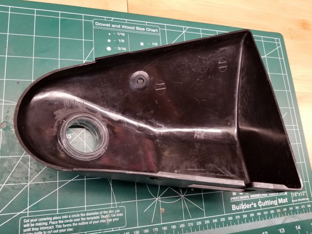

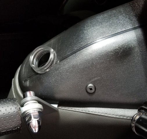

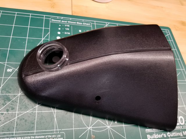

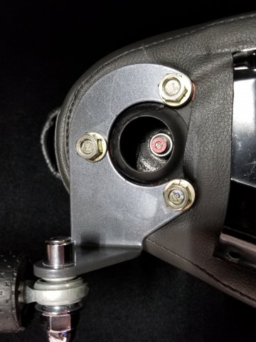

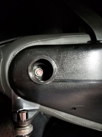

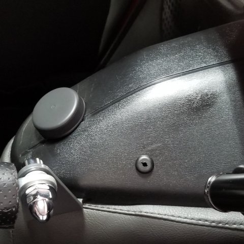

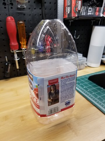

After playing around with my suspension setup and changing my mind a few times as to setting the dial on my  adjustable Tokico Illumina struts, I got tired of broken and lost retaining pins for the strut tower covers and decided to fabricate an easy access port for the dial on the top of the rear strut. I used a 2.5" diameter screw cap and "neck" from a juice bottle (hard clear plastic) and adapted it to the strut tower cover. Took about an hour total time (and drinking tons of cranberry juice) but I can tune in my rear struts as easily as my fronts now.

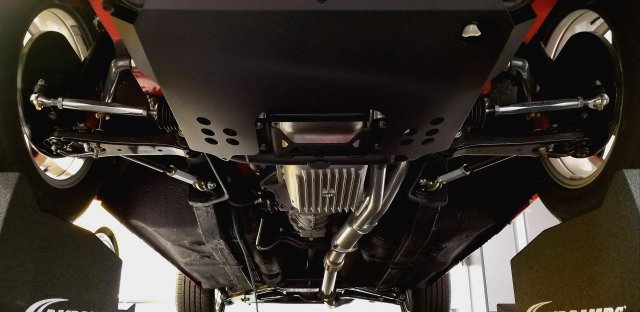

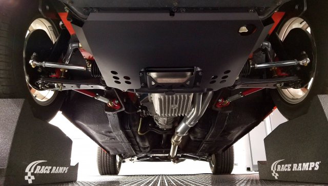

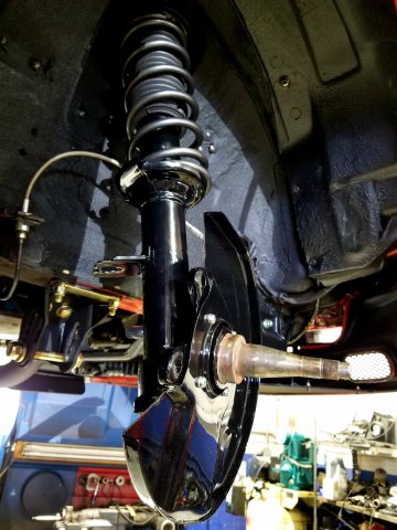

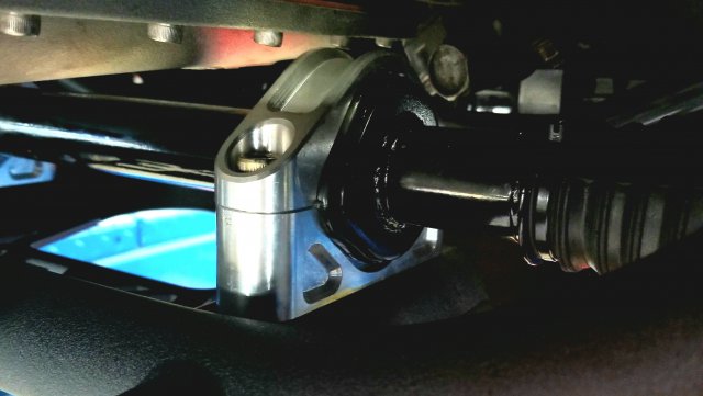

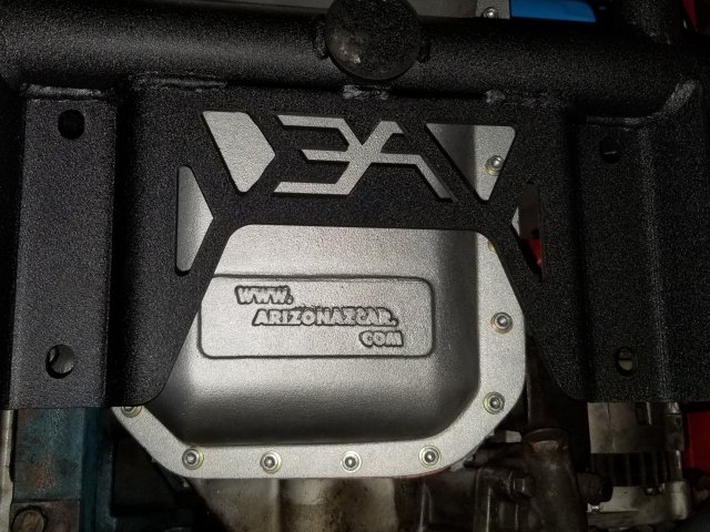

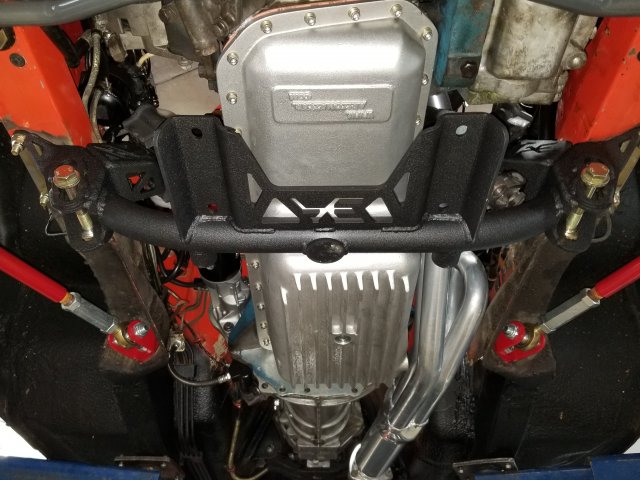

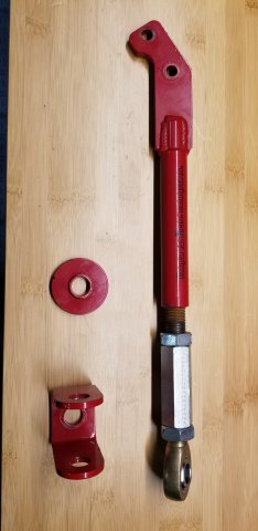

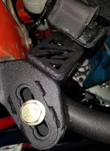

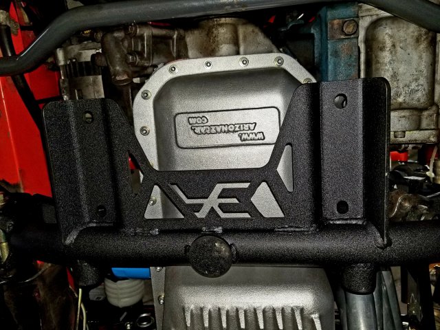

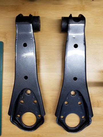

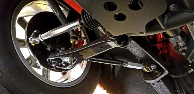

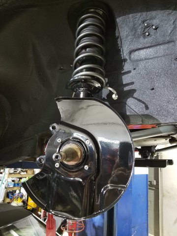

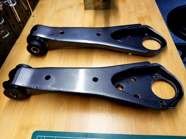

I'm in the middle of a major upgrade to the front end: changing the stock front cross member to a beautifully designed tubular unit from Apex Engineered and a cast aluminum oil pan from Arizona Zcar. Still to come are  refreshed (media blasted and powder coated) control arms and strut housings, rebuilt steering rack and a new SS powder coated splash pan. In a couple of weeks I should also be getting new steering knuckles form Apex.
Here are some pics of the job so far.
Link to comment
  • 2 weeks later...
The front end work is complete: Tokico Illumina struts, Apex Engineered front crossmember, tie rods and steering knuckles, Arizona Z car aluminum oil pan, T3 tension rods, MSA anti away bar, rebuilt steering rack, Z Car Depot splash guard, powder coated stock control arms, strut housings and brake dust shields. Come to think of it, that was a lot of stuff!
All the components went together well with the exception of the stock control arms which had to be "shaved" at the back so as to go properly into the new crossmember. Although they're all from different companies we were able to align the car without any problems.

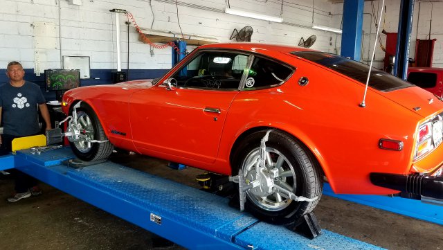

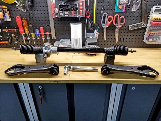

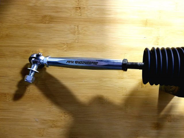

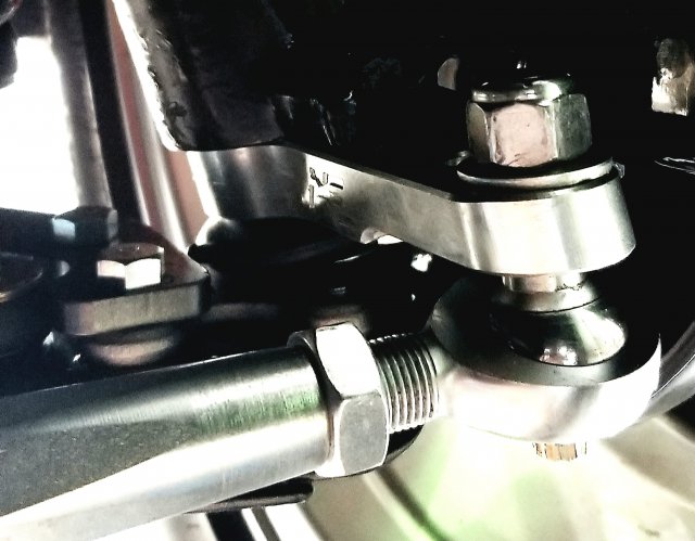

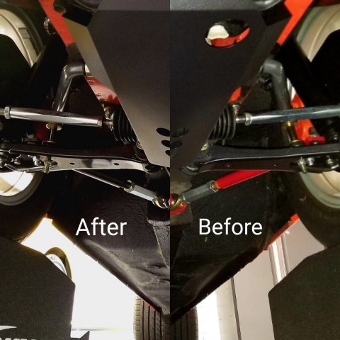

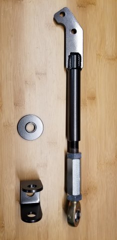

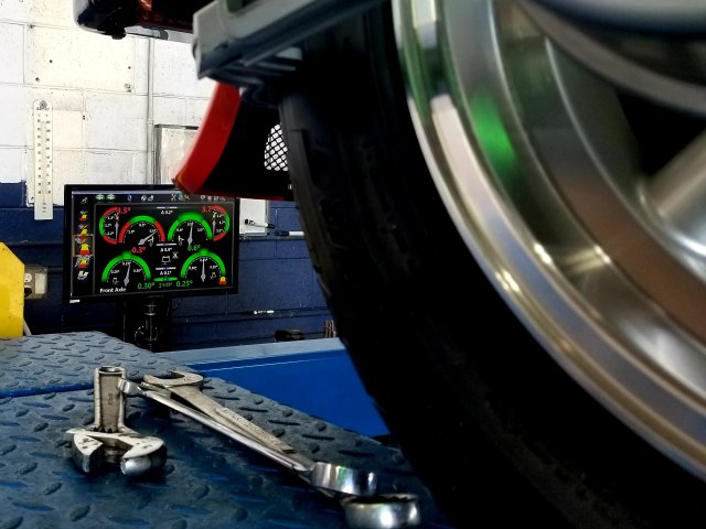

I think I'm getting to the point where all I've wanted to do to my Z has been done! I know it's hard to believe but I can't think of anything else. Of course, things are prone to breaking in a 40 year old plus car and I will surely be repairing whatever comes up.
I had been waiting for about 8 months for a couple of back ordered parts from Apex Engineered, namely the top brackets for the steering rack and the close ratio steering knuckles. Got those in the car yesterday and I spent the morning getting the car aligned again (perfect job by Mel's Reset here in Miami). Everything seems to be sitting in the right position, car drives and brakes straight, no tire rubbing, great steering response with much tighter feel. Very happy with the felt differences after installing these parts.

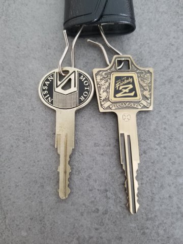

I got my hands on a JDM key "for Fairlady Z" made by Royal. The company apparently has not made these since the eighties but Irving Morales in California has a few for sale.
Got it cut today and will become my regular key. Very funky Japanese look.
Here's a pic with the OEM key on the left and the fancy key on the right.
