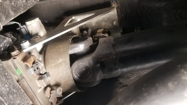

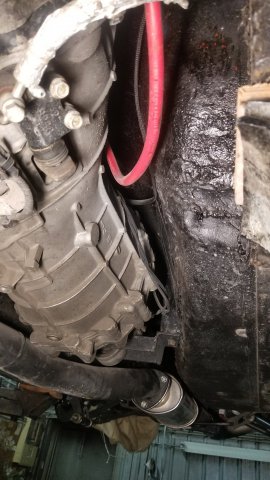

Exposed Posted March 11, 2018 Author Share Posted March 11, 2018 (edited) not the best pictures but i have about 3in of room of either side. the front of the transmission is about 4inch past the firewall. with the serial nine shifter it lines up almost perfectly. Im running an R200 with 3.54 diff, not to sure which one though was put in by the PO Edited March 11, 2018 by Exposed Quote Link to comment Share on other sites More sharing options...
seattlejester Posted March 12, 2018 Share Posted March 12, 2018 Those aren't the stock mounting points on the trans tunnel are they? Quote Link to comment Share on other sites More sharing options...
Exposed Posted March 12, 2018 Author Share Posted March 12, 2018 yes they are the stock mounting points as far as im aware, unless the PO switched something up. Quote Link to comment Share on other sites More sharing options...
seattlejester Posted March 12, 2018 Share Posted March 12, 2018 Wow, I can't believe it lines up so nicely. Thank you for the measurement of the bell housing past the firewall as well that will tell me how far I have to shift my setup for the awesome fitment. Quote Link to comment Share on other sites More sharing options...
Neverdone Posted March 12, 2018 Share Posted March 12, 2018 You think about running a triangular gusset onto from the box portion of your mount to the flat portion of your mount? Right now you can get a decent amount of flex laterally on that bend of the angle iron you used. Boxing that in would prevent a possibly very catastrophic failure. Maybe you're ok, but I'm always more of the mindset of, the only way to do it is to overdo it. Quote Link to comment Share on other sites More sharing options...
seattlejester Posted March 12, 2018 Share Posted March 12, 2018 Wouldn't be a bad idea, but that looks like angle iron that has cross bars welded to it. Those are naturally a bit gusseted, granted the CD009 is a heavy transmission. Quote Link to comment Share on other sites More sharing options...
Exposed Posted March 12, 2018 Author Share Posted March 12, 2018 great suggestion, at the time I just did it quick and dirty so I could drive. Quote Link to comment Share on other sites More sharing options...
