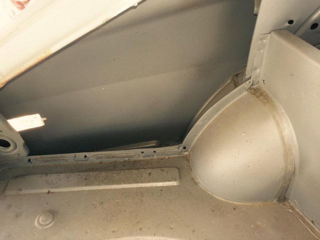

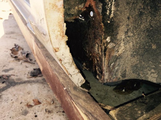

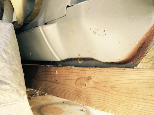

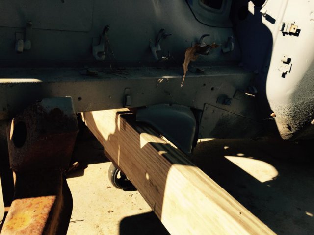

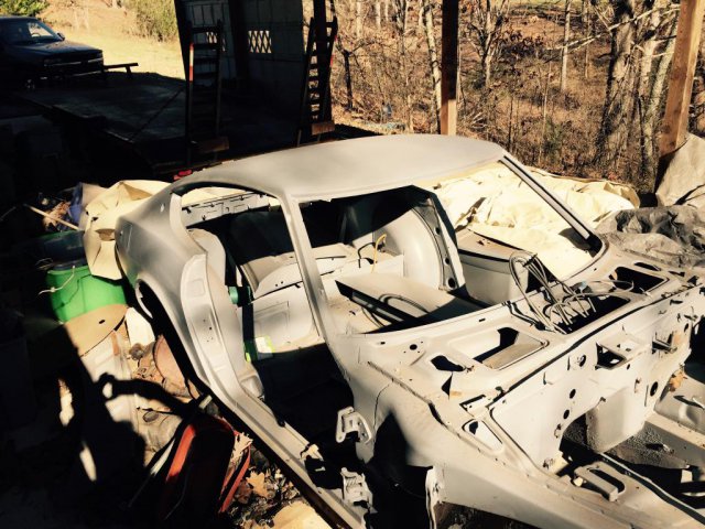

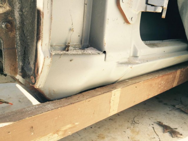

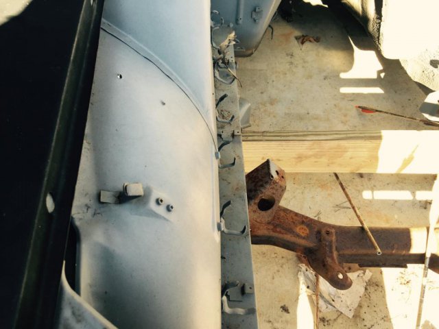

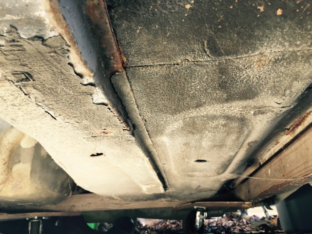

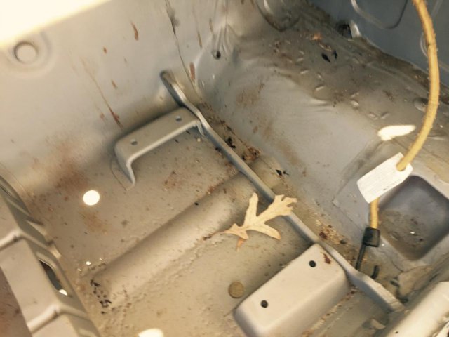

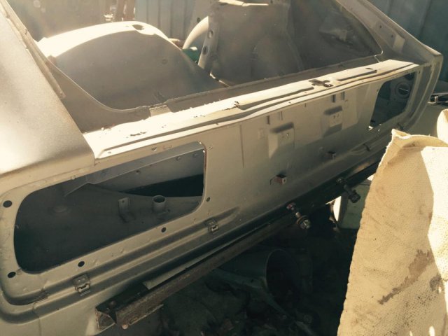

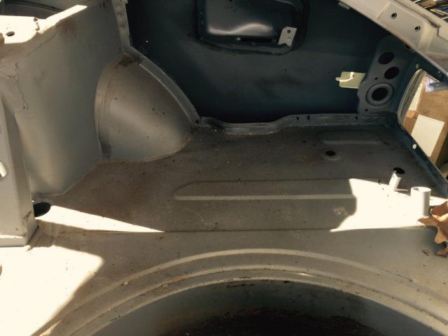

Posted below are pictures of the car that I have received from the seller. I will take more when I go to get it on Friday, and once I get it home and settled in my garage. Please feel free to comment on your thoughts about the car. Yes, it is a shell and its going to need alot of work but everything I have read about with these cars is that in order to have a nice car in the end you really need to start with a "rust-free" car. Thats any old car, be it a MOPAR, Chevy, or Ford. Everything I have seen over the past few months has stressed that fact and I have heeded it. I have passed up multiple other Z cars, both 260s and 280s. I am lucky enough to have found the car below and I believe that I have a great start already. Again, please feel free to offer any comments, tips, advice, or constructive criticisms.

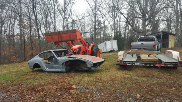

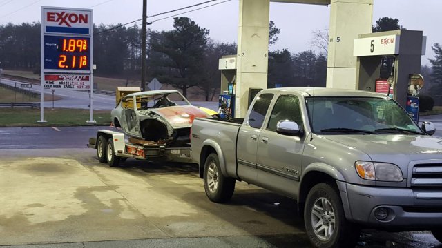

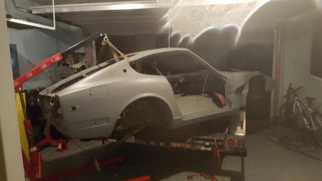

I went and got the Z previously pictured the other day. It was quite the long trip to NC and back, I was on the road over 12 hours, but all went well.
Getting loaded.
Driving home.

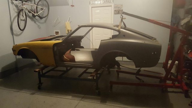

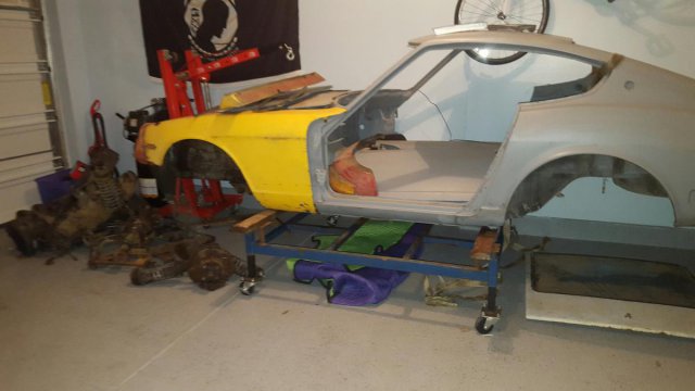

And then here she is back home in the garage. Also shown are all the other parts that I bought off the guy, as well.
Looks like you have a good shell to start with and only some minor metal work to attend to. Though as mentioned, you will have a lot of work to do, you are miles ahead when it comes to the chassis  strengthening stage. By that I mean you have the car stripped already and free of nice paint, which I have seen with some people be the detracting reason as to why they never fortified their cars for the more powerful engine swaps. Document your build as you progress with it. Lastly, $1.89 for regular, Holy crap, it must be nice!!
Thanks for the words of encouragement Nelsonian and PLATA. You mentioned being ahead of the game; this is one of the main reasons that I decided to go with this car. I figured that any car I bought I would tear down to this level. Luckily, I was able to find this car and luckier that it was in really good shape.  Strengthening the frame is one of the first things that I plan on doing. I am still researching how exactly I want to do it. I think that I am going to tie the uni-body together, strut tower bar, and then put in a roll bar. That's my current thoughts as for the strengthening piece.

at the exact moment I go to update. So here goes nothing. The last time I posted on here the car was on a stand and had just gotten home. Now the car is on a

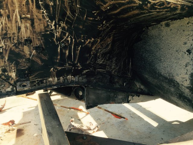

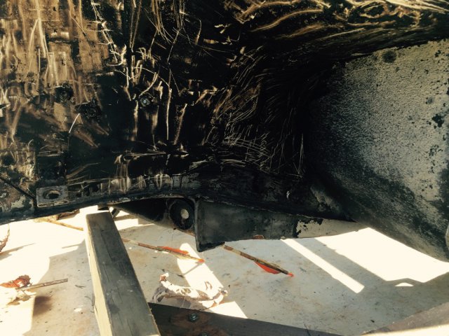

tiptissorie, I got the idea from cruising some VW rabbit forums, and then I found some other people who did it here. Then I started taking off the old undercoating.

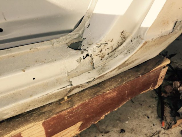

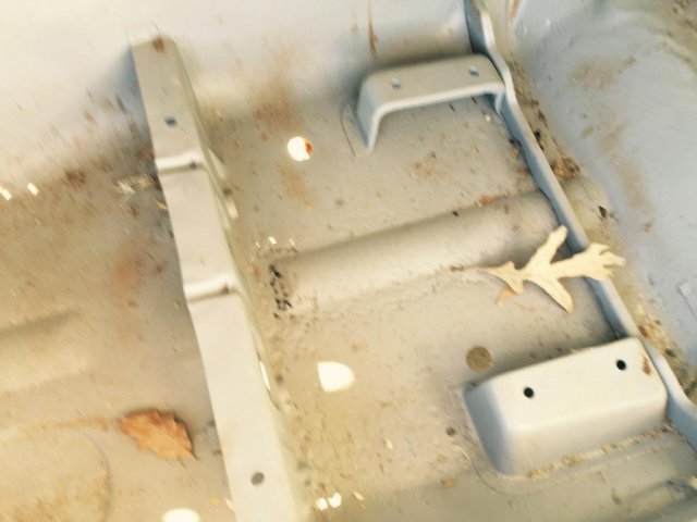

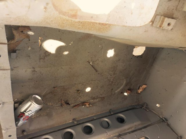

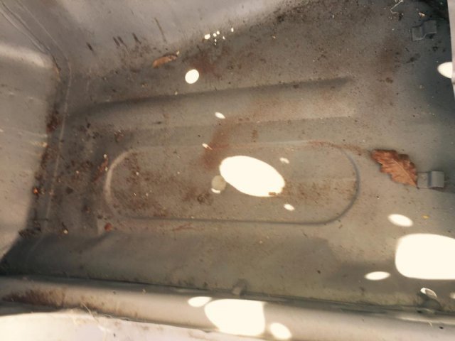

Overall, the floor pans and the frame rails are in FANTASTIC shape, in my opinion.
I then moved on to patching the holes with seam sealer, though some of the bigger ones I welded over with metal pieces and then seam sealed.
After I got done patching, I went ahead and painted the bare metal with a chassis saver. That shit is strong and stayed on me for about three weeks!
I continued on to the rear of the car as well. Taking undercoating off is a LONG process; not too mention a very DIRTY process.

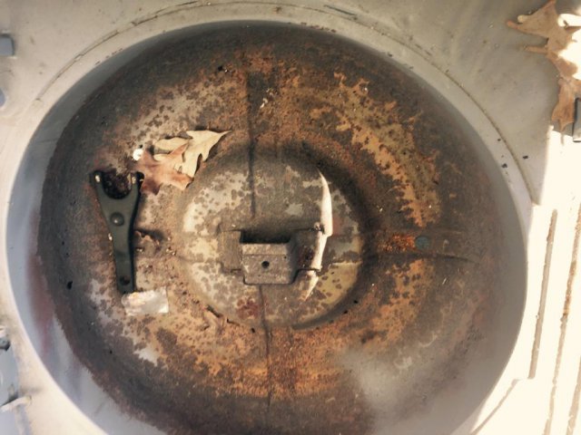

I also cut out the spare tire well. This is eventually going to have a fuel cell in it. I am not 100% certain how I am going to do it yet. I will likely inset the
cell into a piece of metal and have the top of the cell be flush with the floor. I also cut this out with the intention of making room for dual exhaust down the road.

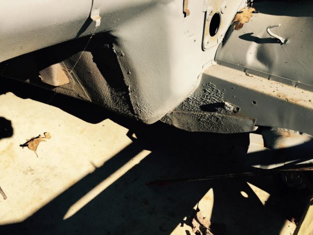

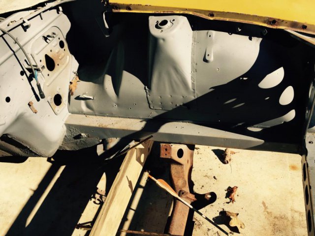

I got my new frame rails in from Bad Dog Parts. I am unsure about them. They seem to be built with good material, but I am unsure of the fit. As you see in the pictures, I will have to trim here and there to make them work, no big deal. My major concern is the front section of the front frame rail. I would have thought that it was supposed to be flush with the top of the original rail. Anyone have thoughts on this? Also, I think I am gonna have to straighten out my originals as well as bit. You'll see in the other picture that the original rail does not meet with the bad dog rail. I am thinking that someone used the rail at some point to jack the car up! Thanks for that.
More to follow as I start getting these rails put in. I am going to spend tomorrow and friday pulling out my LS6 from the Z28 that it is in. My buddy was driving (thrashing it) it yesterday around the block and he broke the cars driveshaft! She's got some torque! Makes me glad that I am reinforcing the rails, and doing a roll bar/cage of some sort in the future. I was originally thinking about going with a 4 point, but I am not thinking about doing a 6 point. Are there any recommendations for bars out there? I dont have equipment to bend pipe and make my own.
Here is the angle I was talking about. I feel like it should be taller?
Hammering required!
Back frame rail; needs to be trimmed likely.
Big picture.
