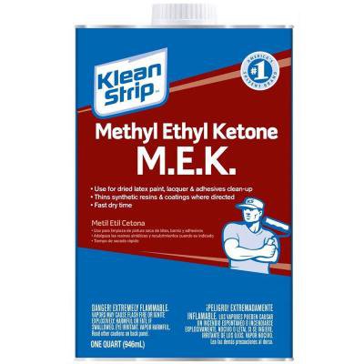

tamo3 Posted January 20, 2016 Share Posted January 20, 2016 I found video on YouTube about Methyl Ethyl Ketone to clean up Carb. Does any one have experience using this chemical? http://www.homedepot.com/p/Klean-Strip-32-oz-Methyl-Ethyl-Ketone-MEK-Solvent-QME71/100210976 References: http://www.bobistheoilguy.com/forums/ubbthreads.php?ubb=showflat&Number=1700686 http://classicbroncos.com/forums/showthread.php?t=189219 Quote Link to comment Share on other sites More sharing options...
seattlejester Posted January 20, 2016 Share Posted January 20, 2016 Glad I retained some of my chemistry, I was thinking Methyl Ethyl Ketone before clicking. It is a pretty powerful solvent. Organic compound, C4H8O. It does contain a ketone which can react to certain compounds and loose the double bond, potentially why it makes such a good solvent. Chemically it is flammable so keep away from open flames and be careful scraping an item covered in the stuff with a steel or spark inducing brush. It is also a minor irritant so make sure to wear chemically resistant gloves and make sure to be in an open space, a respirator may be overkill, but wouldn't hurt. It is present in a lot of everyday items, so it shouldn't be as harmful, but granted it is organic and reactive so it can turn into something more harmful etc so take modest precaution. In chemistry like dissolves like. So given that it is organic it will readily dissolve things of organic nature like hydrocarbon residues and such found on parts like carburetors. Keep it away from plastics as it will also dissolve certain plastics and can even fuse them. Keep it in a clean metal or glass container with a tight lid as it is also volatile and can escape and can potentially cause a hazardous situation with sparks or flames. Quote Link to comment Share on other sites More sharing options...
Derek Posted January 20, 2016 Share Posted January 20, 2016 I use it a bit and it's rugged. It will melt through nitrile gloves with a quickness. Use good ventilation. Quote Link to comment Share on other sites More sharing options...
johnc Posted January 20, 2016 Share Posted January 20, 2016 Works very well but some people (me) have reactions to it if a lot is inhaled at once. Acetone is a safer solvent. Quote Link to comment Share on other sites More sharing options...
