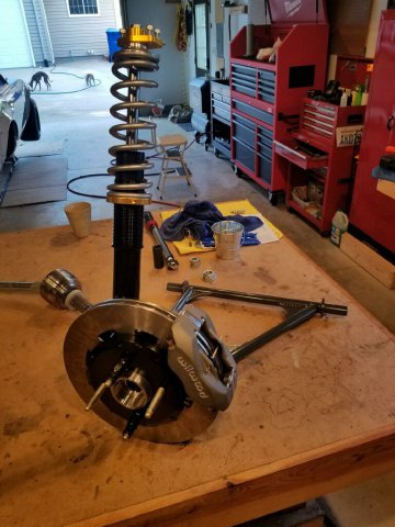

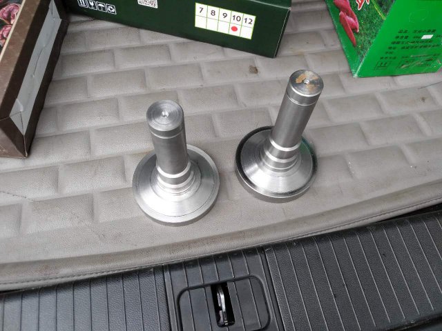

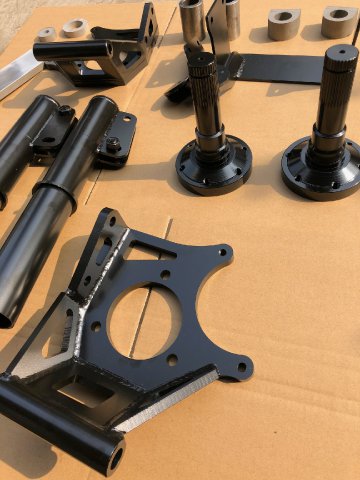

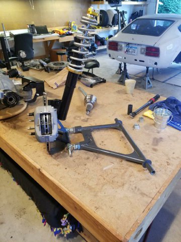

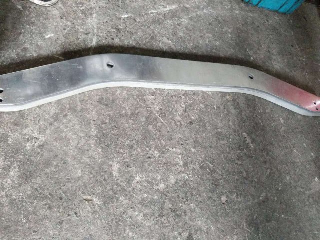

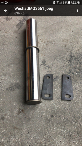

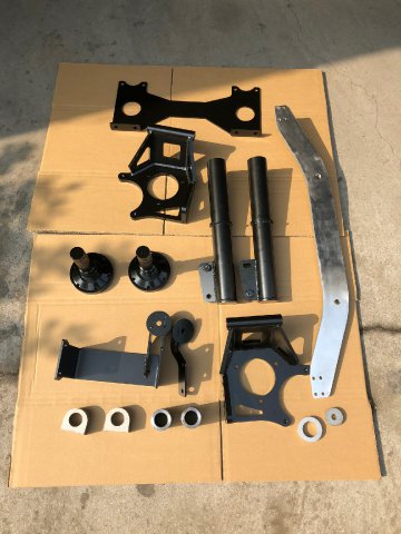

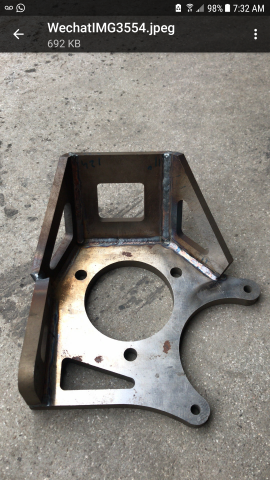

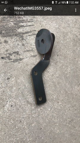

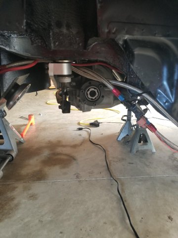

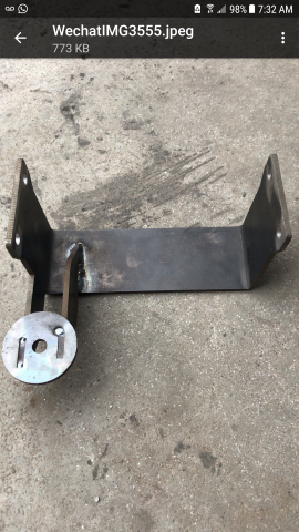

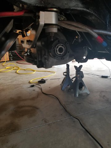

Silver Mine Motors Posted April 23, 2018 Share Posted April 23, 2018 Hey guys I've been working on an 8.8 kit for the past 2 years. All same parts as Wills kit. We are going to be installing the first prototype in 1-2 months. Just letting you know, see pics of our progress. We plan to sell this kit on our website silverminemotors.com after we finish testing. Quote Link to comment Share on other sites More sharing options...
DeathByNissan55 Posted April 23, 2018 Share Posted April 23, 2018 What's pricing going to look like and and what hubs/struts are you using, and what brakes? Quote Link to comment Share on other sites More sharing options...

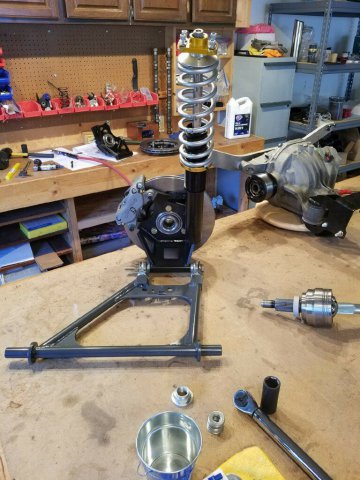

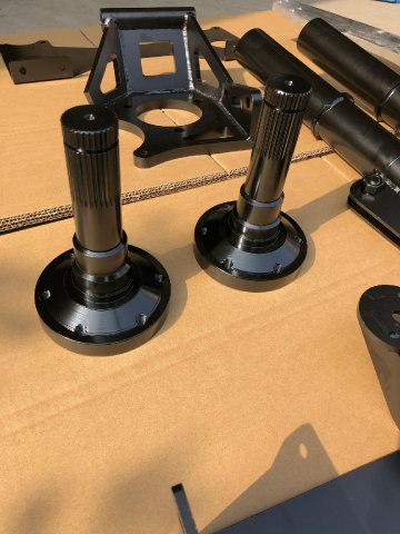

Silver Mine Motors Posted July 25, 2018 Share Posted July 25, 2018 I'm still working on this. It's a slow process. Update: We have installed all the parts and it all fits perfect. I can't buy a gland nut, so we are going to make a custom gland nut. Then we can actually test drive the car/ rear end kit. Here's a few pics of what we have so far. I have no time estimate. Or price, but my goal is to make the price lower than any other similar kit. Quote Link to comment Share on other sites More sharing options...
