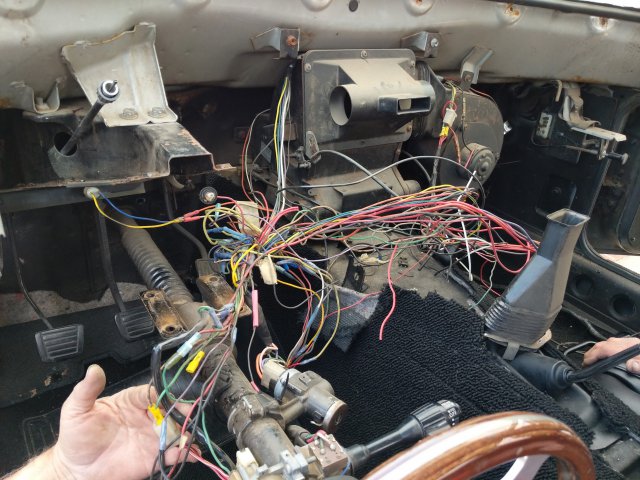

nmehdikh Posted December 29, 2017 Share Posted December 29, 2017 Car is a 1973 240z with an L26 basket case, with lots of rust and wiring issues. Since my initial question thread started getting offtopic, I figured I would finally start a build thread to expand on my questions, and document my progress so far with the car. Original thread is found HERE Parts are on order and I'm slowly putting together my EFI / ITB setup. I'll post updates and questions here. Since the start of that thread, I've really dug into the car to find terrible rust as expected. So, first order of business was replacing the floors and flame rails. Got floors from zedfindings and rails from baddog. Passenger side before paint. Driver side painted. You can see the rats nest of wiring hanging under the dash. Going to have to clean this all up pretty soon. My car didn't have seatbelts when I bought it, so I also put in a half cage and harnesses. Cage was built and welded in by a local shop. My seats currently sit too high for my liking (and for the harnesses), so I'm either going to get new seats or a build a smaller seat bracket. Also replaced redid the entire braking system with 4 piston discs in the front, converted the rear to disks, and a new master cylinder. I've also replaced most of the suspension bushings, still have a few to do. This weekend I am going to pull the head off to get it rebuilt. Which leads me to my first set of questions. I thought the car just had a stock L26 in it. But now I'm not too sure so I need some help identifying stuff and how to move forward. The block is stamped "L26 086142" and the head is stamped "N42". I previously did a valve adjustment, and I remember checking the cam markings and it had standard mark but now that I realize it has a N42, I'm not sure if it hasn't been reground. There is a isky racing cams sticker on the car window, but who knows if that is just for "show". When I pull the head off, how do I go about identifying the cam? And if it has been reground? How do I check if the head has been shaved? What should I look for inside the motor (should I expect flat top pistons? Or dished? or notched?)? Given that I am going megasquirt EFI with ITBs, what should I have done for the head performance wise? Valve springs? Cam suggestions? Quote Link to comment Share on other sites More sharing options...

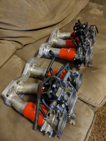

nmehdikh Posted January 5, 2018 Author Share Posted January 5, 2018 On 1/4/2018 at 7:03 AM, bradyzq said: Your seats are awesome, but for track duty, these days having a provision for a HANS device is becoming a no brainer. Second set of seats, maybe? The seats were in the car when I bought it, and I agree. While they look great and are very comfortable for street driving, I am definitely going to get a dedicated track seat before taking the car out. I had some free time today so I started CAD-ing up the tubing connections between the intake flange I have and the ITBs. Unfortunately, due to the spacing of the triumph ITBs and the spacing of the intake ports, its damn near impossible to get equal length runners. I need to go talk to some local aluminum tube bending companies and get their input on what's the best way to go about this. Quote Link to comment Share on other sites More sharing options...
ol doc gully Posted January 13, 2018 Share Posted January 13, 2018 I would think it’d be really tough to be that precise, with such small offsets, enough that may be worth it to just use two flanges and some straight pipe, maybe with a lil pie cutting? Quote Link to comment Share on other sites More sharing options...
nmehdikh Posted January 14, 2018 Author Share Posted January 14, 2018 You are right about it not needing to be that precise. I CAD-ed them up so I could figure out the spacing of the two sets of ITBs relative to each other, while minimizing the offset of each individual runner. It was to give me a starting point before I start fabbing up the pipework by hand. Got the gas tank out today. Going to clean it out and make sure all the fumes are out before I cut it open next weekend to install the new fuel pump. New camshaft / head parts should be here Tuesday, then I can take the head in to be rebuilt. Quote Link to comment Share on other sites More sharing options...

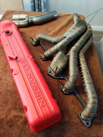

nmehdikh Posted January 21, 2018 Author Share Posted January 21, 2018 I had bought a new set of headers from top end performance, I took them in to be ceramic coated, and got the valve cover redone as well. Finished wrapping the header yesterday afternoon. Need to get proper metal ties for the header wrap. Also pulled the dash today to start on the wiring and vintage air setup. Long road ahead dealing with this rat's nest from the previous owner. Quote Link to comment Share on other sites More sharing options...

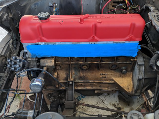

nmehdikh Posted January 30, 2018 Author Share Posted January 30, 2018 Got the head back on this past weekend. And just picked up the intake manifold from the welders. Next weekend should be test fitting some things and working more on the fuel system and wiring. Quote Link to comment Share on other sites More sharing options...

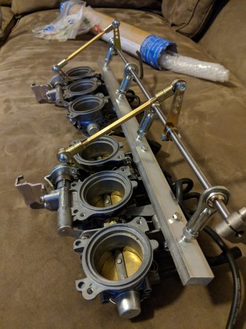

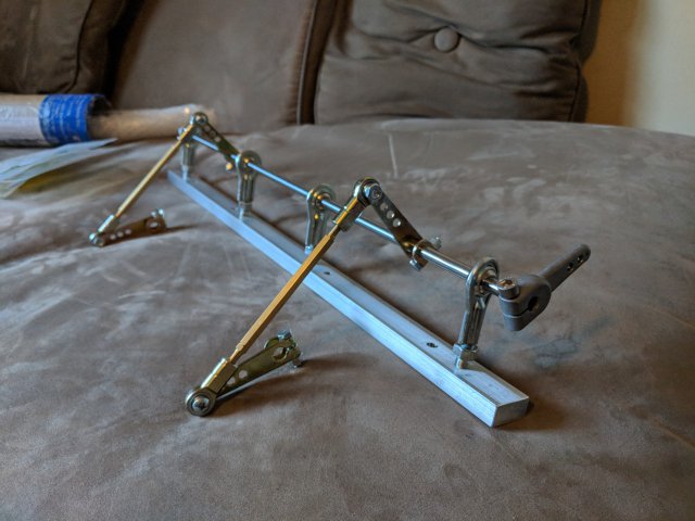

nmehdikh Posted February 3, 2018 Author Share Posted February 3, 2018 I spent this afternoon in the machine shop making a mount that would let me use existing holes in the triumph throttle bodies. Off of this mount I setup my throttle linkages and idler rod. Here is everything setup with a loose test fit. I still need to work on the sides of the droplink that connect to the triumph cable pull location. Quote Link to comment Share on other sites More sharing options...
