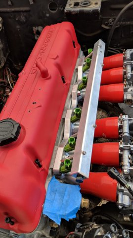

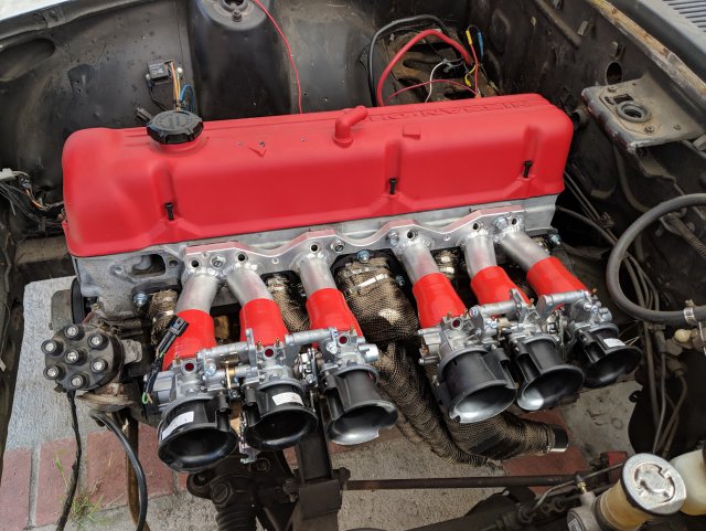

rossman Posted February 3, 2018 Share Posted February 3, 2018 Is that silicone hose you are using to mount your ITBs to the manifold? I'm pretty sure fuel will break down the silicone. Quote Link to comment Share on other sites More sharing options...
nmehdikh Posted February 3, 2018 Author Share Posted February 3, 2018 On 2/3/2018 at 1:02 PM, rossman said: Is that silicone hose you are using to mount your ITBs to the manifold? I'm pretty sure fuel will break down the silicone. Expand Yes, its silicone hose, but the fuel injectors are down the line past the hoses and on the manifold flange. Do you think it would still cause problems? Worst case I can always weld it up, the hoses were about $20. Quote Link to comment Share on other sites More sharing options...
rossman Posted February 3, 2018 Share Posted February 3, 2018 Ah, I thought the holes in the throttle bodies we're injector holes. It may be ok then. The will still see some fuel so you might want to check them periodically. Quote Link to comment Share on other sites More sharing options...

nmehdikh Posted February 18, 2018 Author Share Posted February 18, 2018 Thanks for the info guys. I appreciate it. This weekend is pretty busy for me so I didn't have much time to work on the car. In the meantime, I finalized the header and intake install and they are on for good. I had to wait for a new gasket that arrived a couple days ago. I also got the thermostat housing on, and the fuel rail and injectors. The throttle bodies are still only on there temporarily. Quote Link to comment Share on other sites More sharing options...

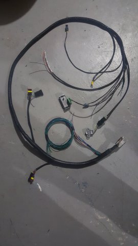

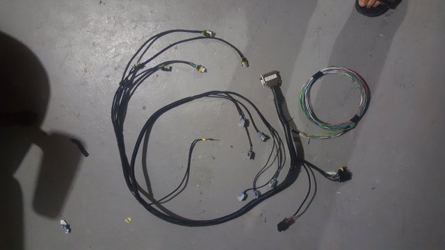

nmehdikh Posted February 22, 2018 Author Share Posted February 22, 2018 While I've been doing all this work on the car, I've been in contact with Softopz, and he's been making me a megasquirt harness for my needs. He recently sent me work in progress pics, and has been great to deal with. I'd highly recommend him if you are interested in going the megasquirt route. Here is a link to his thread where he sells harnesses. Quote Link to comment Share on other sites More sharing options...

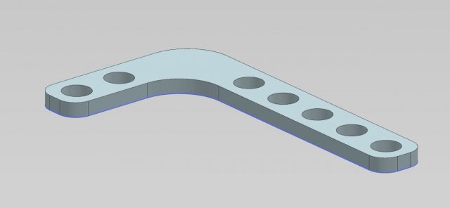

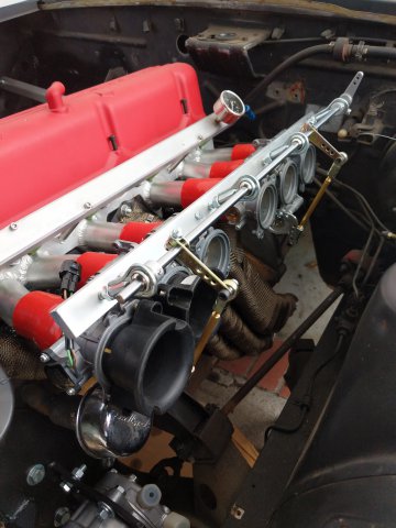

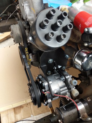

nmehdikh Posted April 8, 2018 Author Share Posted April 8, 2018 I've been traveling for work the past few weeks so I haven't been able to get much done. But this weekend has been pretty productive. Got the distributor swapped over to the turbo distributor to give me crank angle and cam position. Got the AC compressor mounted as well. I had to CAD up and mill out a little bracket to adapt the throttle linkage to the factory triumph cable pull. Here is the completed linkage and a crappy vertical video Quote Link to comment Share on other sites More sharing options...
