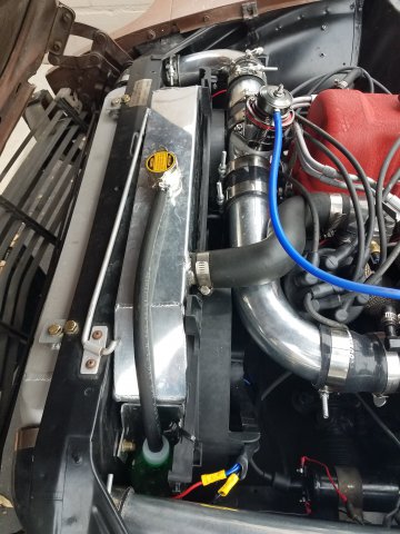

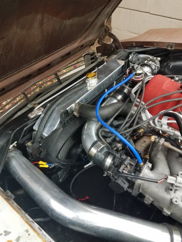

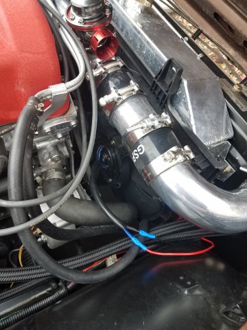

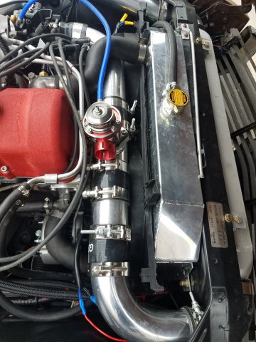

supershanesta Posted February 9, 2018 Author Share Posted February 9, 2018 (edited) After putting in the Altima Fan things are going fine. I had to cut a lot of it to fit as its wide and also to thick for the turbo piping I have at the top. It almost hits the radiator outlet to the water pump. I had to cut the radiator hose shorter so that It would move and successfully fit. My radiator is 25" across if I remember. I think the stock ones are 26". It works like a dream. I have it hooked up to my megasquirt via a relay. It kicks on at 180 and cools down to 170 in seconds. My heating problem is all solved. If I was to do it again I would try a fan and shroud built for the car as this was more work than I wanted and I had to redo some turbo piping to get it to fit which cost $. Shitty but Effective. If anyone is interested its from a 2001 nissan altima. I will do more testing and get back to you guys as I have a new 160 thermostat (i drilled holes in my last one), but not seeing overheating at all. Thanks everyone. Edited February 9, 2018 by supershanesta Quote Link to comment Share on other sites More sharing options...
nmehdikh Posted February 10, 2018 Share Posted February 10, 2018 (edited) How did you wire up the altima fans exactly? I recall they are a 4 wire plug due to high / low speed settings right? Are you just running high all the time? And how tight is the fan against the motor? How's the clearance for the pulleys and belts? Edited February 10, 2018 by nmehdikh Quote Link to comment Share on other sites More sharing options...
supershanesta Posted February 10, 2018 Author Share Posted February 10, 2018 They are set to high. I cut the connectors off. 2 blacks 2 blues for each connector. Using both they go on high. I cut about a half inch off the back of the shroud to clear my piping and water outlet. Note that my radiator is thicker than stock.Pully is in between both fans with no issue. I have the one with 3 belt options so it sticks out. With an ac compressor or other belts it might be close i dont know. I can take pictures after this weekend of specific areas of concern if your interested. Quote Link to comment Share on other sites More sharing options...
