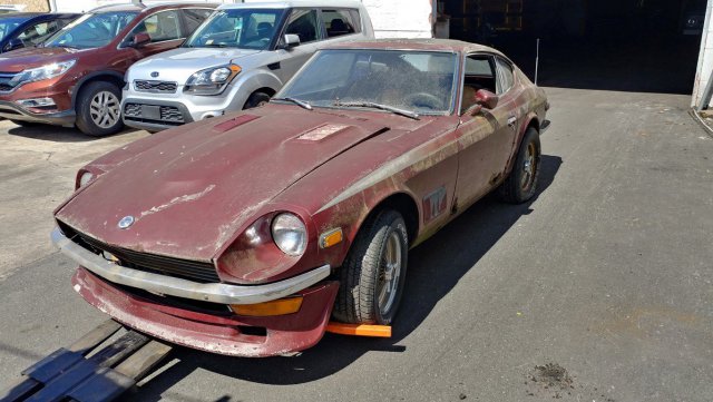

I haven' t really been in to any type of vehicle until i stumbled on a picture of this car a couple of years back. I was immediately in love, i knew i needed to have one.  Fast forward to last autumn, i realise i have the possibility to actually buy one, so i start to scour the internet, both the European market and the american market. Europe was a bit too pricey for me as cars started at 6k euro and it was at least 1.5k to get it to Sweden. So i very soon looked towards USA where cars price start at like 500 dollars. I almost purchased a track day 240z from the west coast but backed out in the last minute, as I had to buy the car sight unseen, it was a bit price for what I got. So the search kept on going until spring 2018 when i stumbled on a 2/71' 240z, quite rusty as you will see, but it appealed to me somehow, so i won the bidding, and contacted a shipping company, and the car was on its way. The car landed in Gothenburg late May and i picked it up a few days later.

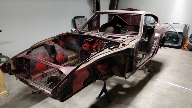

Now that i had my dream car there was a lot to do. I started with a cleaning it was long overdue. when the car was cleaner then it been in decades i didn't really find any new damage. Fast forward a couple of months, i bring the car from my parents place to my own garage and i have now teared down the whole car and i am doing rust repair.

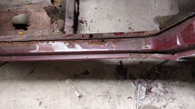

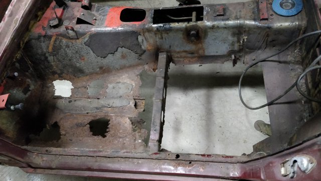

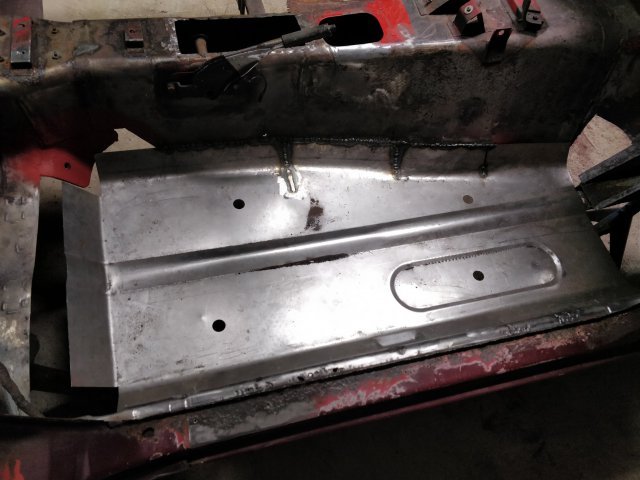

So the cars current state, i'm doing rust repair on the passenger side floor area, to get it ready for the new floor and frame rail, and slowly working away at the area below the hatch. Then there is the driver side floor area, battery tray area, rear wheel arches, some rust spots in the trunk but none in the spare-wheel arch. Other then that there is some more places but nothing mayor i have found yet.

This is the car in its current state.

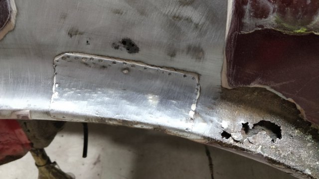

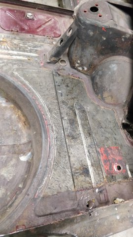

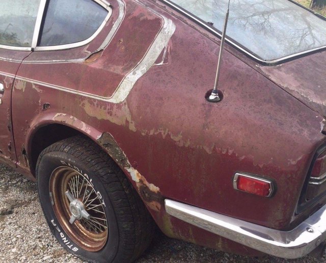

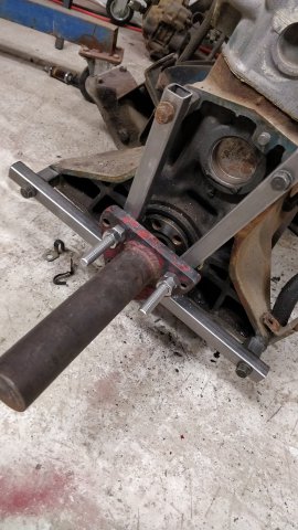

Did some more work today, mostly made a mount for the engine so i can hang it on my engine stand as it didn't have one when i bought it. Also found some repairs, under a ton of body filler. But i already have new sheet metal for the rear overfender area on both sides.
 793150416_2018-11-2516_02_41.thumb.jpg.3bdf6a90249e5c886a8273b69709f9ac.jpg1499551771_2018-11-2515_36_55.thumb.jpg.06c5335b144fb41a5155142a126cf0a4.jpg

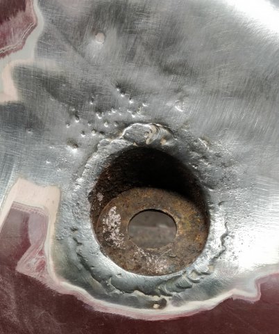

I was curious if the antenna hole looked like this from factory or if it's also a repair.

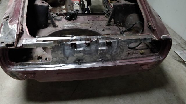

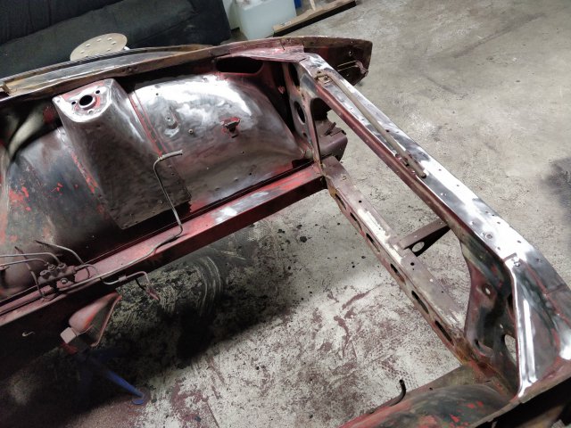

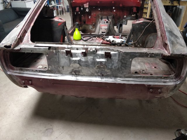

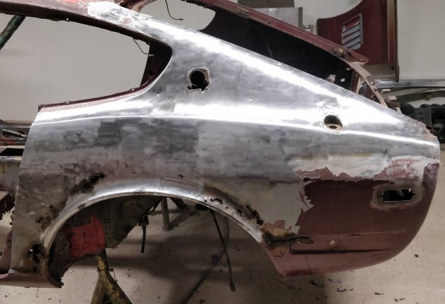

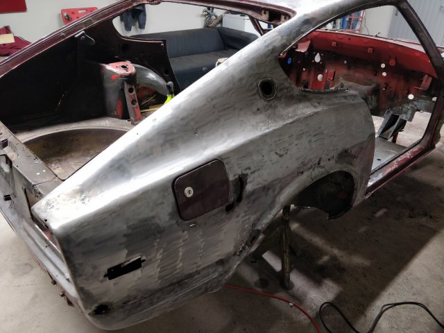

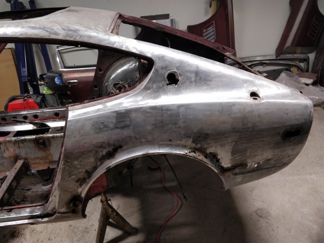

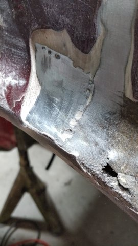

Today i did some work on the car, mostly paint removal, and removed the last of the sound deadening.
They had a lot of bondo on most of the quarter panel, but it came of quiet easy.
here is a before and after.

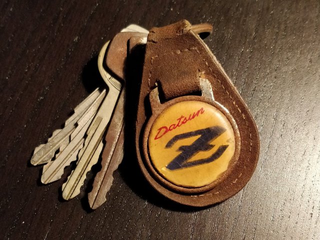

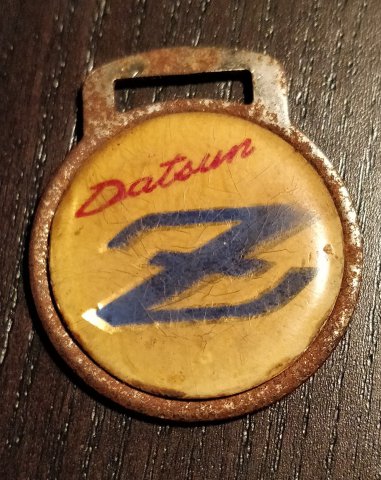

I also made a new piece of leather for the key tag, didn't turn out perfect, so might remake it at a later date.

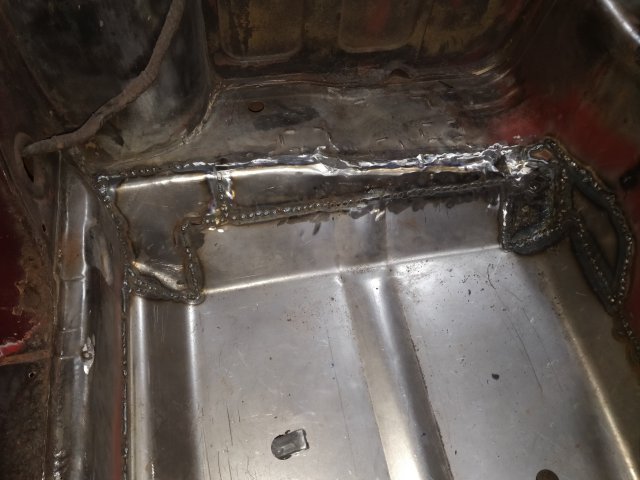

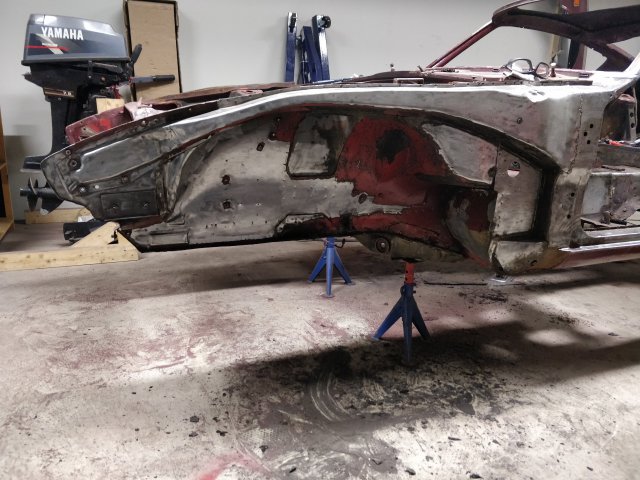

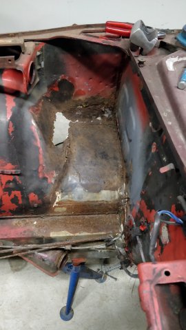

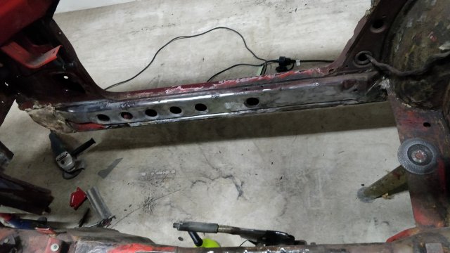

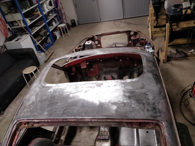

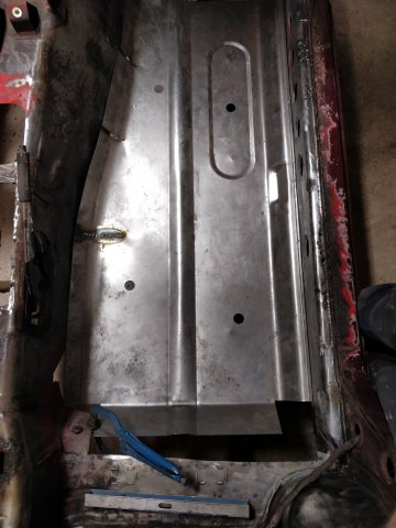

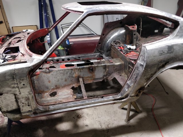

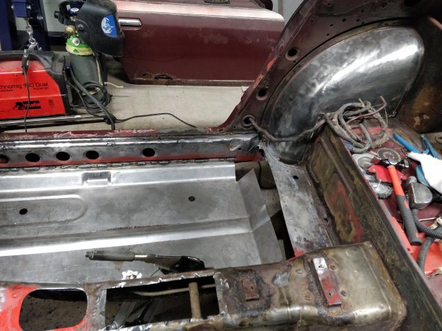

I have been in my garage a lot the the latest days, have striped most of the paint on the outside of the car and slowly started stripping bottom and inside, it's going slower as the are more complicated curves to deal with, also I fitted the passenger floor today, planning och welding it in tomorrow.
Edited by ubergumgum
Share this post

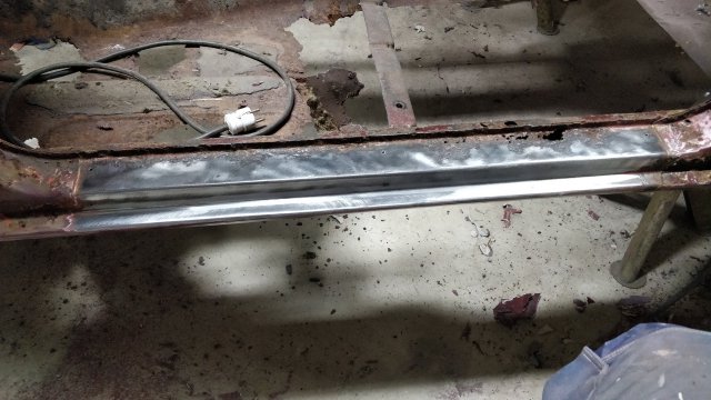

Work is slow but steady, almost finished with welding the rear of the passenger floor area. I also talked with a company about blasting the undersider, inside and engine bay to get them metal clean. they said about 300- 350 usd to do it. does it seem reasonable?
