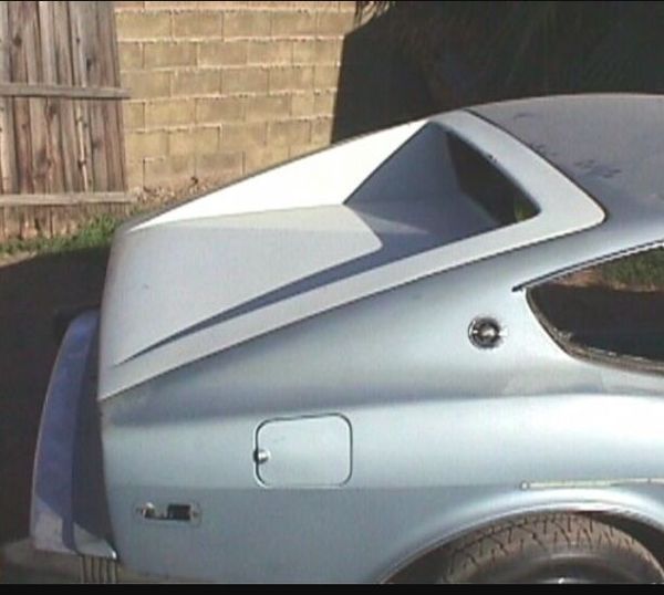

Looking around for aftermarket parts I like AND can legally install on a Z (for road use) in Germany I came across the "Pantera hatch" or "inverted hatch".
I know they're a bit polarizing, and apparently rather rare.

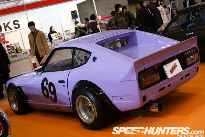

To those who don't know what I'm talking about, I'm talking about those things:
Can someone give me a little bit of information on those things?
Are there companies that sell them?
Or are they only to be found on the used market?
Or are they DIY-pieces made out of the conventional hatch?
I'm asking because the hatches slightly differ in some pictures.
Does/did anyone here run that part?
If so, where did you get it/who made it?

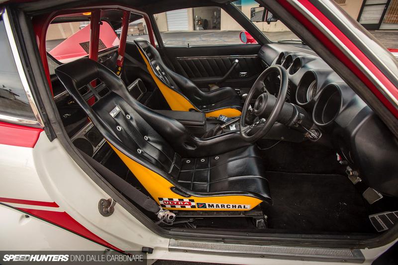

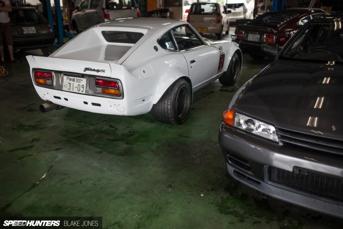

Also, in this picture it seems like the car has an inverted hatch and a roll bar, does anyone have any information/experience in combining that type of hatch with a roll bar/-cage?
Because I'd want the added safety, the law is probably going to require a bar/cage for stiffening, and since I got very little idea about how a car with an inverted hatch looks inside I wonder if it's possible to combine the two.

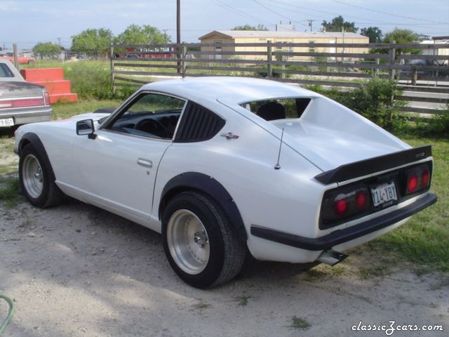

If you're planning any aero mods in the back skip it, as it creates massive flow separation and lift. If you check the windtunnel testing info in the FAQ, you can see it has the highest rear lift number of any of the tests. Makes me wonder what people are thinking when they put on the Pantera hatch and a spoiler or wing, or the worst combo, roof spoiler with Pantera hatch. It also increased the drag by .2 which is the equivalent of setting the wing that was tested for its highest angle of attack. So you get all the drag of pulling a wing through the air, and quite a bit less than none of the downforce.
If you are just in it for looks, it appears to me like there will be plenty of room for a roll bar. Most of us try to get the main hoop of a roll bar as close to the rear fenders as possible and as tight against the map light area as we can, that's still well forward of where the hatch is though.

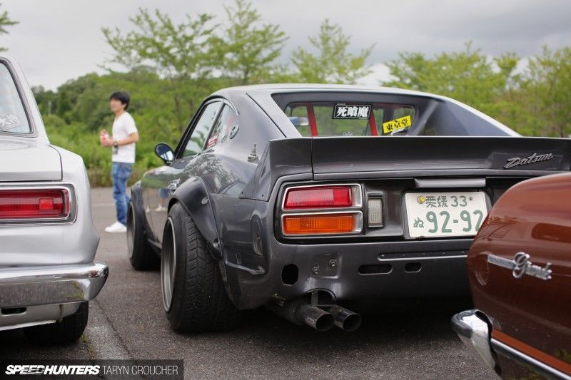

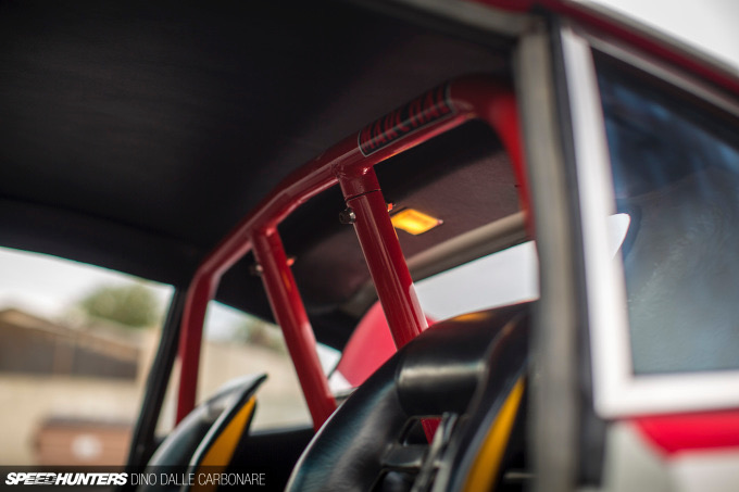

I found an article on Speedhunters on a 240 running an inverted hatch (“Airone R-Gate”) and a roll bar.
Might just be a style bar, but it looks like there’s enough space for a bar and slightly angled supports behind the buckets in this version of the hatch, from where one could extend to the front as a cage.
The rear domes (ideal points to mount to) might be too far back though.

Just put the supports off of the hoop on the sides, they'll fit in around the hatch window. Mine go from the sides of the hoop just below the bends to the top of the strut towers. That one shown above is terrible. If there is a fore/aft load on the main hoop if the car rolls, there is almost no support for it. Would fold like a mousetrap.

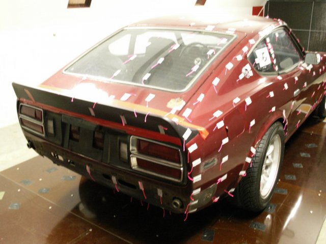

Perusing the data from that 2007 wind tunnel test, I'm baffled by the results for the Pantera hatch.   Intuition suggests that flow is already separated near the front lip of the stock hatch, and then continues as a set of oscillated separated rollers.  This is because the stock hatch angle was poorly chosen.  It’s too steep (pressure gradient too high) for attached flow, yet less efficient than a blunt (high angle), abrupt rear element… such as for example the back of a VW Rabbit.   The rationale for Pantera hatch is to get up on attached flow, instead taking the pressure-drag penalty on the rear windscreen, but hopefully getting flow reattachment further downstream over the hatch.  It is possible that this latter phenomenon wasn’t achieved in the wind tunnel test.
I’m not criticizing the wind tunnel test, but am pointing out that (1) the result was counterintuitive, (2) the drag increase from the Pantera hatch was still small, compared to the unrelated issue of what’s done at the radiator/nose/airdam, and (3) design-variations on the Pantera hatch are still possible, which may actually reduce drag, instead of increasing it.
By my reckoning, the benefit of a Pantera-style hatch isn’t a “hatch” at all, but a fixed lid over the trunk-area, merging into a fixed rear glass (or plexiglass).  The benefit is (1) save weight, and (2) isolate the cabin from the fuel-cell and battery (assuming a trunk-mounted battery).  If there is aerodynamic benefit, then that’s a bonus, rather than a main objective.
Share this post
The rear hatch is relatively steep, but you don't have a chance in hell of getting the flow to reattach with a Pantera hatch. Yes, an abrupt surface can be used to decrease the overall area of unattached flow, but that's done by reducing the closeout angle and then abruptly changing slope. You aren't doing that when you add a Pantera hatch. You're taking the same slope that isn't ideal and then making it worse. It makes perfect sense to me and isn't counter-intuitive at all.
Share this post
Agree with calZ. I'd like to see some better shots of the yarn on the stock hatch. I would bet that the separation is not that bad; that there is separation, and it is creating drag, but not in a huge way. If you look at the VG test from the windtunnel, it actually shows an INCREASE in rear lift. Unfortunately they also took the side skirts off when they did this test, so it's not really a good indication of what exactly the VGs did. All we can really say is that the net change of removing side skirts and adding VGs resulted in increased rear lift and increase in drag by .04.

We do have this shot, but there is a spoiler on the car. Even so, there isn't any yarn pointing backwards or standing straight up.

You're mistaken on this. The yarn lays nicely on the surface inside attached flow because the smooth airflow is pulling it backwards. When flow is separated, it swirls, pulling the yarn every which way. Here's a lift curve for a couple NACA airfoils and a flat plate.
