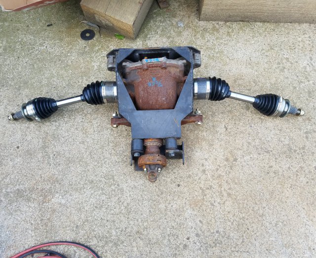

Invincibleextremes Posted March 25, 2019 Share Posted March 25, 2019 Its compatible... no matter what route you go, ditching the stub axles would be a good move. You can find whatever info you like on the super 8.8 swap I'm doing in its own thread so I'm not going to talk about that here. An option is to stick with the r200 and replace the outer uprights with either a techno toy tuning upright or one of your own design, or buy one from someone else. If using the t3 ones for example, you can rock 4 lug 240sx hubs and brakes and just figure out how exactly you're going to connect that cv joint to an inner that works with the r200... either via the 300zx axles and a hybrid 240sx shaft or maybe some porsche 930 race axle setup and finding off the shelf stubs for that application etc. 600 to 700 hp is up there however and hybrid 4 cyl car cv axles may not hold up very long. But the options are out there. Wilwood hubs used by race teams often use a tie wire method to keep things from coming apart.... so if dead set on using DSS axles maybe something like that is an option? Quote Link to comment Share on other sites More sharing options...

Invincibleextremes Posted March 26, 2019 Share Posted March 26, 2019 Thats literally what several different people are doing. Just not worth dealing with the factory stubs. Quote Link to comment Share on other sites More sharing options...
