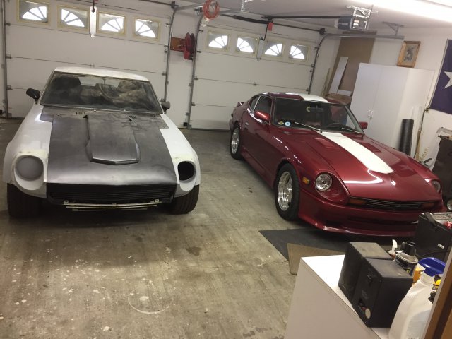

Phantom Posted July 16, 2019 Share Posted July 16, 2019 The Broken Kitty (JCI) kit was developed on my car back in 2002/3. I have been driving the car for 16 years and about 45,000 miles and have had 0 issues with any of the JCI components. They may not be as sexy as some of the other kits but they are time proven. They also mount the LS motor in the ideal location for the T56 shifter to come up through the stock hole on an S30. I think it is also the most complete source of components. Engine and transmission mounts, driveshaft, radiator, tach conversion, AC compressor if you want one, and fuel pump. All the components were engineered to work together and to be relatively easy to install. The red 280Z is the car that JCI developed their components on. The gray 240Z is the car that Grenade300 did his photo how to thread for the JCI components. It is now owned by my son, DarthZ. Quote Link to comment Share on other sites More sharing options...
