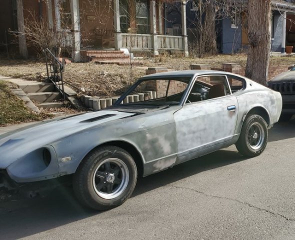

Honestly, today went so well, that I decided to drive the car. For the first time in 3 years, it was on the road. The engine sounded strong and healthy, yet smooth. I even managed to capture a shot with my daily and other side project. I feel totally reinvigorated after today. Thanks everyone whos helped!
