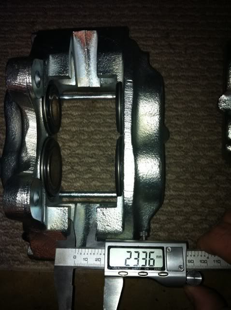

mitx Posted January 28, 2012 Share Posted January 28, 2012 Hi, I've been inspired by this thread to improve the front brakes of my 240z. I bought rebuilt toyota S12+8 calliper that are supposed to be for the toyota 20mm thick vented rotors (it's the toyota ref 47750-60021 for 1981 to 1989 J6 landcruiser). I think I may have received the wrong type of calliper from the seller because the width between the two parts of the calliper is 20mm, and I can't fit the 22mm thick vented rotor in it. Here is a picture of the width I am talking about in case I am not clear (it's not the picture of the actual calliper but one taken from post#6). Can anyone tell me if it is the S12+8 vented or S12+8 solid? What is this width for solid and for vented rotors? Do I have to machine the S12+8 vented to let the rotor get in the calliper? Link to comment Share on other sites More sharing options...
mitx Posted January 29, 2012 Share Posted January 29, 2012 I found my answer on this thread from viczcar: http://www.viczcar.com/forum/index.php?topic=9932.0 The width for vented rotor should be 23mm so It means I received the wrong callipers. I'll have to ask the seller for the good ones. Link to comment Share on other sites More sharing options...

mitx Posted January 30, 2012 Share Posted January 30, 2012 So to summarize, the gap for: 'vented' S12+8 calliper is 23mm 'solid' S12+8 calliper is 15mm and mine are 20mm -> What's the problem with mine? I suppose they machined it too much during rebuild. Is this possible? What do you think? Could there be a third version of this calliper? Link to comment Share on other sites More sharing options...

DuoWing Posted April 6, 2012 Share Posted April 6, 2012 I haven't read this thread in entirety so I don't know if it was mentioned, but could you technically take the S12+8 Toyota Calipers meant for the solid rotors, grind out that gap and fit the larger vented rotors? Unfortunately I purchased the earlier ones for the solid rotors before I saw this thread. Link to comment Share on other sites More sharing options...
mitx Posted April 6, 2012 Share Posted April 6, 2012 I haven't read this thread in entirety so I don't know if it was mentioned, but could you technically take the S12+8 Toyota Calipers meant for the solid rotors, grind out that gap and fit the larger vented rotors? Unfortunately I purchased the earlier ones for the solid rotors before I saw this thread. No you can't, you would have to grind about 10mm on one side of the calliper gap, your grind would end to be assymetric because it is currently centered for the solid disc, you would also need extremely thin brake pad on this same side to do this, , so a normal pad on one side and . You should better sell those callipers and buy the proper one, it's the simplest solution. Or if you really want to modify these callipers, you could split the calliper in two and add a custom made spacer in between the two parts of the calliper to get the right gap for the disc. Link to comment Share on other sites More sharing options...
