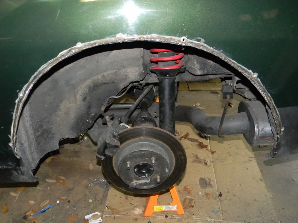

wigenOut-S30 Posted May 14, 2010 Share Posted May 14, 2010 Ok Done with my flares.. First off Austin is right.. this is not for the faint at heart lol. It did take me around 12-13 total hours and the rears are not fun. but the finished product looks SOOO GOOOD!!! Before.. ZG flares the moch up.. Time to start cutting And done! Link to comment Share on other sites More sharing options...

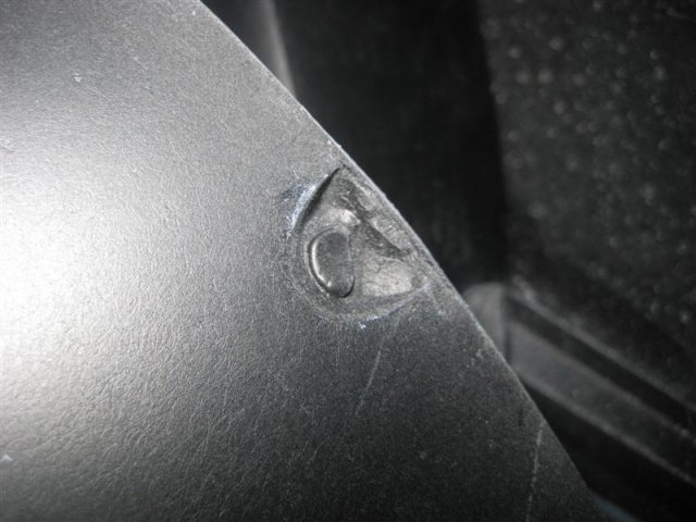

stan401 Posted May 20, 2010 Share Posted May 20, 2010 i bought my flairs from msa, im about to mount them saturday so i have checked this post over and over again but i whould like to see a close up of the ZG mounted to see what bolting you all have use looks like a round head one with the square hole for a screw driver? any washers? ps: if there was an answer on the post im realy sorry about reposting the question i didnt understood what you all use (im french) so a picture close up realy mean a 1000 words for me. Many Thanks =Matt= Link to comment Share on other sites More sharing options...
wigenOut-S30 Posted June 7, 2010 Share Posted June 7, 2010 i bought my flairs from msa, im about to mount them saturday so i have checked this post over and over again but i whould like to see a close up of the ZG mounted to see what bolting you all have use looks like a round head one with the square hole for a screw driver? any washers? ps: if there was an answer on the post im realy sorry about reposting the question i didnt understood what you all use (im french) so a picture close up realy mean a 1000 words for me. Many Thanks =Matt= here is what austin said from his very first post. he also sells the hardware kit and includes everything. Welting, bolts, nuts for the front, washers and nutserts for the rears. Materials: - 24 -Allen button head bolts (I used stainless 1/4") - 24 -AN SS washers - 12 - 1/4" Nut inserts - 12 - SS 1/4" nuts washers and lock washers - Rubber welting - Stain black spray paint - Seam sealer and undercoating - 3M BLUE painters tape Quick google search for the Allen button head bolts and these look exactly like the ones I got form autsin. I hope this info helped ya out.. Link to comment Share on other sites More sharing options...

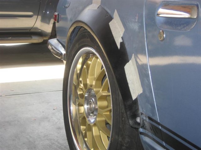

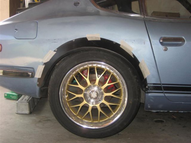

padam07 Posted March 9, 2011 Share Posted March 9, 2011 I just thought I would give my 2 cents here. I purchased a set of MSA flares about a year ago and finally after purchasing the Rotas from the group by a couple months ago I am ready to tackle this installation. I started to dry fit the flares and I am not happy with the fitment at all. As noted within the thread the front flares are different length. I also don't like how they form to the body. I did notice that people were saying tha tthe classic datsun flares are a lot better for fitment. I decided to call MSA and see if I can return them. Even after a year they gave me a RMA with no questions asked. I will get a $200 credit (I will have no problem spending that:) I then called classic datsun and told him about my concerns with the MSA flares. He told me the entire story about how he used to supply MSA with the flares until they went behind his back and got their own molds made at the smae fiberglass fabrication shop that made his. Then he had problems with his parts getting mixed up with MSA parts. (shop mixed the molds) He told me with all honestly that he can't guarantee any different fitment than the current MSA flares. He told me what he would like to do is sand and fix a set perfectly and have new molds made. I was real happy with that and he said that it should only take a couple weeks. I I am waiting for my tax check before I have him pull the trigger. I will let everyone know with pictures how they come out. Sorry about the wall of text. Link to comment Share on other sites More sharing options...

deja Posted March 9, 2011 Share Posted March 9, 2011 (edited) Been there done that. MSA now offers a flare intended to be glued to the car. Most new cars use body adhesive to adhere nonstructural panels. I have no idea how good these MSA flares are. They didn't have those when I bought mine. So I widened the inside of the edge of the flares where they meet the car body to give me more area to add 3M 08116 panel adhesive. I still used the mounting screws with red loctite to add some stability. I then used fiberglass and Rage Gold to fill in the screw indents and the seam at the car body. How well this all holds up remains to be seen. The project just finished and I have only put on a few hundred miles, so far so good. Edited March 10, 2011 by deja Link to comment Share on other sites More sharing options...
