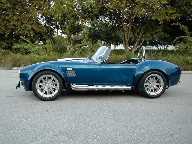

A few weeks ago somebody posted a pic of a yellow Z with a G-nose and Halibrand knock offs. This got me thinking that the Halibrand knock offs would be a way to get mucho rim for mini dollars. Having owned a Cobra (Factory Five Racing) in the past I knew were to start my search. Although my Cobra was fitted with 3 piece Compomotive wheels $$$ I know there are many similar brands and available that vary in price.
not my old cobra pic courtesy of team 3 wheels

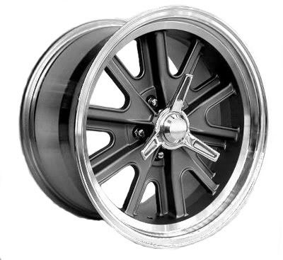

I could adapt but as I scrolled further down the page I found these!
I reviewed the site, they offered pricing, sizes, pictures and a phone number. I gave them a call just to make sure my eyes were not deceiving me. I spoke with a woman named Jin, very knowledgeable about the products. I told her what I was putting them (Datsun Z car) and she said hold on let me get Scott! Scott picked up the phone and it turns out he originally designed these wheels for the Datsun Z cars 10 YEARS AGO!!!! He has a 260 sitting somewhere in need of restoration but no time.
Sizes up to 17X11 with 3.5 to 8.5 backspacing!!! WOW!!!
Please visit their site and take a look at what they offer. Many sizes, offsets etc!!!

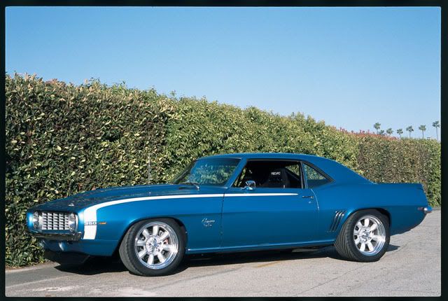

The rear wheel on that camaro is 11 inches wide but looks to have no lip? Is that because of the backspacing? Would that same wheel with 4.5 inch backspace (0 offset) have alot more lip? Im thinking it would.
The whole wheel is under the fender though. Each whell is custom made.
The Watanabes that 240Hoke and Villindi MS are running are 16x9 -13 offset fronts and 16x9.5 -19 offset rears. Hence the "lip" on their wheels. Negative offset is where you get the "lip". Of course to run this offset coil overs are needed and flairs are a nice touch too.
