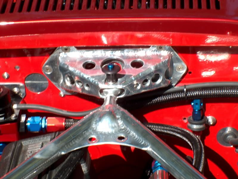

The major concern I have about doing something like John Coffey did with the mount in the center of the firewall is that the firewall really doesn't seem very sturdy.
That's funny because that firewall mount and the entire traingulated STB setup on my old car had some actual engineering via FEA software behind its design.
Did they engineer the mount with the software? I'm not questioning the mount... I'm questioning what it is mounted to.
I've stitched my firewall to the cowl box and I'm bringing this up because of the flex in the firewall that I was feeling while removing paint with a scouring pad. I mean if I can flex it by hand (all sections, not just right at the top or right in the middle), that makes me think that when the strut towers try to deflect the mount won't have a chance...
I used John C's pictures as a reference for my design...
as soon as I test fit the tubes.. I noticed that the tubes to the firewall did not cinch up tight at all... I could see the flex in the center firewall... Now that I have tied everything together it is MUCH STURDIER...
They built a simple FEA model of the car from the transmission mount forward including the suspension links. The model was used to develop the transmission mounting, STBs, radiator mount/front ARB reinforcement, and the brake MC bracket. Per the model (if I remember correctly) the loads on the center firewall STB mount are shared between the two bars and 20% of the loads are shear loads across the face of the firewall and 35% are tension loads from one STB pulling against the other. Less then half the load is compression.
