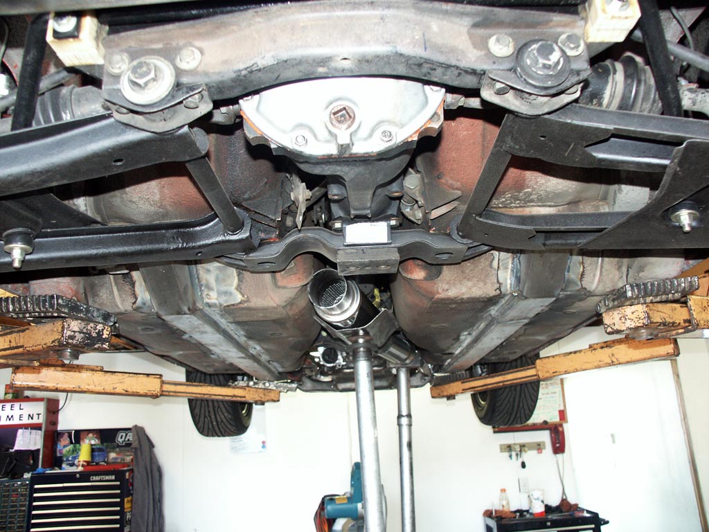

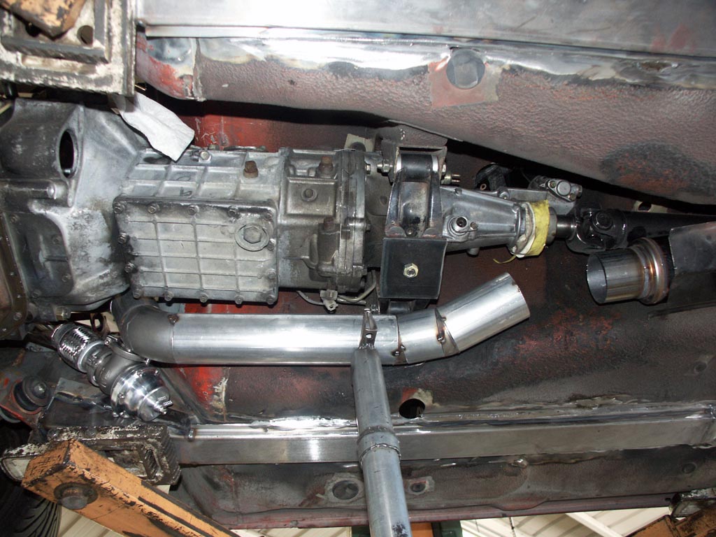

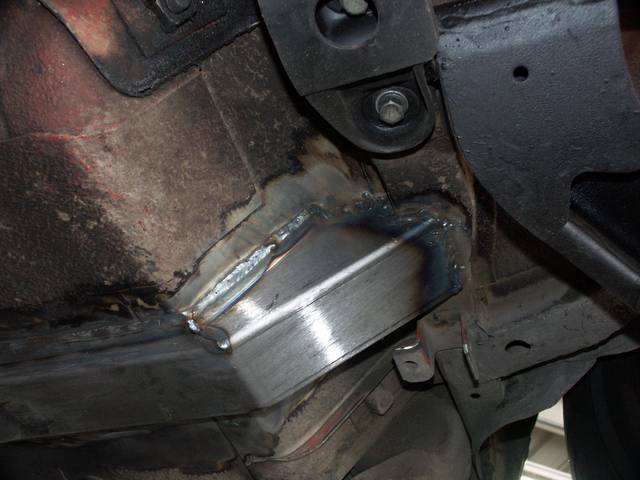

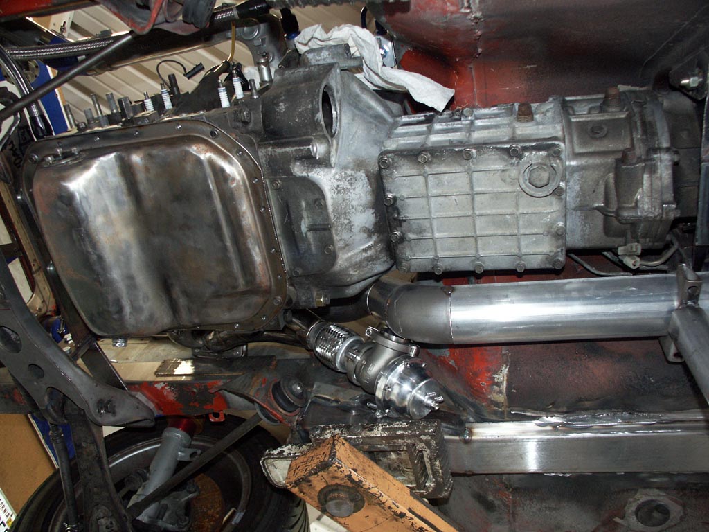

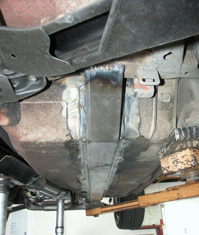

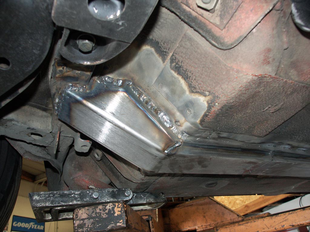

Bad Dog rails installed
Looks great, I think I might get a set for my car. Anybody know if the 240z rails baddog sells will fit over the 280z factory rails. It looks like the 280z rails they sell dont tie into the rear subframe?
Yes, the 240 rails should fit over the stockers. The 280 rails are stock replacements, what we're looking at here is the subframe connectors, not just stock replacements. I don't know if they make a 280 subframe connector.
Alex, it looks like a nice install, but the one issue I have is the full seam weld. It would actually be stronger if it were stitched in. Regardless, I'm sure it will be fine for your purposes and it looks like you found a shop that does good work.

There are others with more knowledge who can probably answer this better than I can, but here's what I've been told. The area immediately surrounding a weld gets very hot and becomes more brittle. As an experiment you can try welding two pieces of sheet metal together then bend them until they break. It won't break at the weld, it will break around it. When you seam weld a long part like this you end up with a brittle section all the way down the seam. If you stitch weld you end up with no one long seam that is brittle.

when you seam/stitch weld, you leave some play room for chassis flex that is necessary. Think of it this way... if you fully welded every frame component on a car, and took it to a track, you'd have cracks all over the place despite the car being very stiff.
jon's right about seam welding, and I should've asked the shop to stitch weld it, but as he said, it won't cause problems for me because my car won't be track only balls out racing every weekend. It won't see that much stress

Stitch or skip welding is mainly used to reduce heat input, warpage, cost, and time. A properly done full length weld will be stronger the a properly done stitch weld but its way overkill for a sheet metal structure. If done improperly it can lead to cracking as Jon mentioned above. The cost in time and consumables does not make up for the strength increase gained by doing a full weld.

When I installed my frame rails from Bad Dogs I used the stitch method, but also welded them up full on the outside and most of the way on the inside. I stitched welded because the metal was getting to hot and was warping if you went more than 2 inches at a time ... so I went back and forth from frame rail to frame rail to allow the metal time to settle between welds. I only stitch welded the inside cause I was having a hell of a time getting under my car on my jack stands. I just used some a boat load of silicon to seal up the frame rails and later went over it all in Por-15 then Herculiner Bed Liner ... the bottom of my car is quite rust proof now.
Also, be sure to jack up the car on the frame rail to make sure it is settled well. if you just weld it up free hanging with someone holding it and then raise the car on a lift it will warp the metal.
