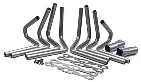

Administrators BRAAP Posted January 1, 2008 Administrators Share Posted January 1, 2008 Through my home stereo, these 180 degree headers give the dual plane crank V-8’s exhaust note a definite “braaaap†to its note, yet you can still make out the echoing coarse grumble of a domestic dual plane V-8. Compared to the exhaust of say a Ferrari V-8, (328, 348, 355, 360, F-40 etc,) the 180 degree headers take the domestic V-8 about half way to that pure Ferrari “braaaaap†exhaust note… that's how I hear it anyhow. You know guys, on a small Block Chevy powered S-30 Z car, there is room under the front of the oil pan to run cross pipes for a 180 degree header….. Speedway header kit, purchase a few more elbows.. http://www.speedwaymotors.com/p/3843,281_Speedway-Small-Block-Chevy-Header-Kits.html …and build it to look "similar" to this with the cross-overs under the forward section of the oil pan, in-front of the sump, (for SBC and SBF, the middle 2 cylinders of one bank need to communicate with the outer 2 cylinders of the other bank, not as this picture depicts.) Quote Link to comment Share on other sites More sharing options...
