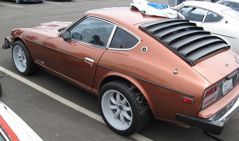

JustinOlson Posted October 1, 2008 Share Posted October 1, 2008 The 17X9 will not be flush with the fenders. You will need flares for that wheel. Here is a picture of the 17X9 on a stock fender car. I don't think you can pull and roll a fender enough to cover them. Quote Link to comment Share on other sites More sharing options...

WizardBlack Posted October 2, 2008 Share Posted October 2, 2008 In no way will the wheels fit without flares and get it to tuck. In no way are you gonna have that 9.0" in the front with a rolled lip and get it to tuck. Maybe with a different offset and coilovers, but that's a completely different wheel and not what you can get at with these group buy wheels. Quote Link to comment Share on other sites More sharing options...

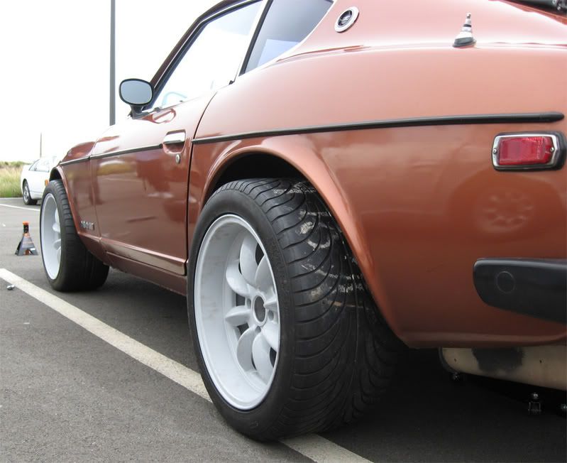

Bigdeezs Posted October 2, 2008 Share Posted October 2, 2008 When I was checking out the setups and fitment, I determined that 4.9" of BS would probably rub the spring perches, are you running copilovers or is it just really really close? Also at full lock I was anticipating issues unless a 205 or 215 was used. The rears should fit no problem as that is a very forgiving area. My 8.5s are very close to the stock springs but fit nicely...I had to do a lil hammering to the stock metal air dam so the tires wouldn't snag it when turning. The rubbing that goes on is only in the rear on heavy dips and corners and its rubbing on the outside edge of the tires. I think some 225s or 215s would solve that...maybe even another brand of tire. Steering effort is noticeably increased (as expected) BTW. Quote Link to comment Share on other sites More sharing options...

JustinOlson Posted October 6, 2008 Share Posted October 6, 2008 So what is the consensus of tire size that will fit under standard ZG flares? I'm doing 9.5" front and rear. Myron test fit his 255/40-17 w/ 9.5" up front and said it fit. Could I go to a 275/40-17 tire up front under standard zg's??? Could one of you guys with the 275/40-17 on the rear mount in on the front? I just want to see what I'm getting into before I buy tires and flares. 275/40-17 fit in the rear correct? Quote Link to comment Share on other sites More sharing options...
rudypoochris Posted October 7, 2008 Author Share Posted October 7, 2008 275/40-17 fit in the rear correct? This is correct, I do not know the answer to your other questions. RGM and Royal bronze are coming in this Wednesday. Quote Link to comment Share on other sites More sharing options...
jeffer949 Posted October 7, 2008 Share Posted October 7, 2008 Justin I would say that the 275's would fit up front. the front flares arent filled all the way up like the rears are. But you might run into rubbing issues Quote Link to comment Share on other sites More sharing options...
